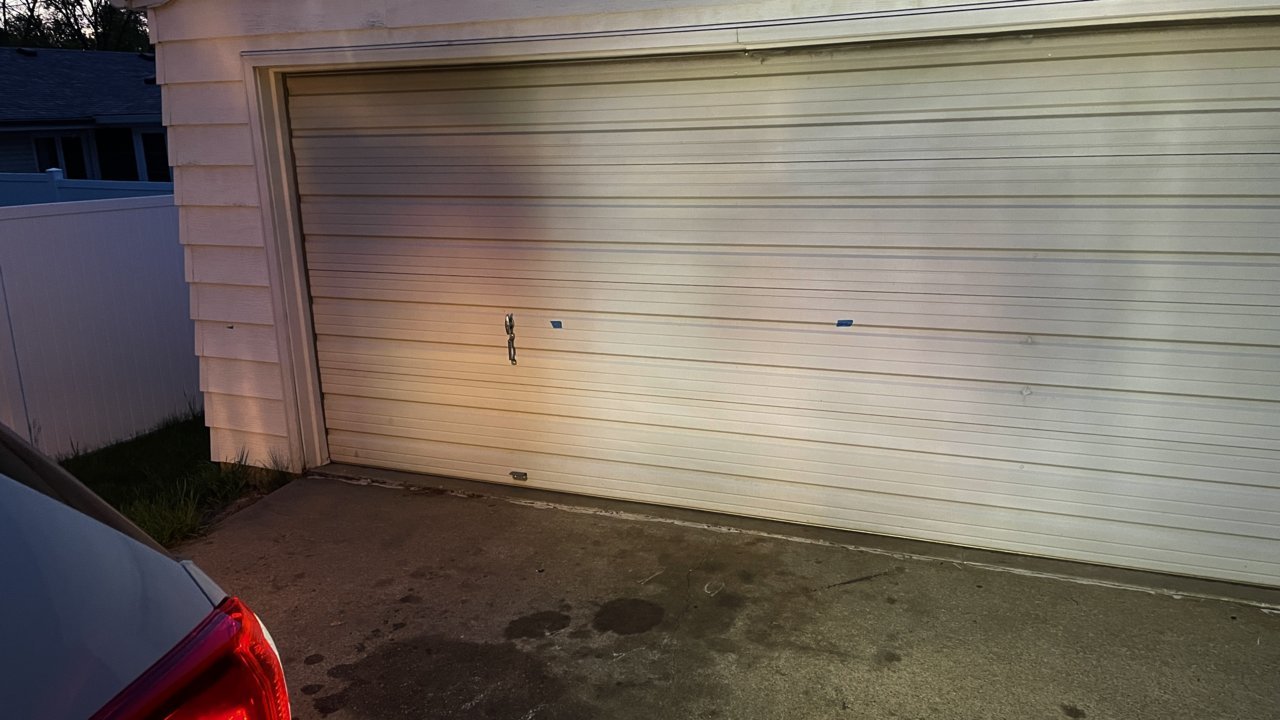

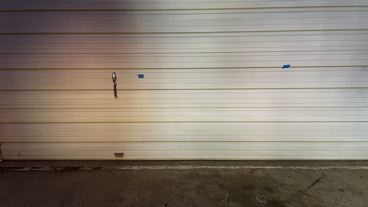

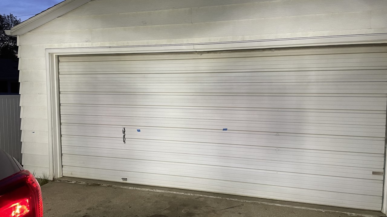

    Got the VLEDs V6 Triton 921’s installed on our 2021 Subaru Ascent. I know it’s not a Tacoma, but it has a 921 reverse bulb also and my wife needs all the help she can get....love ya hun! Lol With the results though I may have to get some for my Tacoma too though!
    As soon as we got the car I installed the Osram GY6.35 which was a big improvement, especially with the tint.
    These V6 Tritons absolutely demolish the Osrams! However, they come at a cost...$120 cost. But like their other V6 Triton line-up, they simply can’t be beat in terms of output and light spread. Unfortunately all I have is my iPhone 11 Pro. So I don’t have a Lux meter either. You’ll have to suffice with what I have. But here goes!
    https://www.vleds.com/shop-products/v6-triton/v6-triton-extreme-kit-w-921.html
    Pictures were taken at dusk, not quite dark FYI. The garage door was about 12-15ft away from the car. I dimmed the brightness of the photos to better show the output differences as well. Something else you’ll see is a dark spot in the middle, it’s not visible in person.
    Standing the middle of the vehicle. Osram left and V6 Triton right.
    From the drivers side at the corner of the vehicle. Osram left, V6 Triton right.
    From the passengers side of the vehicle. Osram left, V6 Triton right.
    Finally both V6 Tritons!!!!!

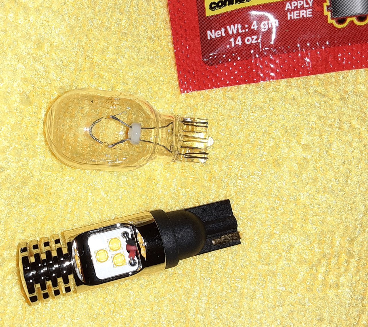

    20221114_134857[1].jpg For as short a time as I spend in reverse gear, I really appreciate the cheapest VLEDS 921 bulb replacements, esp. when backing into my space in the condo complex 8-bay garage. Tighter space for a taco or other pickup, and not lit well enough for working on vehicles. :thumbsup: (This pair just arrived for my other red truck, the '07 Malibu since the left bulb is out.) VLEDS is located in Bellingham, WA. (Discount sale during November 2022... That was great timing...)

    Yes, though light distribution and pattern may not be quite the same as stock. LEDs often do not distribute the light as evenly, or as wide, since the LED light source is highly directional based on where the emitters are pointing vs omni-directional incandescent like stock and like the stock reflector is designed for. You'll note that in the VLED model shown above, the bulb will not perform as well, 45 degrees to the rear, because there are no LEDs pointed in that specific direction, and also none pointed into the reflectors to get light to go in that direction. So while it can be brighter, the light doesn't necessarily project distance in areas that are useful like an incandescent. But for short periods, higher output is now possible with high-end LEDs, though that doesn't necessarily mean brighter illumination everywhere. Note that many cost friendly LEDs that will not be the case. Even for the high power LEDs, output will start to drop immediately, but will still be higher than the HIRs for a short period. Stock is 264 lumens, so compared to stock the 720 lumen HIRs are 2.7x+ brighter.
