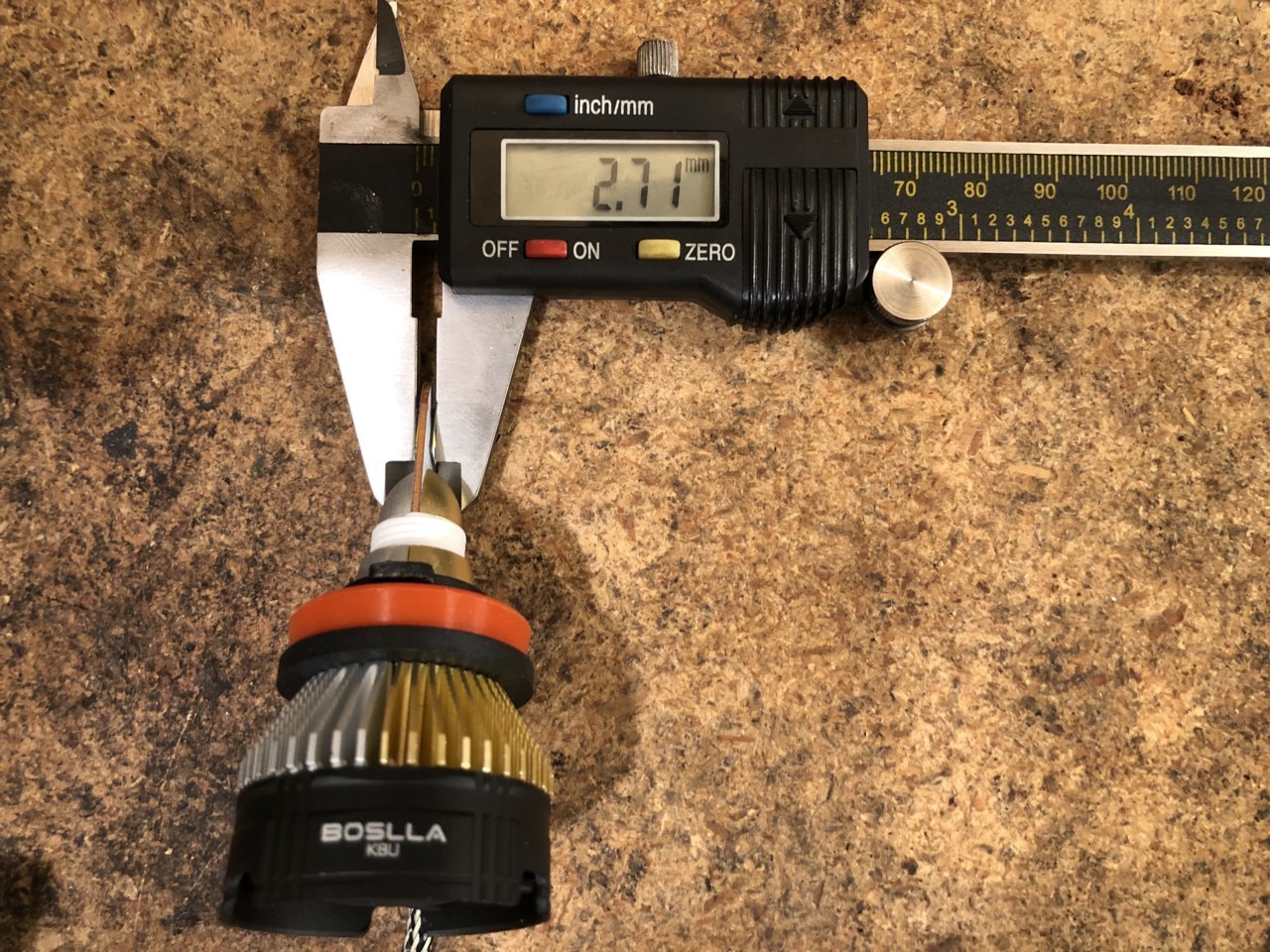

    Man, the diameter on those LED bulb replacements is pretty painful to look at. Even for a reverse bulb, the optics are going to be sooo far off. The diameter of that product to work accurately should be about 1.5mm. It is an order of magnitude off, at least. Sure it will put out a bunch of light, but there is no optical engineering or understanding in those products in the slightest. I expected way better from Vleds, that is straight up Amazon/ebay off-brand china design quality.

    Reasonable perspective. However, given the desire so many of us have, of amber turns, we're limited to an LED switchback to accomplish that.
    In other words, tradeoffs are completely worthwhile in my opinion.
    I do like the HIR reverse bulbs in my '05 and I might run them in the '02 (still on stock halogens for now b/c time is short)
    You, yourself, are a fan of amber turns which you don't have in your Tesla so I'm sure you can understand.
    Dunno much of anything about designing an LED switchback but I'd imagine it's somewhat difficult to make it super tiny. The 921 triton extreme reverse is smaller.

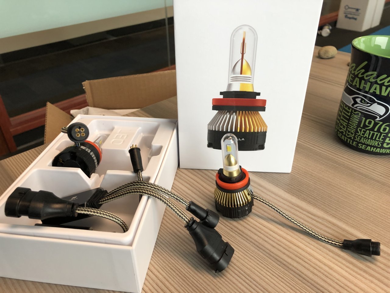

    Amber turns are definitely preferred. No reason a switchback needs to be that bulky though. You can look at several of the cheap china blade switchback headlights that do it far closer to the appropriate size. Still doesn't work for a headlight of course, since you cannot position multiple pairs of emitters to support multiple colors in the correct optical location for a focused headlight pattern. But they are way closer to being correct than those bulky VLED units.
    Like this dual color emitter LED
    Definitely not a product I'd recommend, but this is an older product and easily shows switchbacks can be far smaller and more optically compatible than those dated bulky units by VLEDs.
