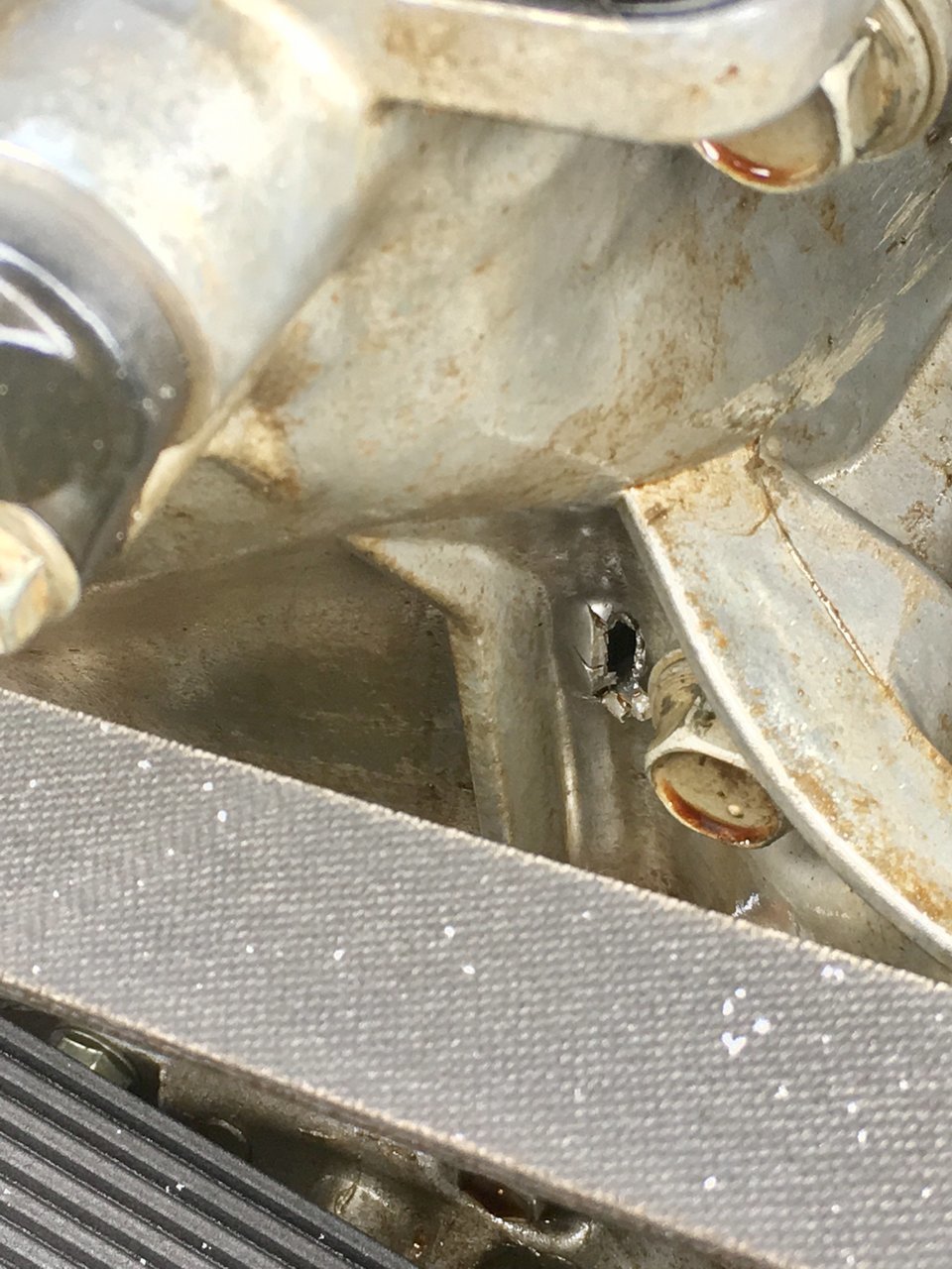

    Is there actually oil coming out of that hole? Isn't it in the timing cover?

    Not when it's idling at least. And yes, that's the timing cover.

    hmm i doubt thats the source of the oil leak. But either something shot out of there or it got damaged when the shop was working on babyt.

    Looking at the hole tells me that something from the inside came out violently. Consider sending that photo to the person that did the rebuilding a WTF?
    In the 4 cyl, timing of crank and cam is accomplished with a chain as opposed to a belt in the V6. Chains, tensioners, etc. need oil. So yes, oil is present inside that cover.

    That hydraulic tensioner that Ray was fighting is right in there. I'm suspicious that's where the noise was coming from prior to failure. Sorry to see this man! I still wonder if it's repairable by a qualified technician. It's worth a look if pieces didn't end up in the lower end. They're probably laying in the bottom of the timing cover.
