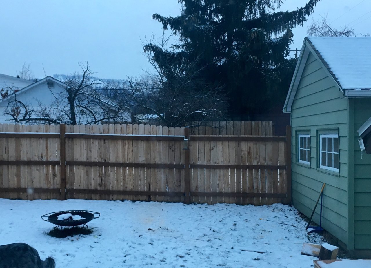

    AFE2C2A4-F775-4FBA-9A6F-166D804A0187.jpg E8B3A244-7649-4035-9C8A-DF08DBF93A1A.jpg Well, I got bored of being furloughed and decided to start on my spring chores :laugh:. I have been cutting the fence down to around 5ft as we didn’t like how closed in the 6ft fence felt and wanted to “level” it off. They need to open the gov back up because I have been watching one to many DIY videos and I am itching to knock out a wall or two :laugh:. Lizzy would not be impressed.

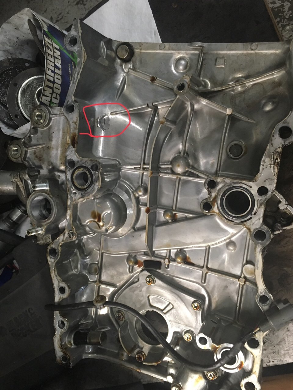

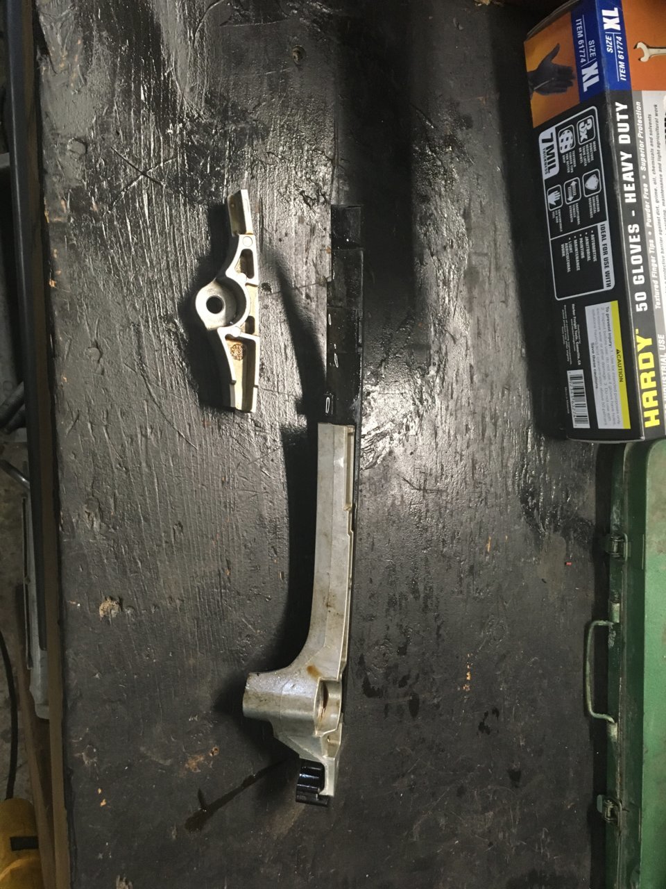

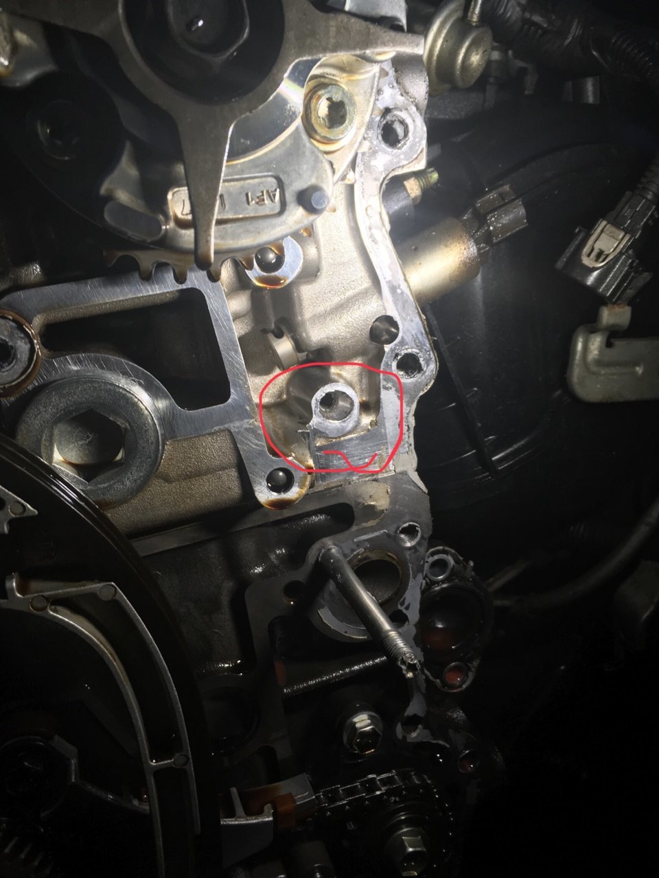

    So he said a bolt was loose on one of the tensioners and that led to the bolt rattling/breaking. Once broke the tensioner snapped, leaving the chain loose to slap the timing cover. The bolt bored a hole into the head of the engine before breaking as well.
    So he plans to weld the timing cover, bore/thread a bigger bolt into the head so I don’t have to replace that, and then buy a new tensioner. He said it’ll be about $600 when he’s all done with it.
    Glad I went with him because had I dug into the engine and saw the damage to the head I wouldn’t have thought to bore it out.
    Let’s hope it works out!
    O, and the other shop lied to me saying there was a huge hole I didn’t see in the timing cover and that there was no way to move forward without replacing it.
