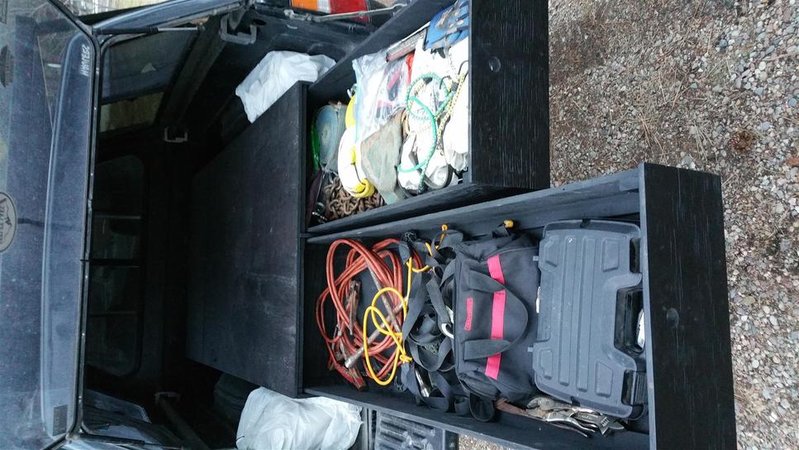

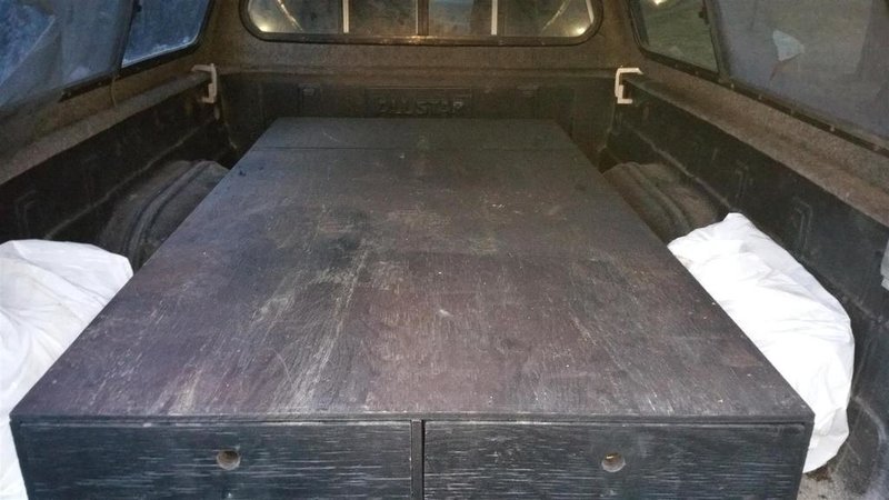

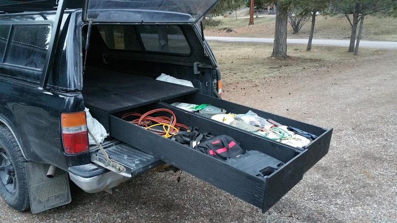

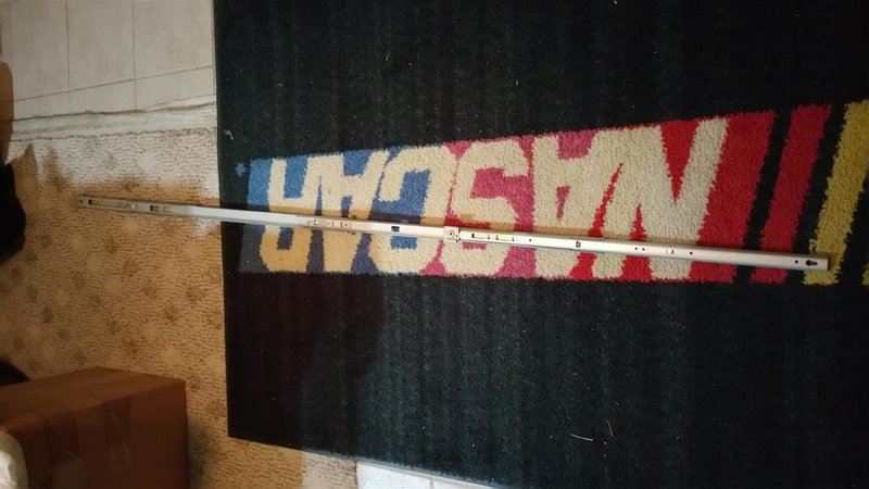

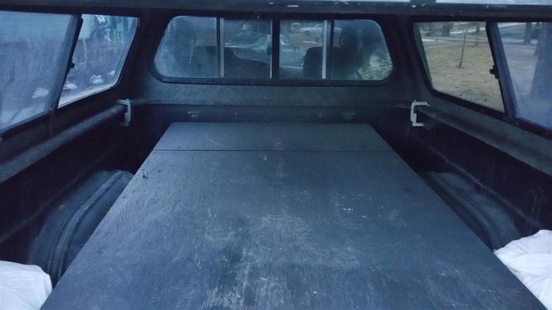

    Ok hopefully these all upload. I think you will be able to see the box in the front close to the cab that is the full width and about 18" long. So it is a nice storage area foe items you want to take along but not always need quick access to. As you can see in the pictures with the drawers pulled out they can hold a lot of stuff. The right drawer has a lot of weight in it at the moment with cahins and straps and snatch blocks and what ever else. Yes when both drawers are pulled out this far the whole storage box tilts up but as you can see it sits on the tailgate and stays in place. Last you can see the slides. In the picture I have them extended to 72 inches. I think that is a little much but if backed off to about 4 feet or so I know they will work good. Just let me know if your still interested. I have 4 on hand

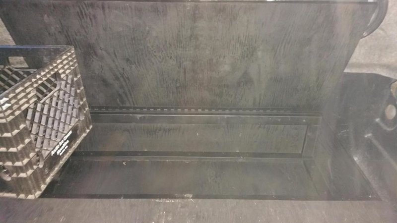

    Ok so I guess I should include the picture of the front of the box. I am sorry they are all so small. I am not sure what I am doing wrong but if you click on them they open full size

    ok they are yours. PM me your addy info and I will see what we can do to get these buggers shipped to you. Or we can work on a different way for you to get them if you want. I believe I have about $100 into this storage box. The most expensive piece was the 6 cans of Home Depot bed liner. But I would not go that route if I were you. Buy a can of the herculiner. Cheaper and better product. In the forward box picture you can see I used 1x2 for the frame. I glued it and clamped it then also added a ton of drywall screws to help hold it together. The hinge came from home depot and I believe was like $10 or so. Pretty simple. I am not much of a fab guy so as you can see it is a simple build
