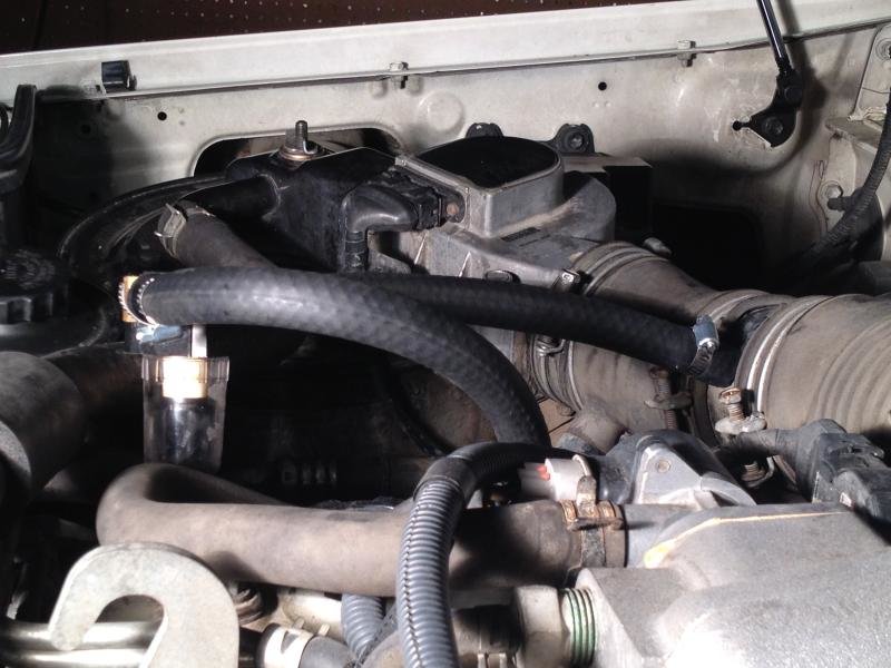

    I used a spare air compressor oil separator on my FJ80, as it also had oil in the intake tube. It works great, but it fills up every few thousand miles and I should have a larger one in there. I check it often enough it doesn't really matter much. In the old days, engines vented the blow by gasses (and oil vapor) right into the atmosphere. If you've ever taken off an intake full of crud from thousands of miles of PCV barf you know why. An interesting note- When our motors are cold blow by is at it's worst. It is better to slowly warm your truck at idle than hop in it and hit the highway when it's -20F... Next cold morning let your truck idle and remove the oil fill cap. It is amazing how much air is moving past the pistons.

    Thanks for the info @username. I try my best to warm it up when I can.
