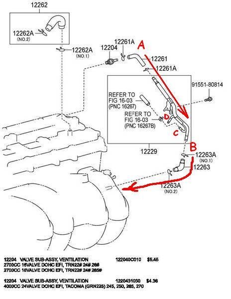

    I think #4 cylinder being caked in oil is probably the result of nothing else but the PCV going bad. In this diagram you can see how the piping from the PCV in the valve cover elbows right into the #4 intake runner. It stands to reason that #4 would get pretty much all the oily residue.

    Wait, so you think the PCV is the only thing that was wrong then?

    I my opinion it's very possible. Look how in the diagram the only intake runner that sees any flow from the PCV is the 4th one. And judging by how caked that spark plug was it's also possible the motor was only running on 3 cylinders some of the time.

    I am wondering though, why there appeared to be oily residue on the throttle body. The PCV dumps into the intake well downstream of the throttle body so that should not be the cause of oil on the throttle body...
    Anyone know if there are any other vents from the crankcase to the intake plumbing? Something after the filter but before the throttle body? I know there's a vacuum line or two that go into the intake tube (b/t throttle body and air box) but I can't recall where they come from. If they come from the crankcase perhaps a small catch can could be installed there in addition to one in the PCV circuit?
