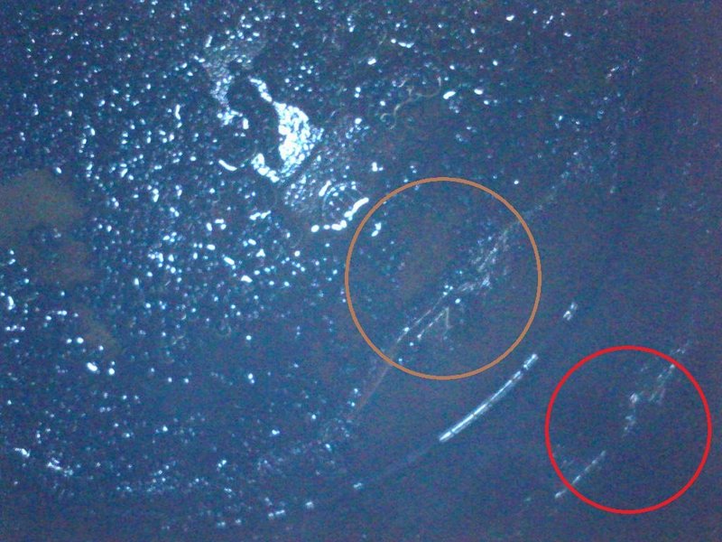

    @BabyTaco what are we looking at? Is the a scoped picture of #4 cylinder? I can't really tell. If it is, it looks like there is some oil burn and water. Are you loosing coolant too?

    Yep, top of #4. I have not seen a decrease in coolant and I have been watching that regularly to see if it might be a head gasket. Pretty sure that is a big ass crack on the bottom right corner.

    Are you talking about the orange, red or in between? The groove in orange looks like the factory groove they put in the pistons to make a little more room for the valves. I was thinking that in between looking like your cylinder ring. In the red kind of looks like some possible scoring on the cylinder wall. It's kind of hard to tell much from the pic though.

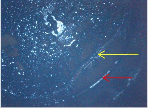

    Yellow arrow looks like recessed area for valve clearance.
    Red looks like reflection from camera or overhead light.
    Can you point to where you think there is a crack?

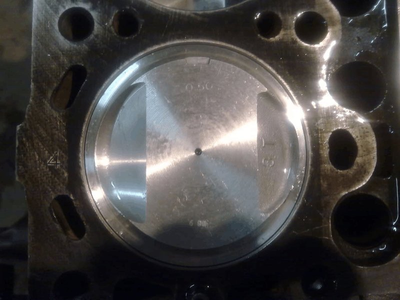

    Here is a better pic. Found out I can adjust the light and brightened it up. Tried to dig out details in PS but not much can be done to such a low quality image. What looked like scours on the walls is actually just the reflection. I can't see much other than they look shiny and decent.
    [​IMG]Snap_004 by Gage McKeag, on Flickr

    I think I just freaked out a bit when I saw the weird looking line in dim lighting :laugh:. I can't see any obvious damage other than the gunk. The walls look good but all I can really see on them is the reflection.
