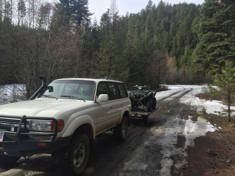

    I hear that, just giving you some motivation. We need pics of the '80! At least some details on it. The axle leak is a common problem on these old pigs. It's the inner axle seal that lets the diff oil leak into the birf, mixing with the grease and leaking past the wiper seals on the knuckle. It is not a fun job, but you can typically do it in a day by yourself. You can take the square plug out of the birf and shoot some grease in there to get you by, however every mile you drive will slowly eat the bearings and birf up, eventually causing a clicking sound when you turn. I did mine about a year ago and just replaced everything, including axles. It was around $1200 in parts and I used cheap trail gear axles. Since then, I've just been driving it. Even towed the four wheelers up in the mountains! (it was a slow trip up the grade though)
    02974667-B579-4E25-8035-16578623A658_zps_ee3c83f7813655147008dec9b6e0c29b27d8e661.jpg
