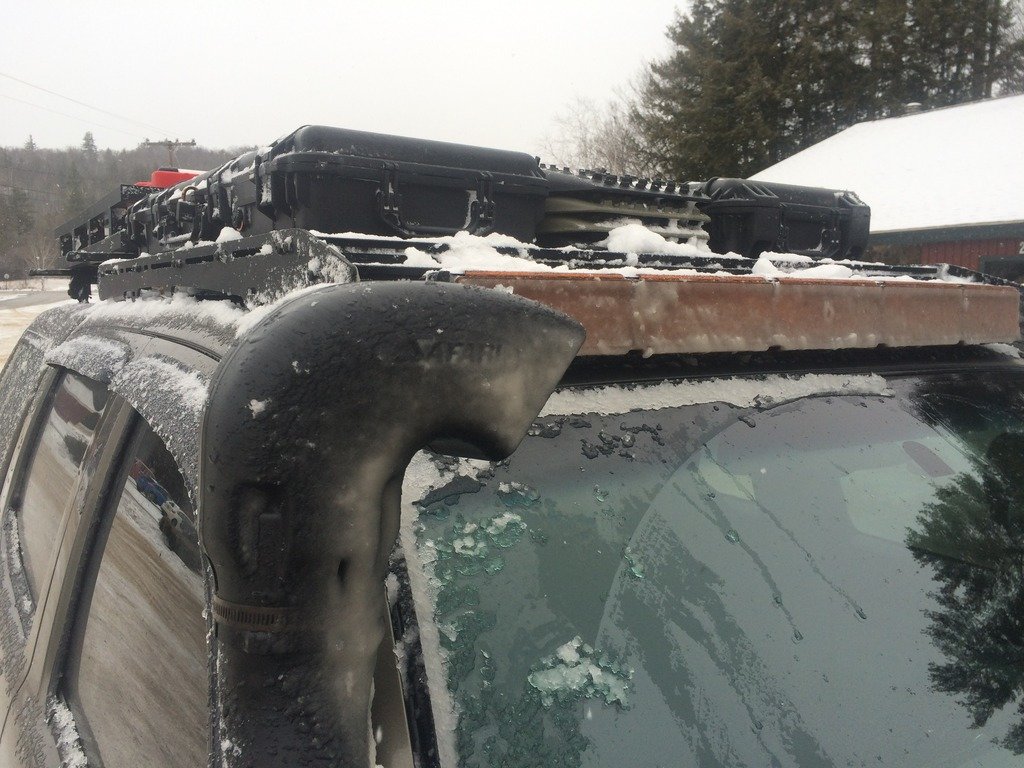

    Everytime it's snowing I turn the scoop inward 90* and have never had issues in the snow. This is from a trip this past winter in New Hampshire during a snow storm

    Yea some people run the scoop completely backwards. I think it turned in 90* minimizes flakes entering in the snorkel while still allowing some air flow to enter. You can see in the pic the build up of snow and slush on the outside of snorkel that otherwise woulda been in the inner backside of the scoop and eventually melted. I keep a key to the hose clamp in the cab to be able to pull over at any time and adjust as needed.
