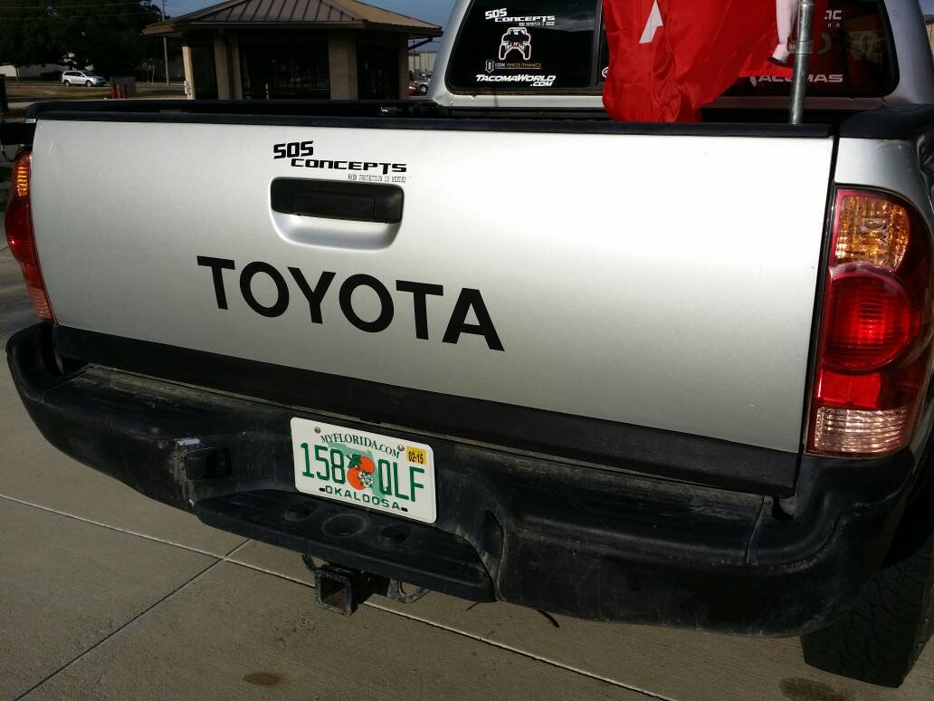

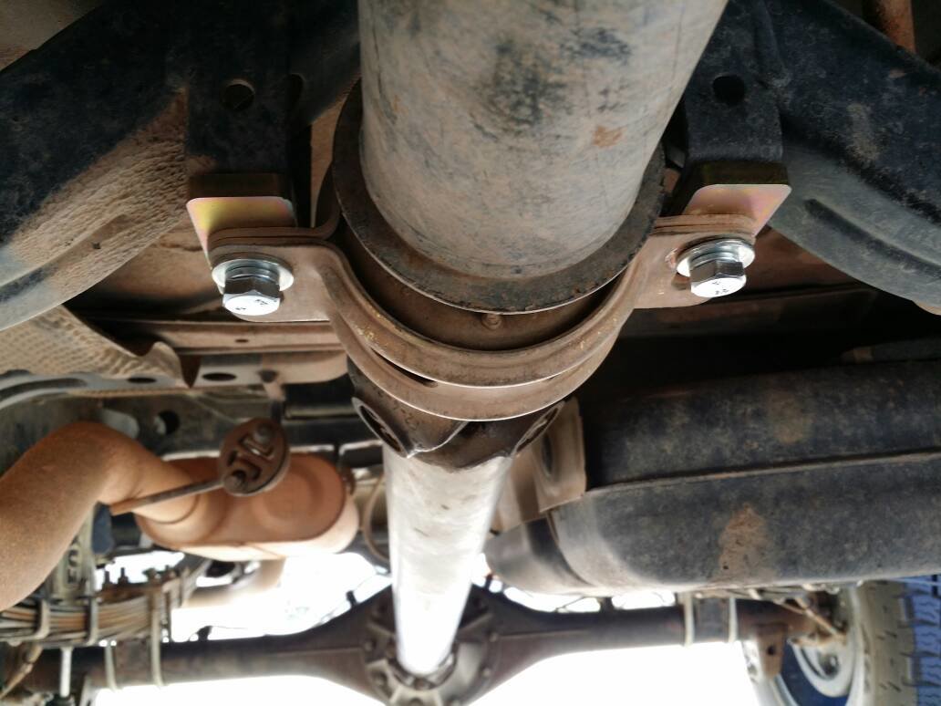

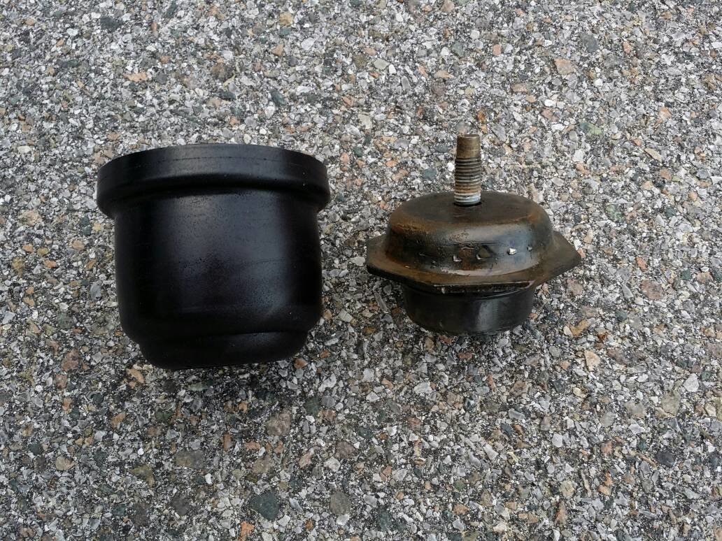

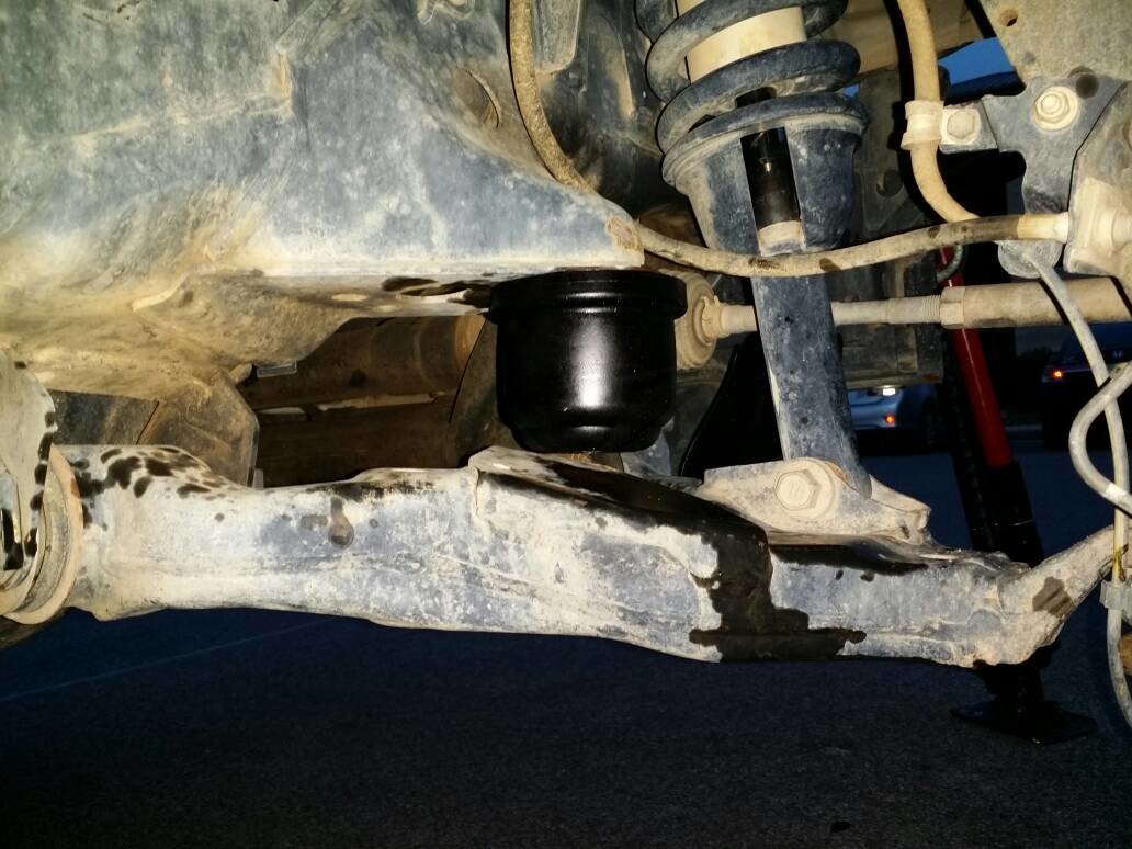

    got my wheelers super bumps and OME CB drop installed and got my new tailgate decal put on
    Old decal
    New one, it's only slightly bigger, but i like it

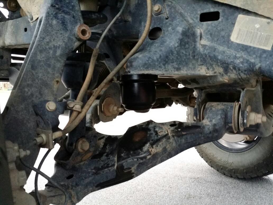

    CB drop, i still need to get a DS spacer that fits my ds

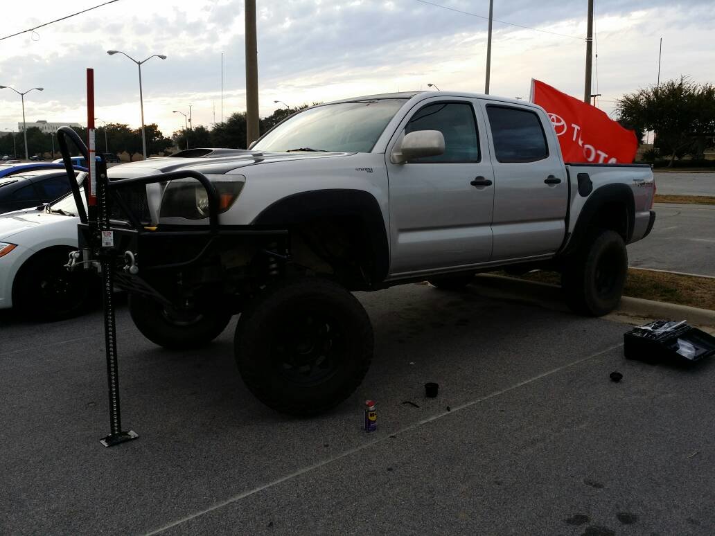

    Super bumps!!!
    My hilift actually came in handy lol, first time actually using it other than just to show off haha

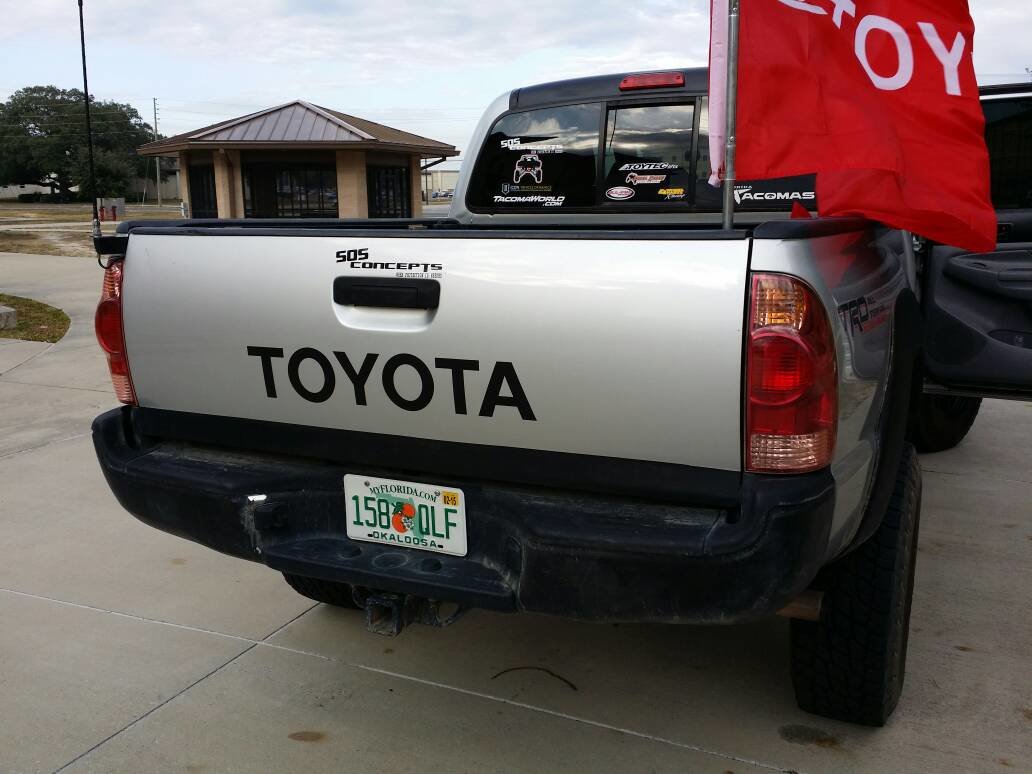

    Another sticker to add to the collection :D

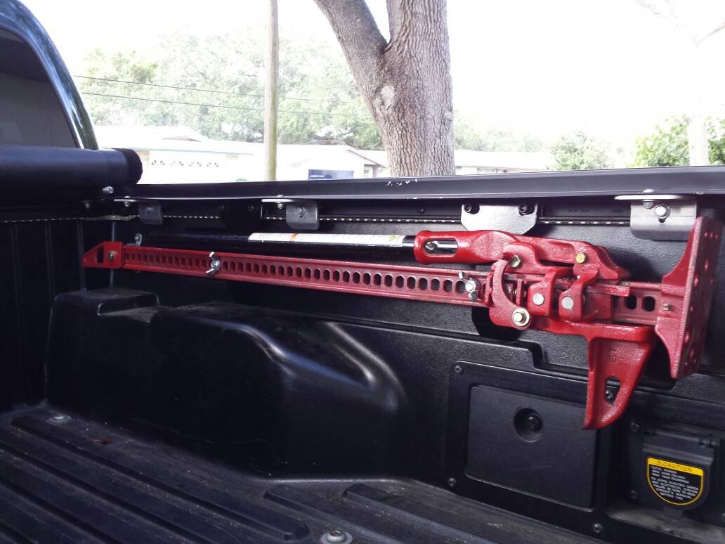

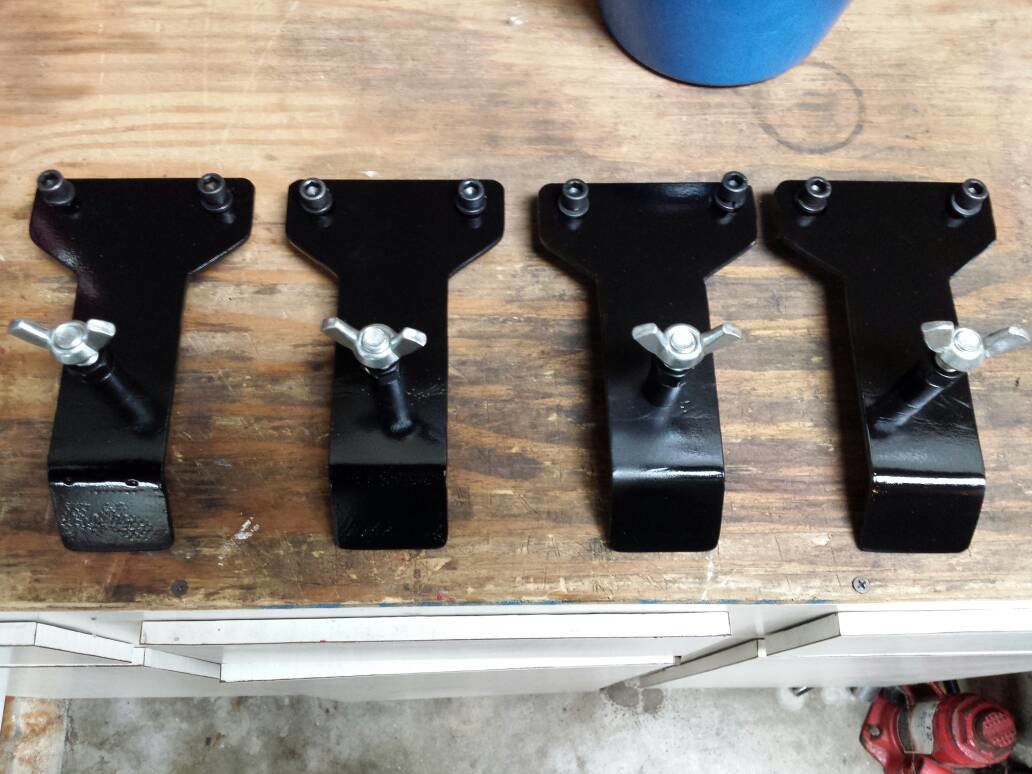

    You need to fab up some mounts like I did. Kinda stole the idea from the 4X innovations mounts. Made some for Nam also.

    Tinted windows 5%, sill protectors, TRD stubby antenna, weathertech in channel rain guards, wheathertech floor mats, BHLM, Truxedo low pro qt, DTRL deleted, anytime backup camera, bed storage locks, fog lights on anytime, tailgate theft deterrent, painted engine cover, relocated horns, l.e.d bed lights, l.e.d engine bay lights, l.e.d lights above cup holders, in glove box, rear cup holder, in console storage & cubby next to steering wheel, Grillcraft grill, 17x8.5 SCS Ray10's, 35x12.50 Nitto Ridge Grapplers, Borla cat back exhaust, map & dome l.e.d's, TEQ badge on grill, Redline tuning hood struts, Maxtrac spindles, SPC Light Racing UCA's, Bilstein 5100's front set at 0 with OME 885's & extended length Bilstein 5100's in the rear, All Pro expedition leaf springs & 2" blocks, extended brake lines front & rear, 1.5" 4crawler drive shaft spacer, Beefed Taco carrier bearing drop, 1.25" spidertrax wheel spacers on rear, Kenwood DNX570 touchscreen with navigation, 30" led light bar in lower bumper opening, 1/4" top plate spacer drivers side, Bullet Proof Fabricating skid plate, Cali Raised ditch lights & Rago f Fabrication brackets, Amp Research power steps, smoked l.e.d 3rd brake light, Wet Okole seat covers, under cab LED'S tied to dome circuit
    Oh damn mine is 48". What if you rotate the piece on the end so it's not as long.
    Just measured my bed & 60" will just fit.
    That piece is for winching, you can attach a chain or strap to it & then to like a tree or the truck. Then hook a chain to the other end of the jack & then to the truck or fixed object.
    Like this.
    It can also be turned sideways & use the jack as a big ass clamp.

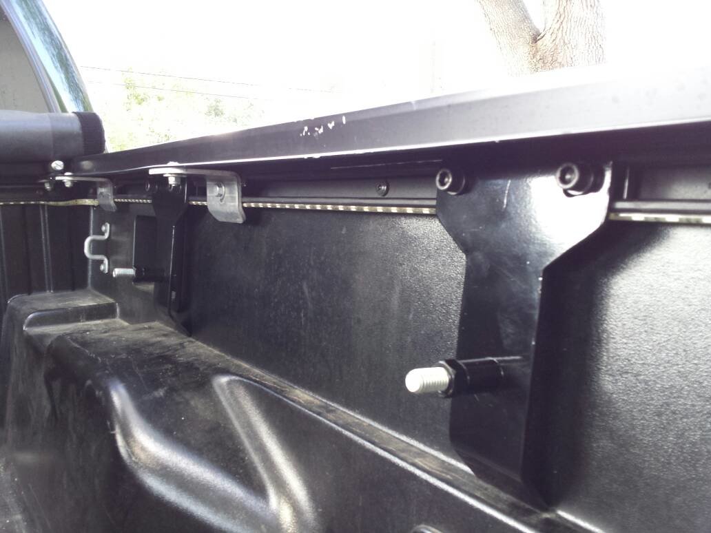

    Yeah I drilled & tapped pieces of 1/4" steel to bolt the mounts to, the plastic end caps on the track come off & they just slide in.
    The mount & tapped steel basically sandwiches the track. They make T nuts that fit in the track but I didn't feel like buying them.
