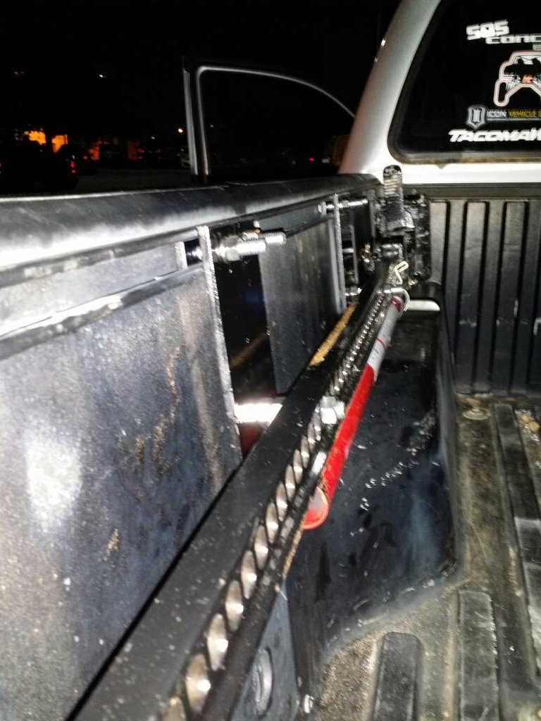

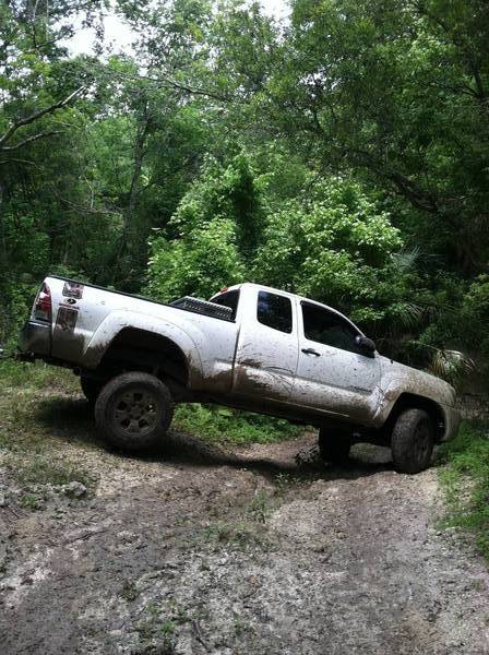

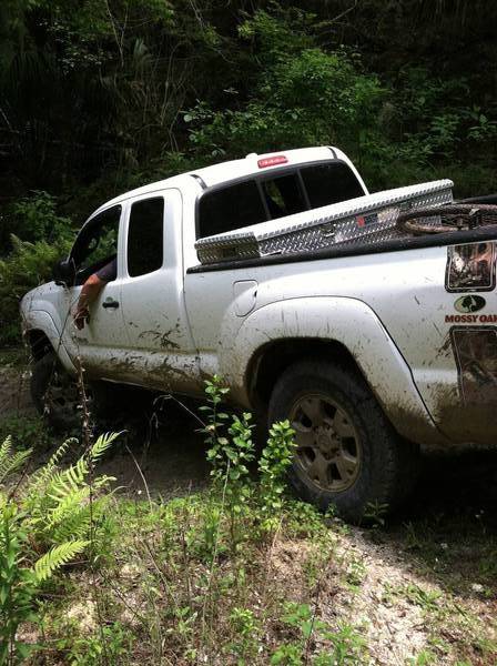

    I've had to use a hi lift before in a-pit I got pinned up against a tree on a down hill slope at an angle and couldn't backup
    It was in this spot at a different time I had come off of that at a different angle and pushed me down onto a tree

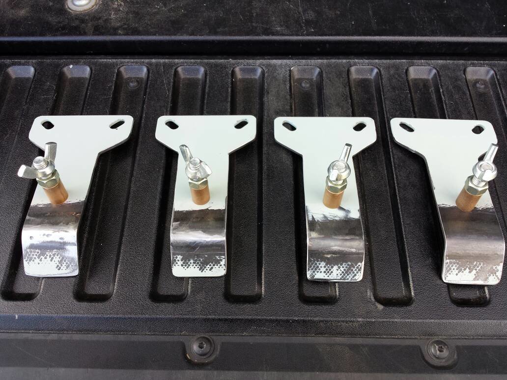

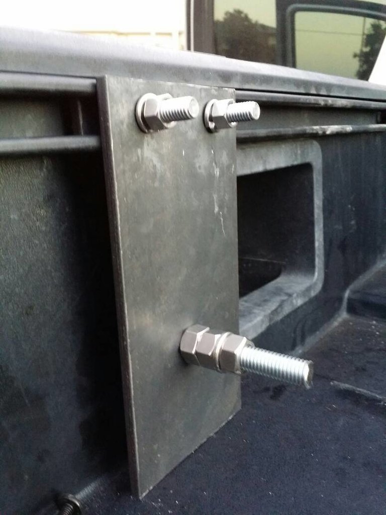

    I wanna say I used 1/2" bolts with wing nuts, I wanted it to fill the holes on the jack so there was no play. Measure your holes (flat to flat) & get bolts that fit. I'd measure mine to be sure but momma took the truck.:(
    For yours I'd suggest stainless if possible since yours will be exposed to the weather.

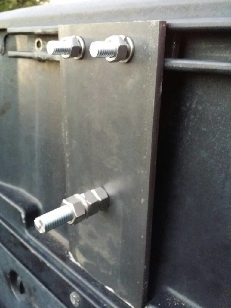

    awesome thanks, and what about that piece that goes into the bedrail? what size (if you remember) was it, and im guessing self tapping screws to go with it?

    It was 1/4" thick & 1" wide steel cut to be as wide as the bracket. I didn't use self tapers I actually drilled & tapped those for the 3/8" bolts I used to hold the brackets to the rail.

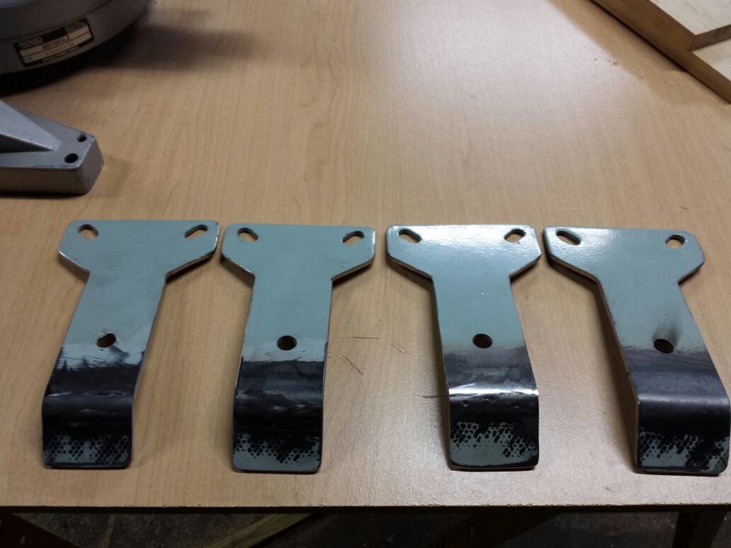

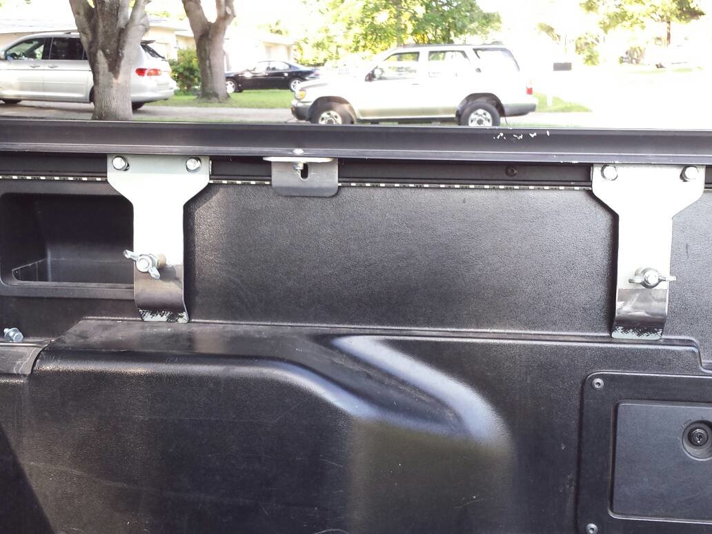

    Here's some more pics.
    They started life like this, had them laying around at work.

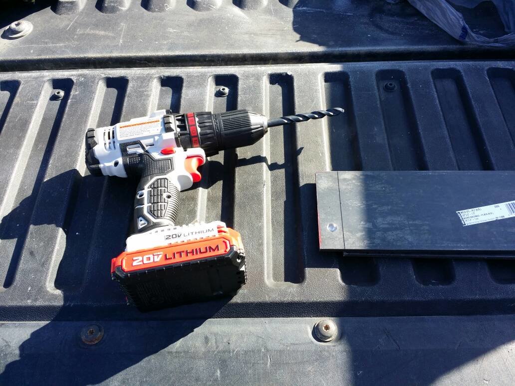

    well I started drilling the 3/8 hole for the bed rail metal piece...and my shitty little 7.2 volt drill died half way through the first hole lol....its gonna take awhile to get anything drilled with that pos haha

    3/8 hole in the bracket or in the piece that goes inside the rail?
    If your gonna tap the rail piece for a 3/8 bolt a 3/8 hole will be too big. When I say tap I mean cut threads.

    I know what tapping is lol, and ya that bed rail piece, the bolts/nuts that I got will fit inside the bed rail with the 1/4 steel

    Well I just went to the BX and bought a 20v porter cable drill...i that other one was pissing me off haha

    No drill press at the hobby shop?
    I see what your doing now, gonna put the nut in the track?
    I only used the flat steel so it wont turn in the track.

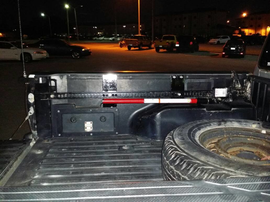

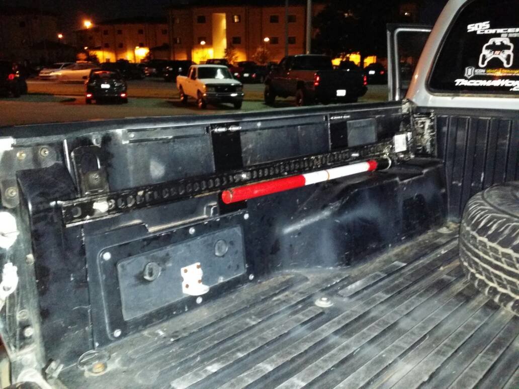

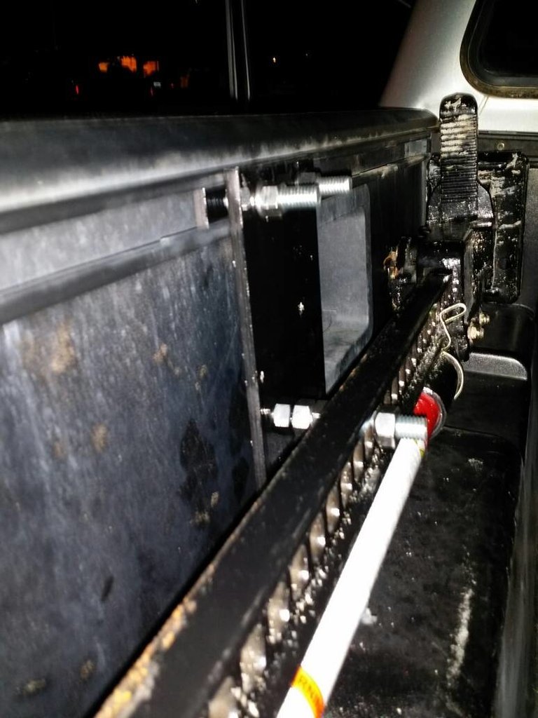

    What do you guys think? Just got done fabbing my hilift mounts I guess you could say, just gotta paint em and they are done

    Looks good, that should work. How's the jack fit?

    Fits pretty good,Lowes for some reason did not have 1/2 wing nuts...so I just used reg hex nuts to keep the jack on. those bolts barely got with the 1/4 steel in that rail lol, I had to remove the rail screws just to get them to slide where I wanted them lol
    it looks ok I guess lol, this was my first time actually building something like that myself. I think it turned out ok lol

    Looks real good for your first time building something from scratch & it didn't cost near as much as mounts already made. Well you did buy the drill so that raised the cost a bit. Haha
    If you flip the jack & put the base by the tailgate it wont be so noticeable sticking up above the bed, or will it not work that way?
    Just another idea for ya I ran a small cable with a padlock through jack & the tie down up by the cab. I didn't want my jaxk to grow legs. Haha
