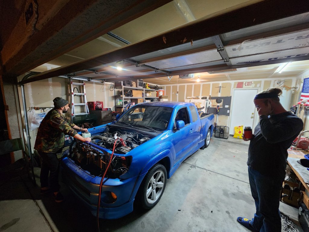

    Well it’s official, she lives again boys!! Cranked right up last night like nothing happened and put an 11 down in my street :D:burnrubber:
    could not have got it done with out all my local homies

    Just before the big moment... Of panic when an idler pulley started screaming. Which was just before the other big moment... When half a gallon of premium fuel was discovered on the floor 10ft from the lit grille... :rofl:

    Lol! Such a great night and feeling of finishing up our first motor swap ourselves. I love that Andrew handled this whole thing for his first time like a pro... Multiple oil pan swaps and seals, timing cover, etc.. and it was that 1 seized idler on the tensioner that ended up being the only issue. :rofl: I say it was a massive success.. it started up and ran beautifully after that. And she rips for sure!
