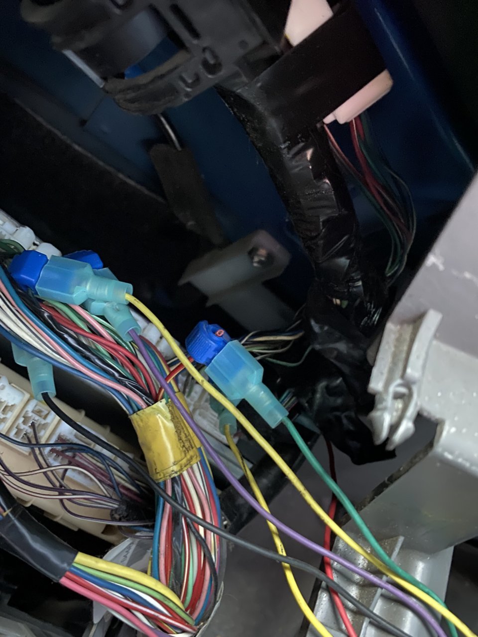

    Alright, finally got an issues figured out that has been causing some considerable grief. Truck was stalling and stuttering taking turns randomly and hitting speed bumps etc.. Tried a many different number of things before a shop I had it at figured out the URD MAF calibration unit the previous owner had installed wasn't secured and was moving around when I was turning and causing the shitty wire tap crimp connector thingys to pull on the wiring harness making the truck stall out. Glad it's figured out, not so glad how this dumb computer thing was installed all janky like.
