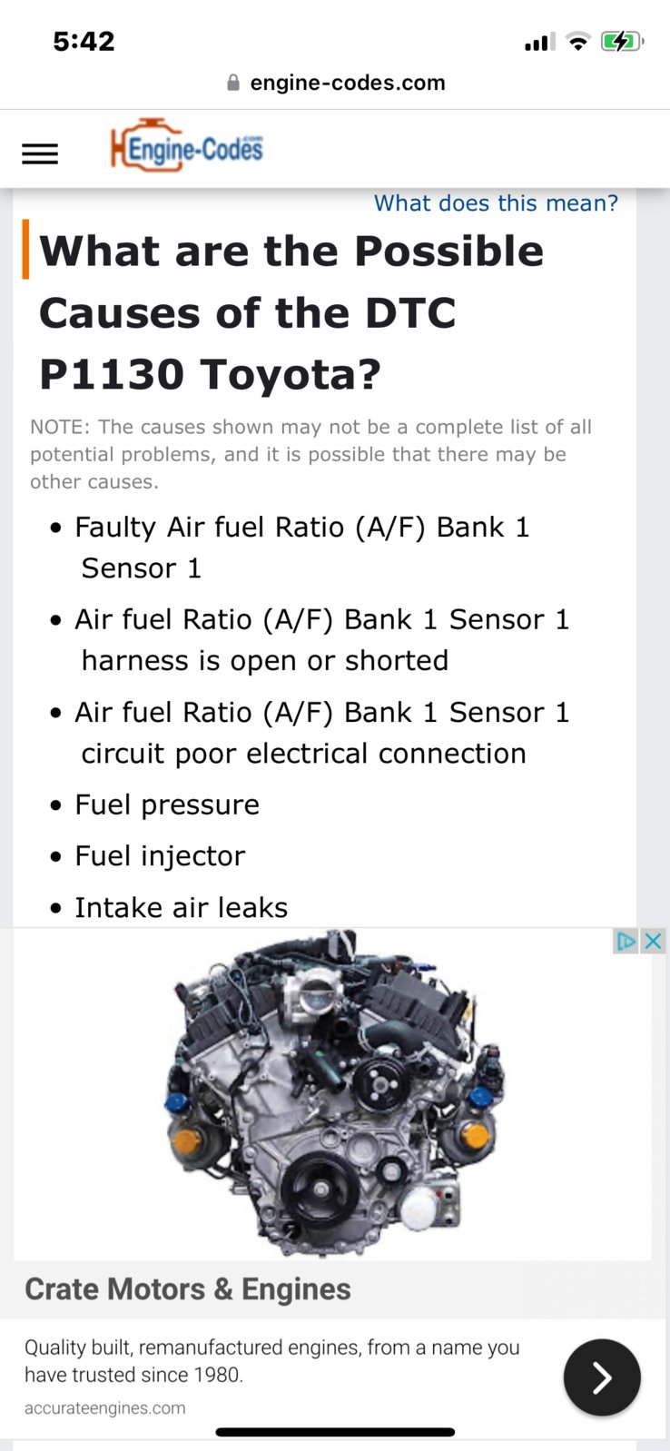

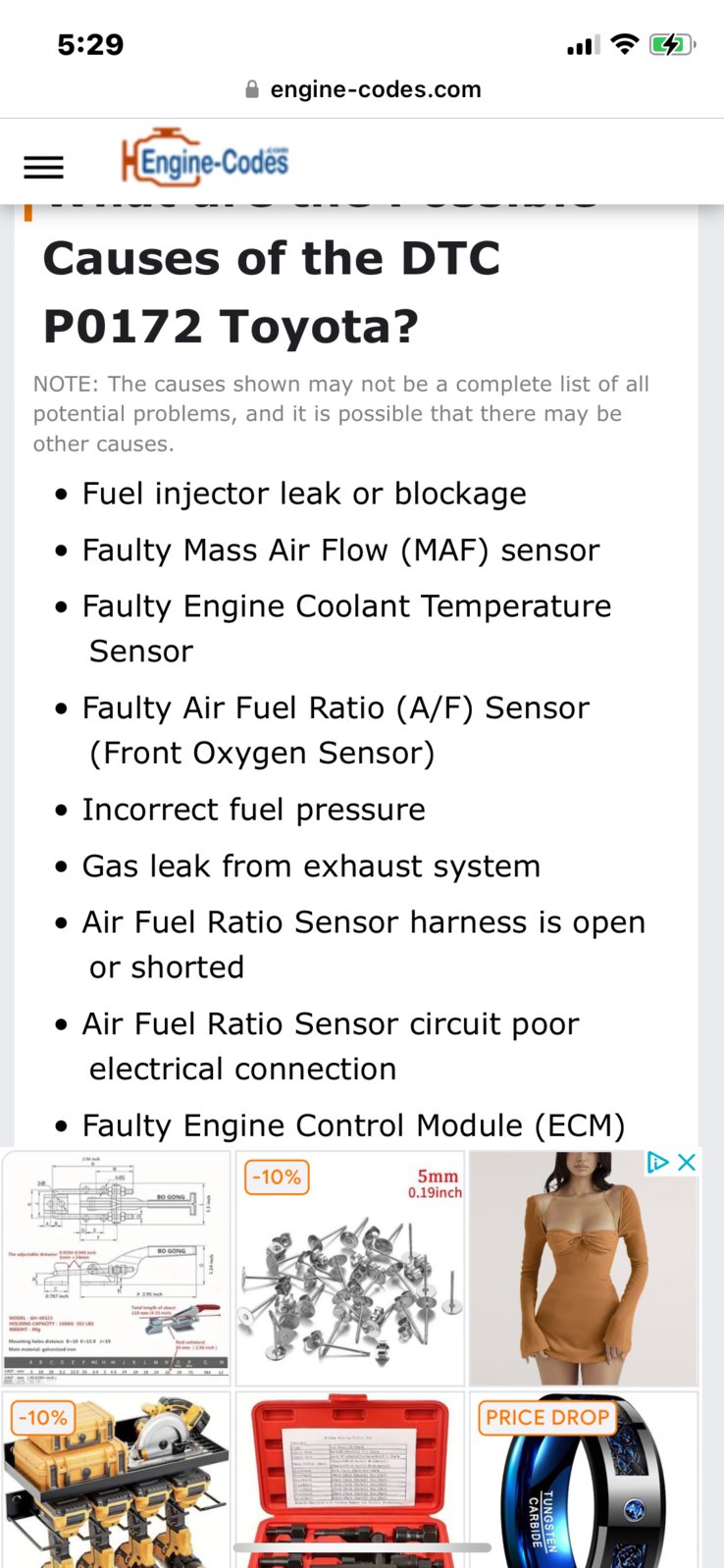

    So what experienced and solved
    -cleaned MAF….never had issue/code with the same
    -replaced coolant temp sensor
    -replaced front O2
    -have FP gauge 46lbs
    -no noticeable header leaks (I didn’t take shield off)
    prior to this CE lite, I replaced injectors with shitty $50 eBay ones.
    Bc I just started getting this code immediately after eBay injector install…..
    I sent my old OE leaking injectors to MotorWest…..installed new RM ones.
    No more P0172
    GL

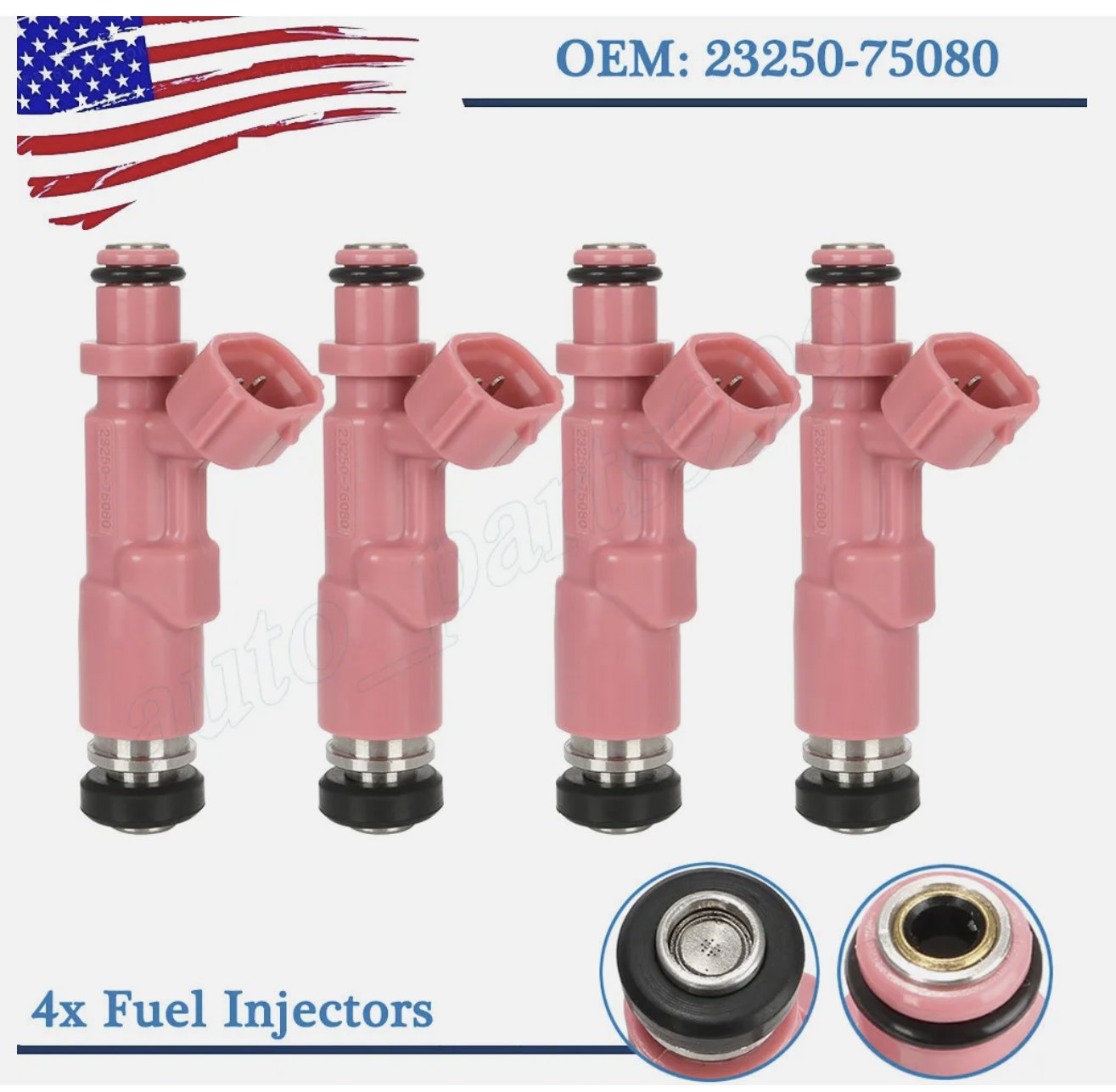

    These were what I bought to replace my old fuel injectors. These were apparently OEM, $33 upload_2024-3-9_19-27-35.png

    Just to be clear, those are not original Toyota parts.
    Using aftermarket parts isn't a ding on anyone's moral character but it may lead to tearing out any remaining bits of hair from scalp during an ongoing troubleshooting process.
    Yes, authentic Toyota parts often cost double, even 3x what aftermarket parts cost. Frequently (though not always) that cost difference is justified by higher-quality materials and tighter-tolerance manufacturing.
