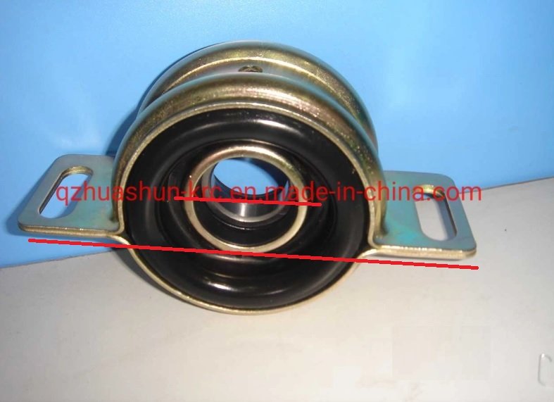

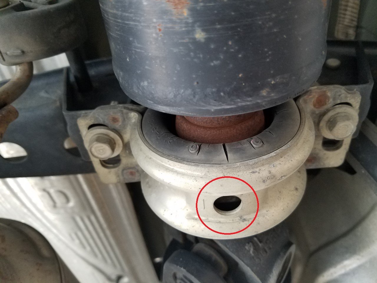

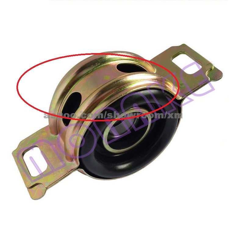

    Every truck will be different, Its easy to check to see what you need with just an angle finder.
    Also make sure your carrier bearing is install with the side with the single hole facing down and the double hole on the top.
    Two hole side up
    If you install it the wrong way it will throw the drive shaft off a few degrees, the bearing is not in the center of the mounting points
