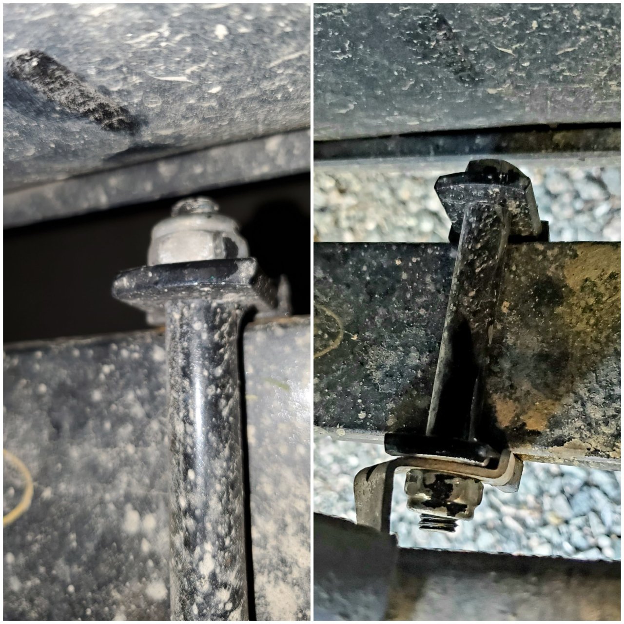

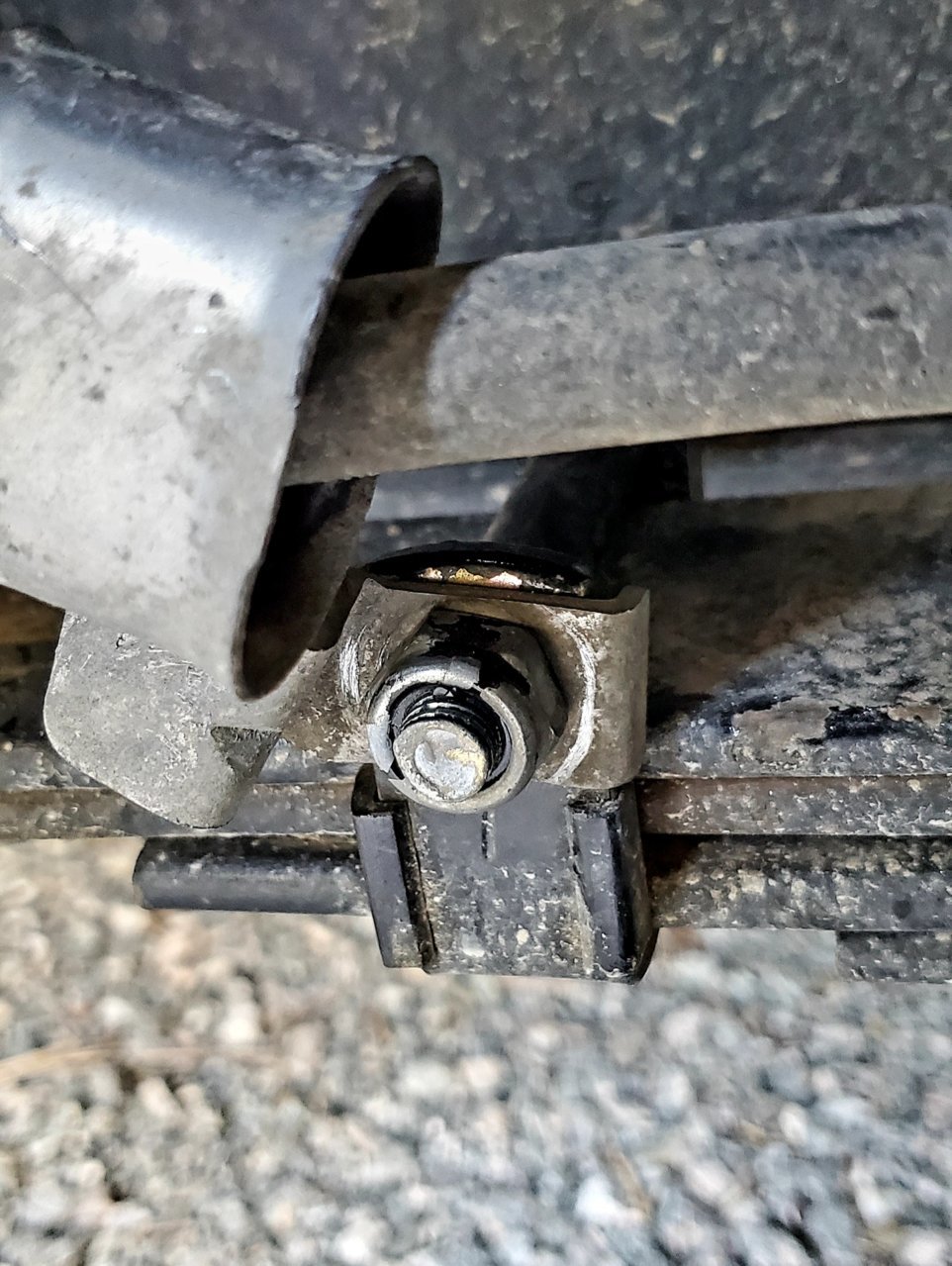

    Also heads up on the Dobinsons leafs...the ebrake relocate on driver side bracket bolt was installed backwards and can start rubbing the gas tank.
    Before = left (you see the dirt helps with wear pattern ID!)
    Here's the bracket/bolt looking inward toward gas tank

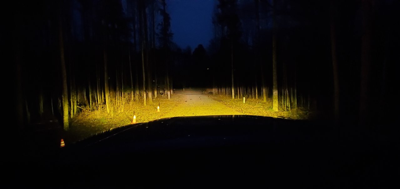

    Oh man, these things are nice! Not much difference with headlights on or off.
    Fog lights on, headlights off.
    Fog lights on, headlights on.
