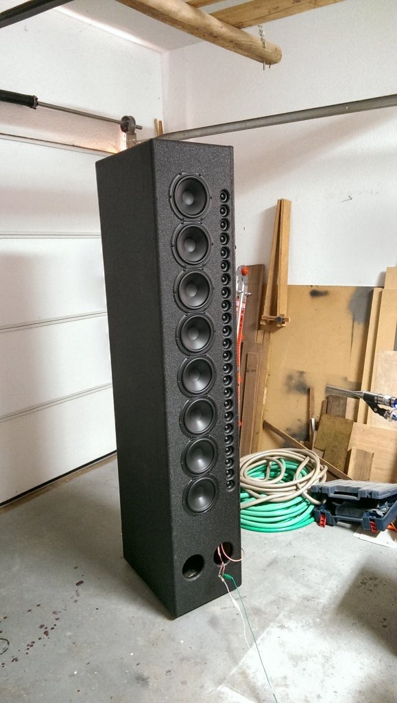

    Steve do you have any reading I may do on those tower speakers? I'm moving to my own apartment soon so I want to build a set and hook the up to TV amd play my music with them.

    Unless you promptly want to be evicted, might I suggest something smaller? I'm going to be offering a "kit" soon as a way to help DIY guys get their fix. Smaller like the little two way towers I posted on the previous page.
    This tall set are extremely efficient. We had them on 1 watt of power in the garage and it was already too loud for me.

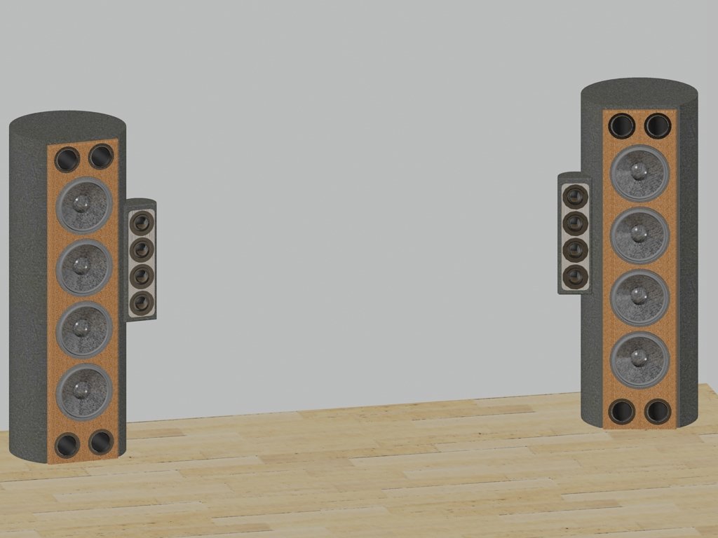

    After some research and planning, I've designed a tower speaker that I think would be ideal for home theater applications. The mid-bass enclosures will be thoroughly dampened, ported, and cylindrical in shape. This would prove to be very tough to build, but could potentially yield an extremely efficient and flat response! I'm thinking the best finish would be a nice vinyl around the cylindrical parts, and a nicely finished wood baffle for the mid-bass speakers. The brushed aluminium baffle for the tweeters is just for fun right now, but if I could pull it off in the build process, I think it would look pretty good! The tweeter location is offset from the mid-bass baffle to keep the acoustical center of every driver on the same plane.
    The drivers I've selected are;
    Tweeters: http://www.madisoundspeakerstore.co.../sb-acoustics-sb26stcn-c000-4-tweeter-4-ohms/
    Mid-Bass: http://www.madisoundspeakerstore.co.../silver-flute-w17rc38-04-ohm-6-1/2-wool-cone/
    I would hand build the crossovers set to probably somewhere in the lower 1k range with a -1db attenuation circuit for the tweeters.
    So I think they should be about 97.5db efficient with a nice flat response from about 70-20,000hz.
    Ideally, each tower will have its own sub woofer as well.
    Thoughts? (Steve? :D)

    Those are actually pretty good drivers. I can't tell how large those ports are but you'd likely be ok going with 2 4" ports per cabinet. Hell, you may even be good with dual 3" ports as long as you're not throwing a million watts at it.
    1khz on the tweeters sounds a little too low for those. Yes the graph looks good down to that spot but power handling (and distortion) won't be great at that point. I'd suggest around 2k. It's a great tweeter and the SB stuff has been great lately.
    Are you making the enclosures cylindrical for looks? It's going to be a hard build.

    Thanks, Steven!
    I plan on making the enclosures cylindrical for both looks and for response purposes. From what I've learned from a few books so far, it seems that cylindrical enclosures offer the lowest variation in response peaks next to spherical.
    These are pretty much on the back burner right now. I will likely not build them until I have a serious buyer already lined up due to the amount of time, funds, and effort these will take to complete.
