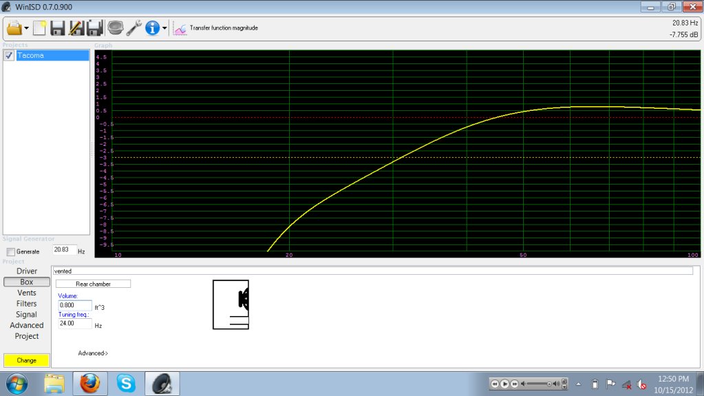

    So I think I've gotten my spec on a T-Line box for my Polk 8". My line will be 8' with a port area of 2.3ft^3. I have to go to Augusta Tomorrow so I'm going to pick up some MDF to supplement my stack in the shop just so I have extra if needed.
    Here are my T/S Parameters as per the manual.
    QTS:0.6
    QMS:5.5
    QES:0.7
    VAS:15.40L
    FS:35Hz
    What's the thinnest mdf you would use for a 10" running 600rms in a ported enclosure? I ask because if I use 1/2" I can get just over a cube and in which case can get a 12" Type-R Thin in a ported enclosure behind my rear seat but I don't think the wood could handle it.

    I wouldn't use 1/2". It will flex at higher volumes unless you brace it well.
    What does the volume go down to if you use 3/4"? What tuning are you shooting for?

    Just over .8ft^3. I'm just going to stick with 3/4. I thought it may be cool to put a 12 back there but I'll just stick with the 10 and 3/4. I've got it at 25hz right now.

    I'm not used to looking at WinISD and thought you were like 15db down by 30hz. The scale is totally different from Unibox. Looks decent from what I can tell. What is required via Alpine suggestions?

    The air volume is within Alpine's recommended specs for a 10" R Thin using 3/4 wood.
