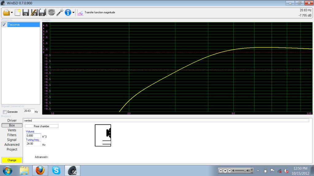

    Just showing off here, .757ft^3 tuned at 23hz.

    whats the mounting depth maximums? What woofer are you planning on running? seems like it'd get some real nice lowend extension.
    Is there anyway to make this a pair of 10's?

    It's designed for an Alpine SWRT-10. Tuning at 23hz puts the overall preformance very flat and drops at 15hz so it should play as low as I'd ever want it to get. I screwed up putting the hole so high up I'm hoping I can resurrect the box by sanding down some of the wood on the back if not I'll have to rebuild it.
    This particular graph show's it at 24hz but it isn't much further off from the 23hz it's at.

    Will, has this thing seen power yet?

    wait a minute... thats not a T-line is it? I looked at your other pics, port looks a little small ... lol

    Yeah I think it's just ported.

    He did say that but I think it required too much space so he went ported. Not sure though. I'm not sure what the SPL difference is but it shouldn't be outrageous in normal listening.

    I'll be building a T-Line soon, getting the wood now, the first box posted earlier didn't work because I cut the hole to high but sold it for a Franklin.
