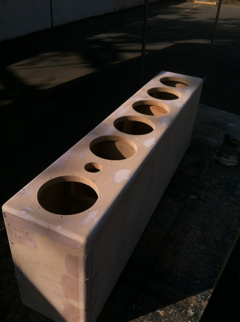

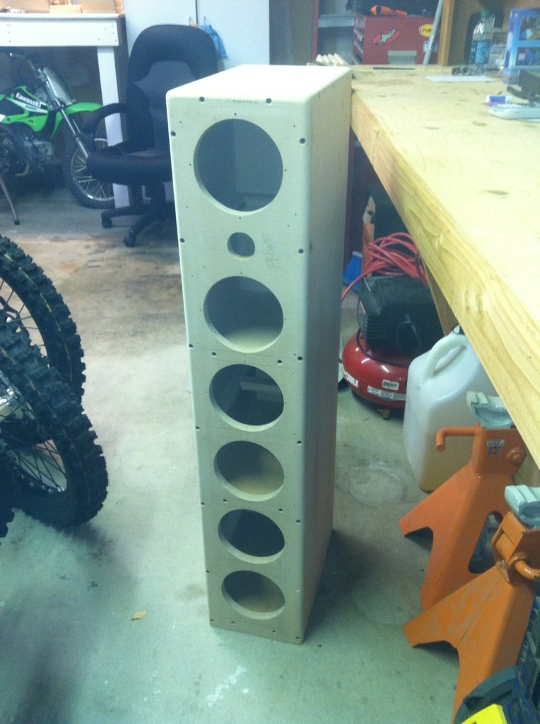

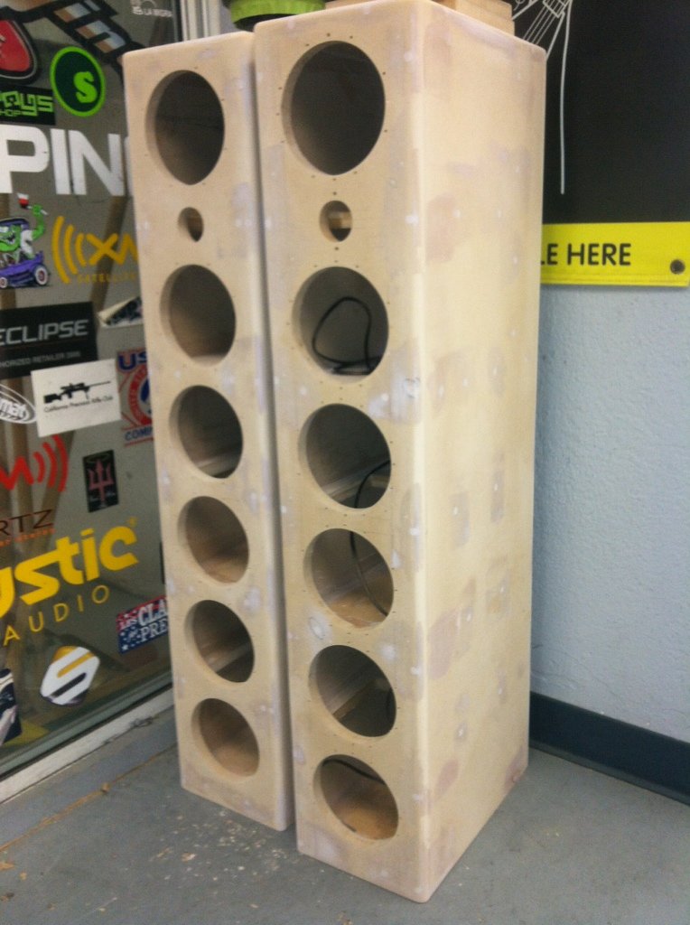

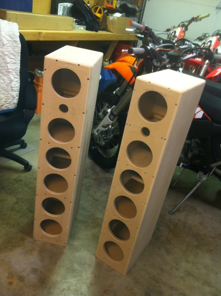

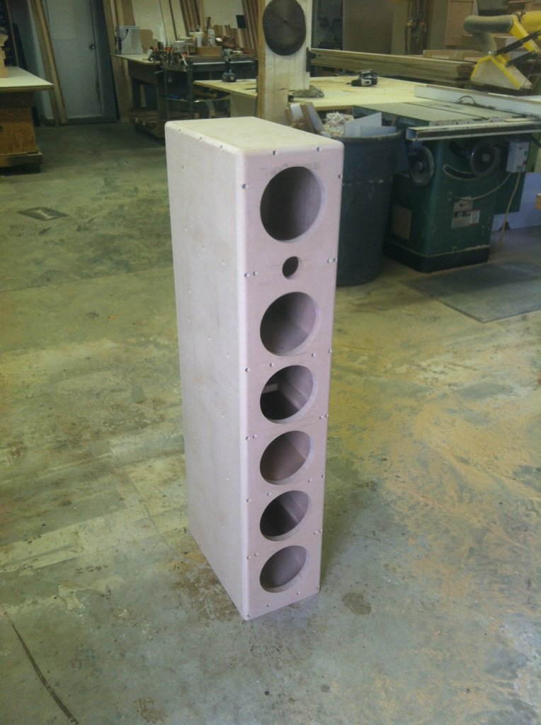

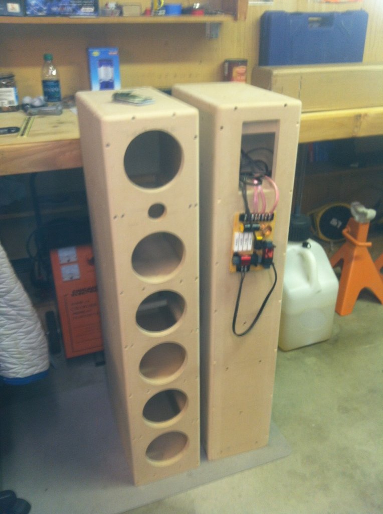

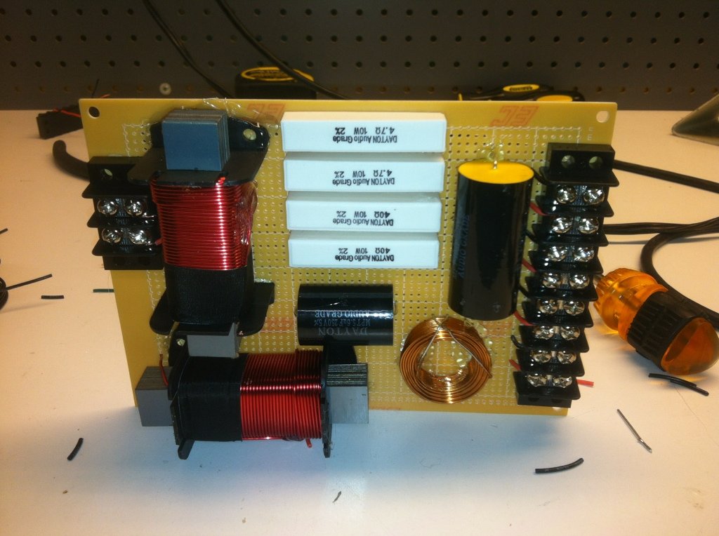

    Been working hard on my first pair of line arrays this week. So far so good! I can't wait to finish these and spend some time listening. I temporarily installed the drivers into one of the towers today to test my crossovers after I finished building them. Still haven't made a final decision on what amplifier I will use for these... Here's some pics from my adventures, thus far!
    3485E03E-6C0B-48F0-A7C2-CFCDE6B4C784-945_a9856dac5fbd6e4c20bcfe3d24edafb3c273f652.jpg
    B68A6C60-C8B0-442D-BE5D-7B711C4AAE9F-945_adaff1445b492944dd9b1dae392737be310150f5.jpg
    9F9FB730-A92A-494C-B6F9-FBAD4E986BDD-945_e1125bc433d134fa19421d7e808e2cbb0d6a03ef.jpg
    CDA562A4-9B1B-479C-A31E-7F673EC7DAF7-945_7c802393bea5fbb0790f3a37e412be4bede1775c.jpg
    3A1376A6-8A22-4447-96F7-DCCEDF3D3231-945_bc743ce71426f4aa0d84f2c97b66df6c921931a7.jpg
    234CD856-68AF-4CF3-A946-4246A620B038-945_7115637c601cd6df93a84f91ca31b483dd388505.jpg
    special thanks goes out to ItalynStalyn for his helpful advice in regards to line array construction and to http://www.speakerdesignworks.com/NS6project_1.html for the very detailed design for these towers.

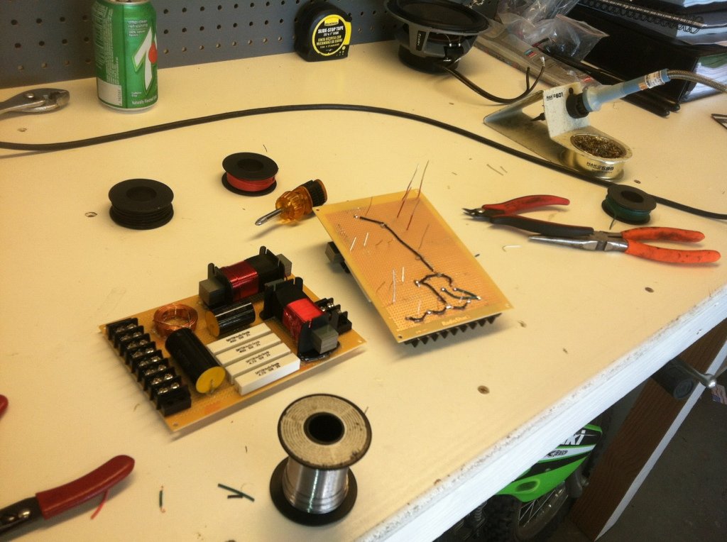

    You're welcome Shane! Cabinets look great and the crossovers look well built. I think you'll be happy with them.
    How much was the total bill from Parts Express after all was said and done?

    My parts express order was just under $330 and I've spent about $100 in other materials so far. The plan is to finish these, have some fun listening to them, use them for a party, then sell them for a little profit. I'll use the money I get from these to build a more advanced pair of line arrays and hopefully continue the trend until I have some seriously kick ass towers.
    The crossovers were fun to build - I've never done anything quite like that before - but, I really have no idea how to design a crossover. I was simply following the instructions from the speaker design project website. Do you have any recommendations for where to research information on crossover design? I would like to learn more about it so I'll be able to build crossovers with points of my choice.

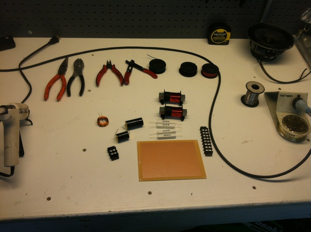

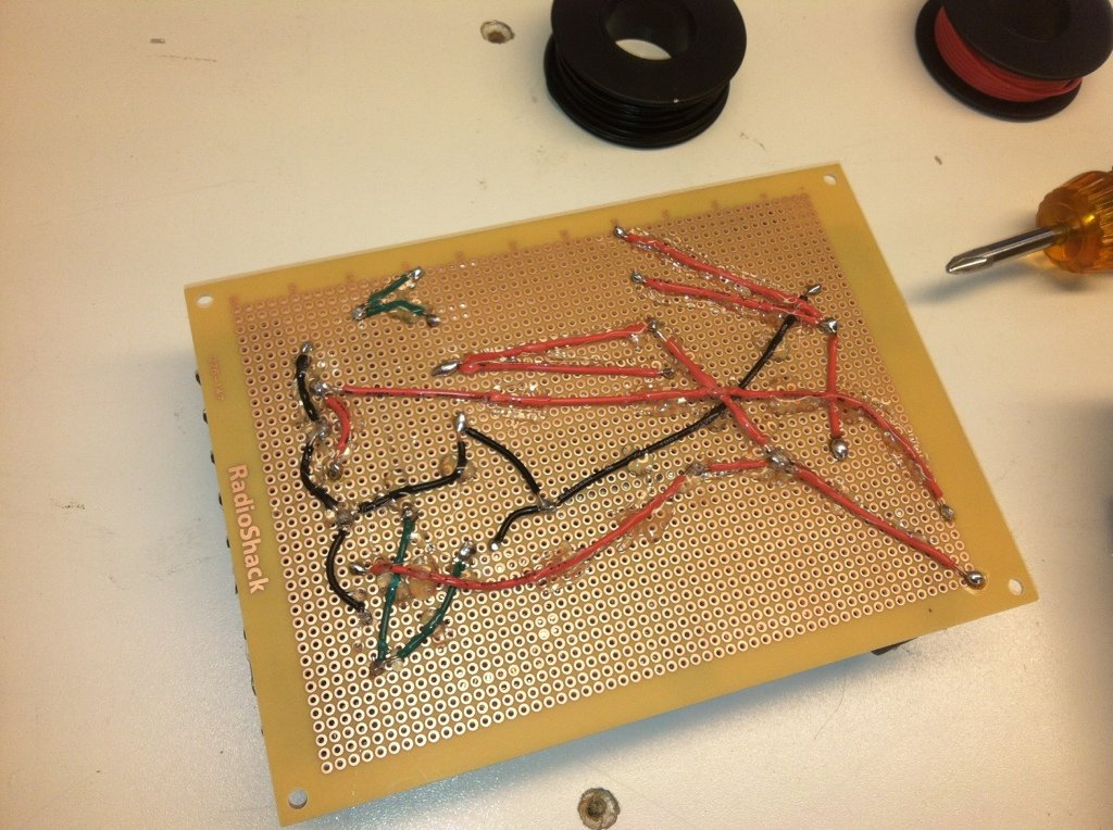

    A84C85E7-EA8D-402E-B07A-966878C7B1C4-945_dd08c4a78d43257f7250dee5529cbd3d18d75ce3.jpg
    351B33C9-552D-4F65-955A-9C4DA6D1DC98-945_8b69e43985ea489c7bbc8f500e9145b085a7cc58.jpg
    BCCFC3DD-B561-49A2-9534-6D027B60E2C0-945_8cd379c87b13b25114d8e011d030d7b20a9a22aa.jpg
    Some more pictures of the crossover building process. Finished the second one today and did some testing off of my Hertz EP4X from my truck. These things can get pretty loud! There's definitely room for improvement in sound quality, though. Most people would be perfectly satisfied, but I can pick out a few nasty dips and peaks. I'll reserve my judgement for when I hear the final product, though.

    Make sure you dampen the rear wall a good bit. That will kill some of the reflections that would bounce off the rear and re-enter the cone and cause distortion.

    Per the recommendation in the speaker design website, each compartment (containing 2 mids each, will be stuffed with 1lb of poly fill. Do you think that will be sufficient?

    That's probably fine. It should help even things out a bit. Just don't leave them empty! :D

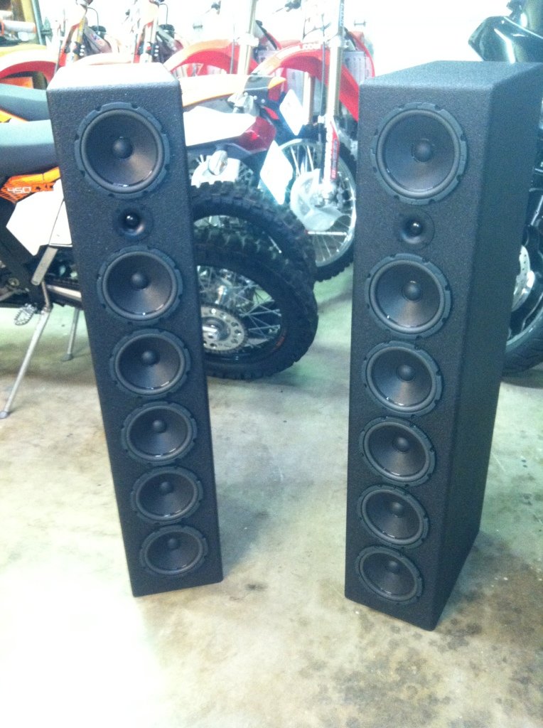

    I finally finished my line arrays! They are LOUD and sound pretty damn good! They really do need to be paired up with a good sub box to compliment their volume since they drop off around 50-60hz. I didn't get to spend much time listening to them yet. I played a few songs including some slayer which was AWESOME to hear at that volume.
    Of course, I had to play gangam style on them for the video :D
