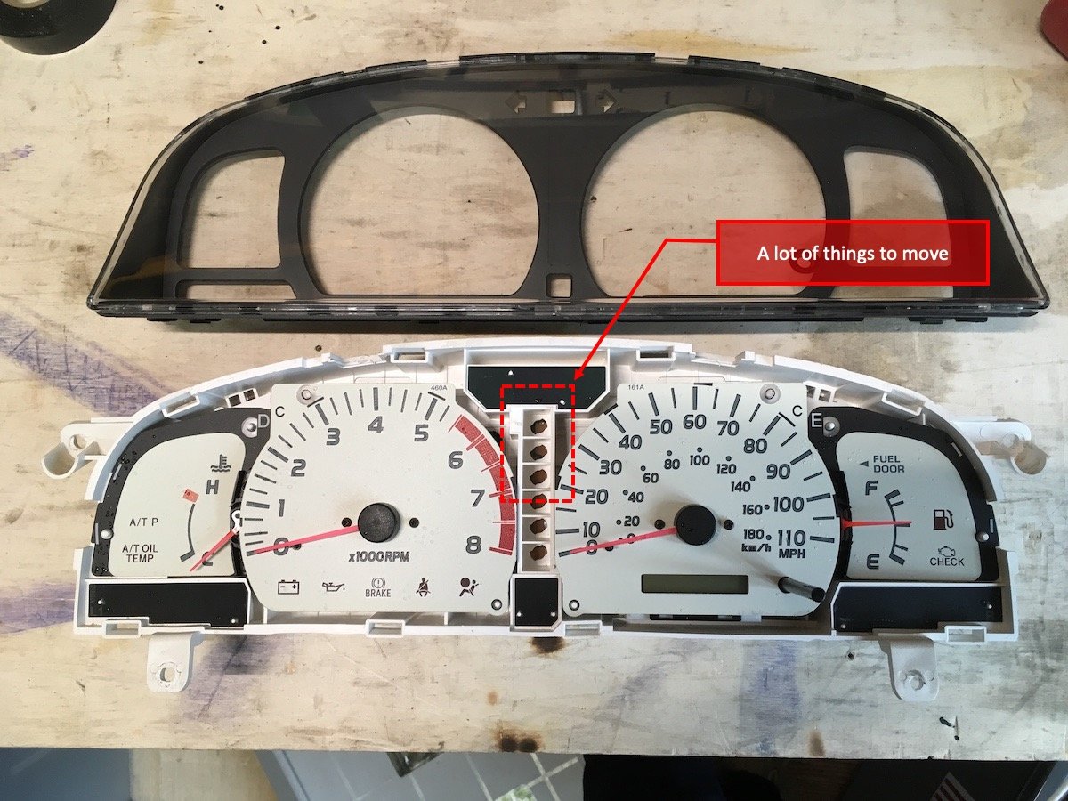

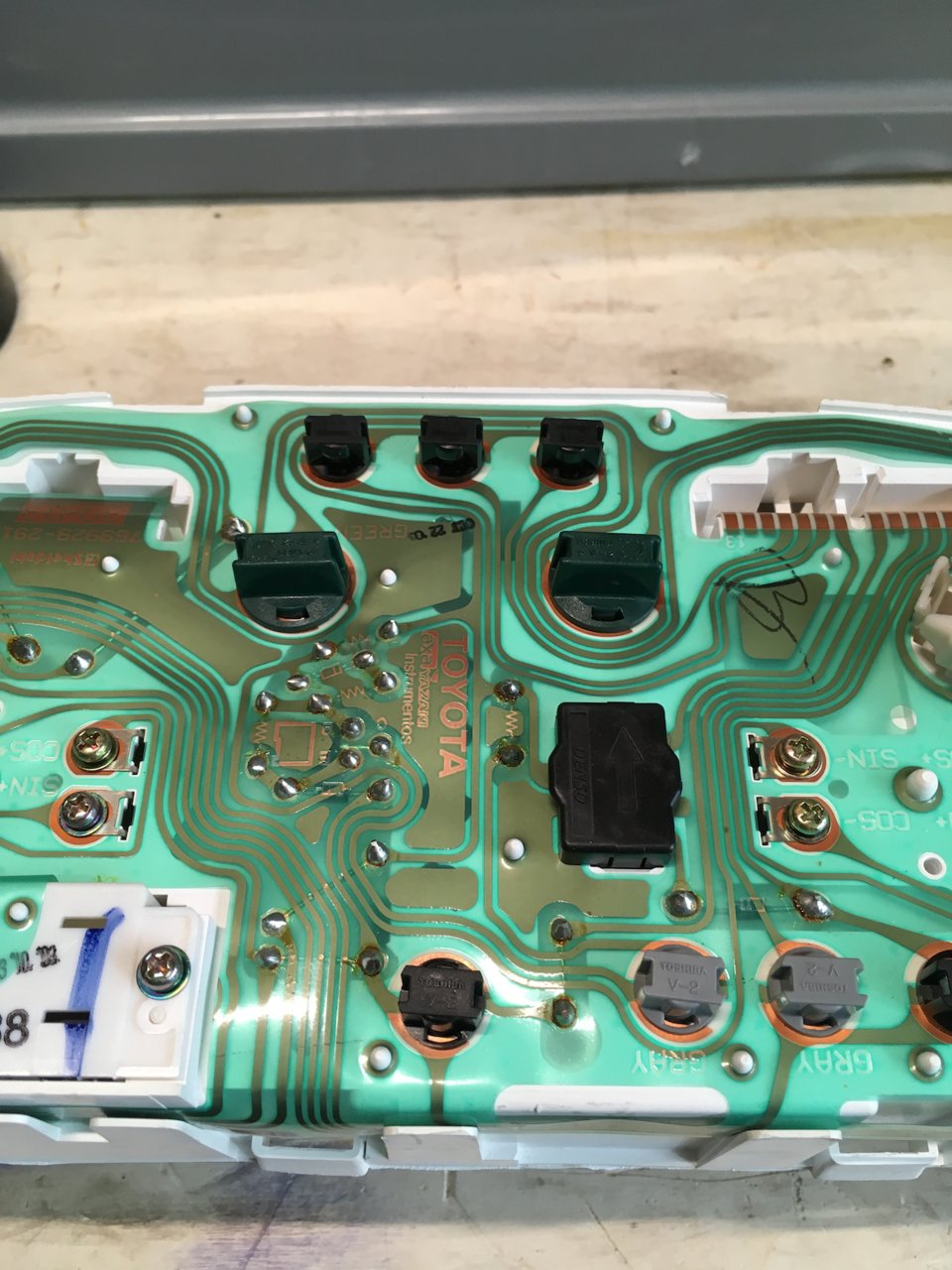

    @Cattywampus. Do you think it’d have been possible to somehow combine the 4Runner cluster internals and things into the Tacoma cluster? That way you’d keep the gauge in the dash like 4Runner but I’d also look stock at the same time
  11. Apr 3, 2023 at 4:06 PM
    #31
    Cattywampus
    Cattywampus [OP] Splitter of CV Boots
    Nov 7, 2017
    #235284
    309
    Mark
    Colorado
    '03 Tacoma DC TRD OR
    I suppose it is possible, but it would require alot of modification. I have added additional indicators to the Tacoma's cluster already (see here and there), and the space is crowded. It would require a lot of modification to make it work. The biggest challenge would be fitting between the tach, speedometer, and the turn signal/brights indicators. You might be able to route wires under the circuit board that operates the cluster, as it is flexible like a plastic sheet. But you might need to relocate some circuits too.
    I did briefly consider swapping in the 4Runner's entire instrument cluster assembly, but the wiring is vastly different between the two.
