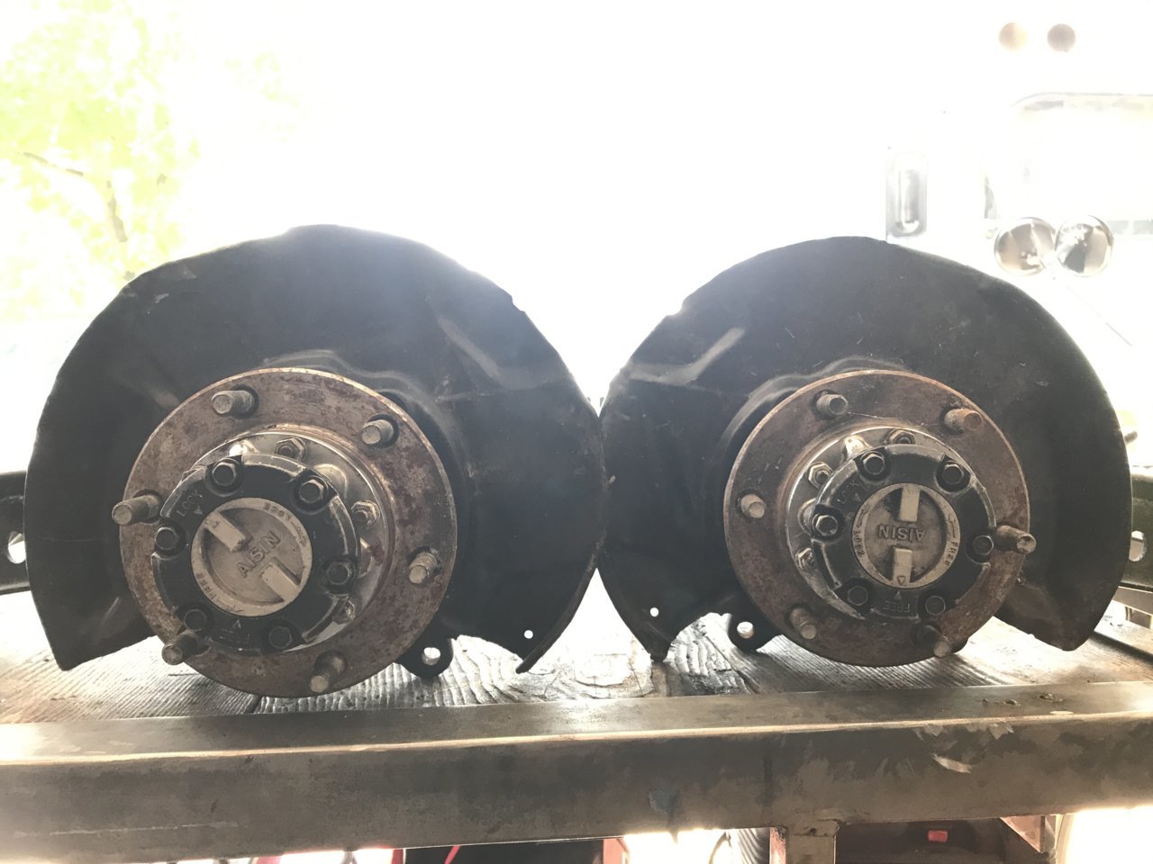

    Non rotating cv’s while in 2wd, and ease of trail repair when a cv breaks.

    You break a cv then you just set the hub to free and you can drive and still have 3wd
    And you could either drive out and repair or just get your self to a decent location

    Few updates:
    Solved the p0171, previous owner striped the MAF sensor screws so I only had access to clean the main sensor. So I took a dremel to the screw heads and made grooves for a flat head and was able to get them out. The two sensors inside the MAF were dirty as fuck which was throwing the code. Just cleaned them up and I’m good to go.
    Also installed the new manual hub assembly/total chaos spindle and cv’s took to a test drive and everything feels great, except one issue. The spindle inserts are not getting an interference fit more here

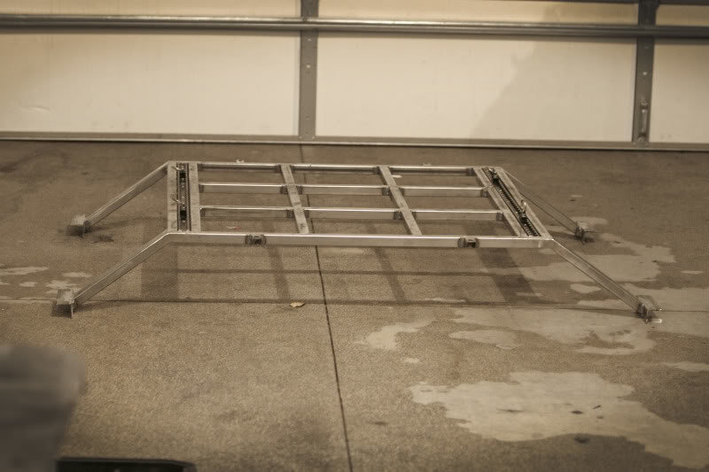

    Did a little research so here’s what I’m thinking
    This might work

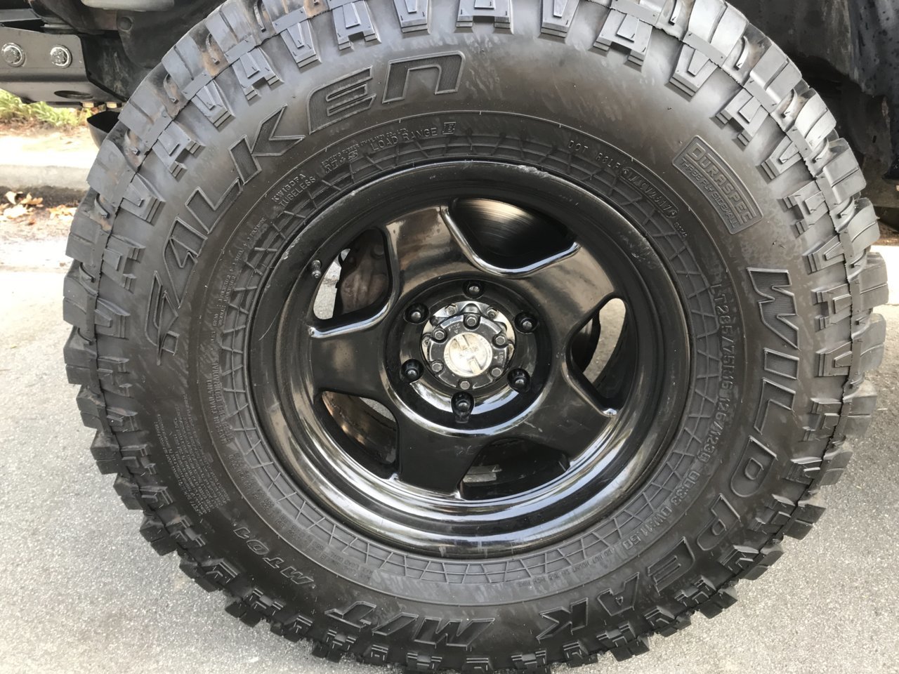

  20. Oct 13, 2018 at 12:58 PM
    #200
    MY1STGENTACO
    MY1STGENTACO Well-Known Member
    Sep 5, 2018
    #265272
    364
    MORA
    NEW MEXICO
    2001 Toyota Tacoma
    OME 3" LIFT 882'S NITROCHARGERS ALL AROUND

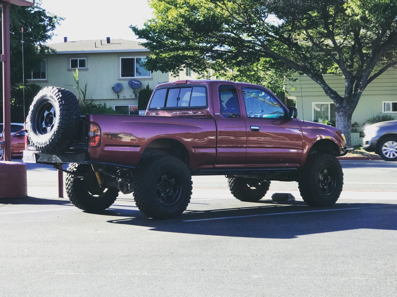

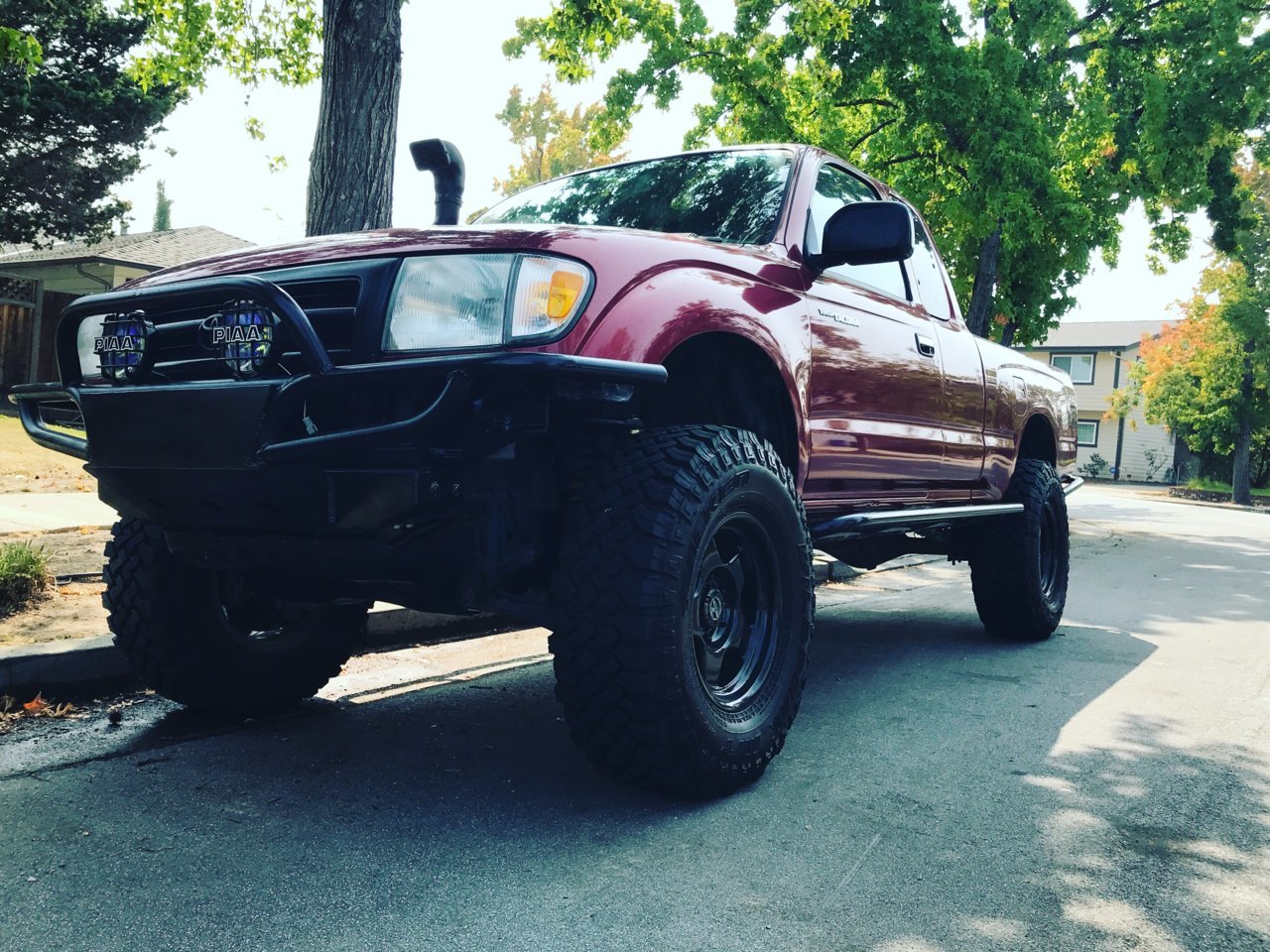

    Nice tires and wheels. Are those 33” ? What’s the width, 11.5” ?
