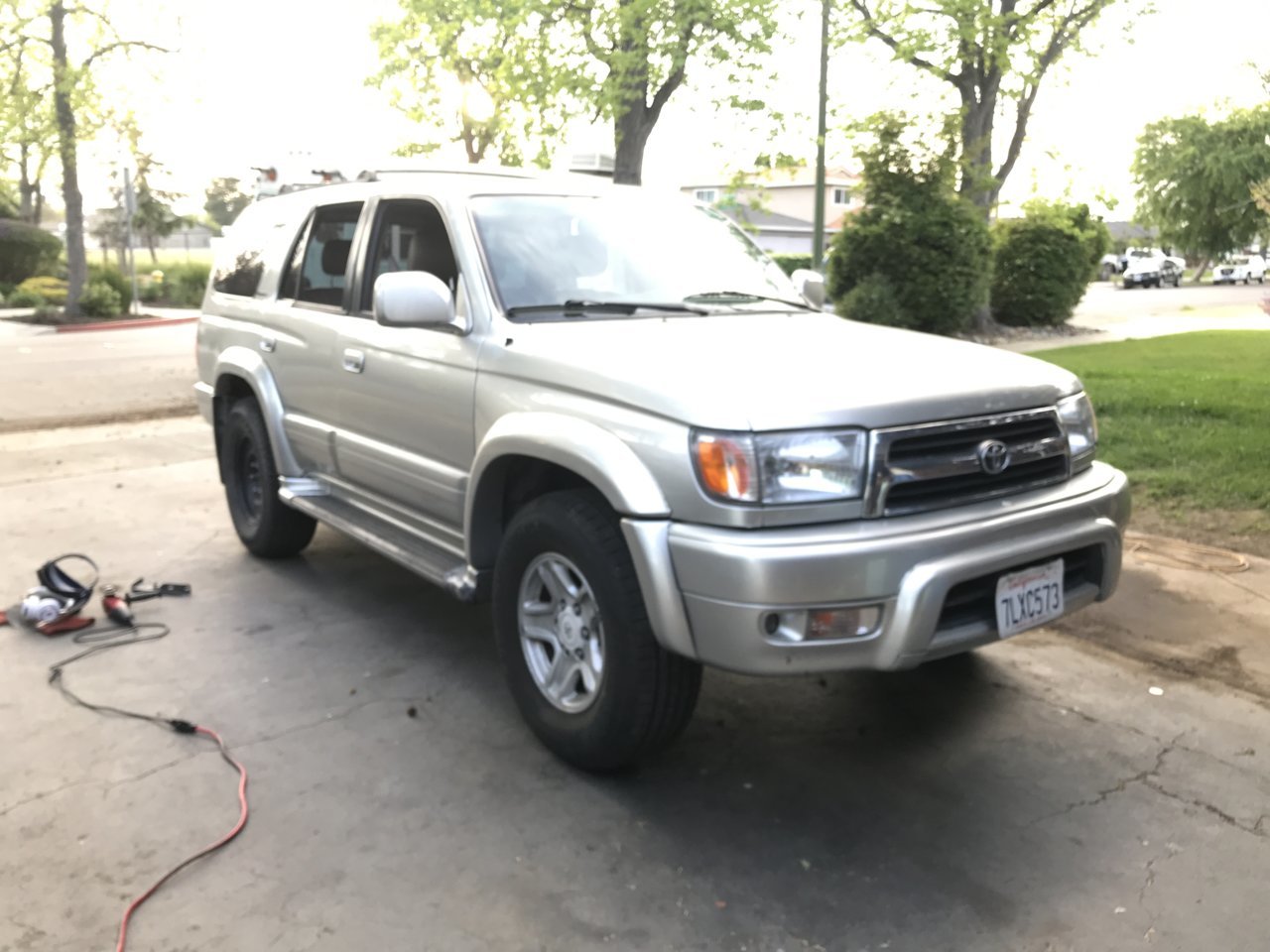

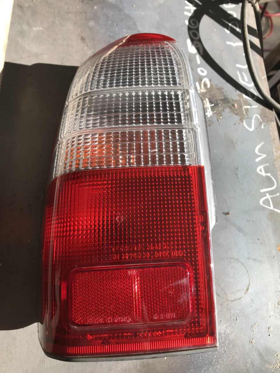

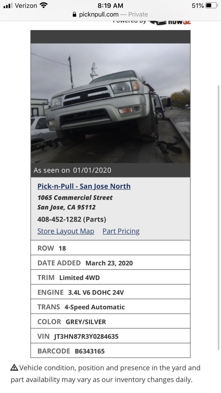

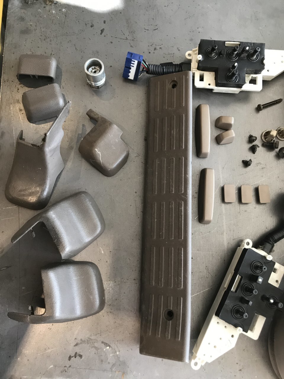

    Wow what are the chances, same 4runner is at the junkyard and had power seats!
    Was able to get all the missing/broken clips, covers, switch controllers and a tail light.
    D28544DE-96E7-4A8A-AD36-933AB720104E.jpg F652C638-D389-403C-8763-AFD3BCA902C0.jpg 14EDDAB4-7786-47FC-94F9-B93FEDC44C29.jpg
    Wife went to town and swapped everything in and removed one running board. (Looks a lot better with out the running board) oh and the other running board is tacked on WTF hahah:sawzall:
    Going back for some more goodies tomorrow.

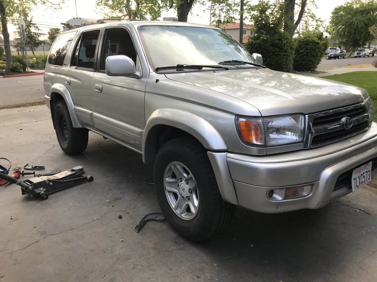

    Cleaned the carpets and removed the running boards.
    FC55341F-5029-4485-91A6-F05EB8C157F6.jpg D7E17F84-D024-49CE-8E38-FEF559D879C8.jpg

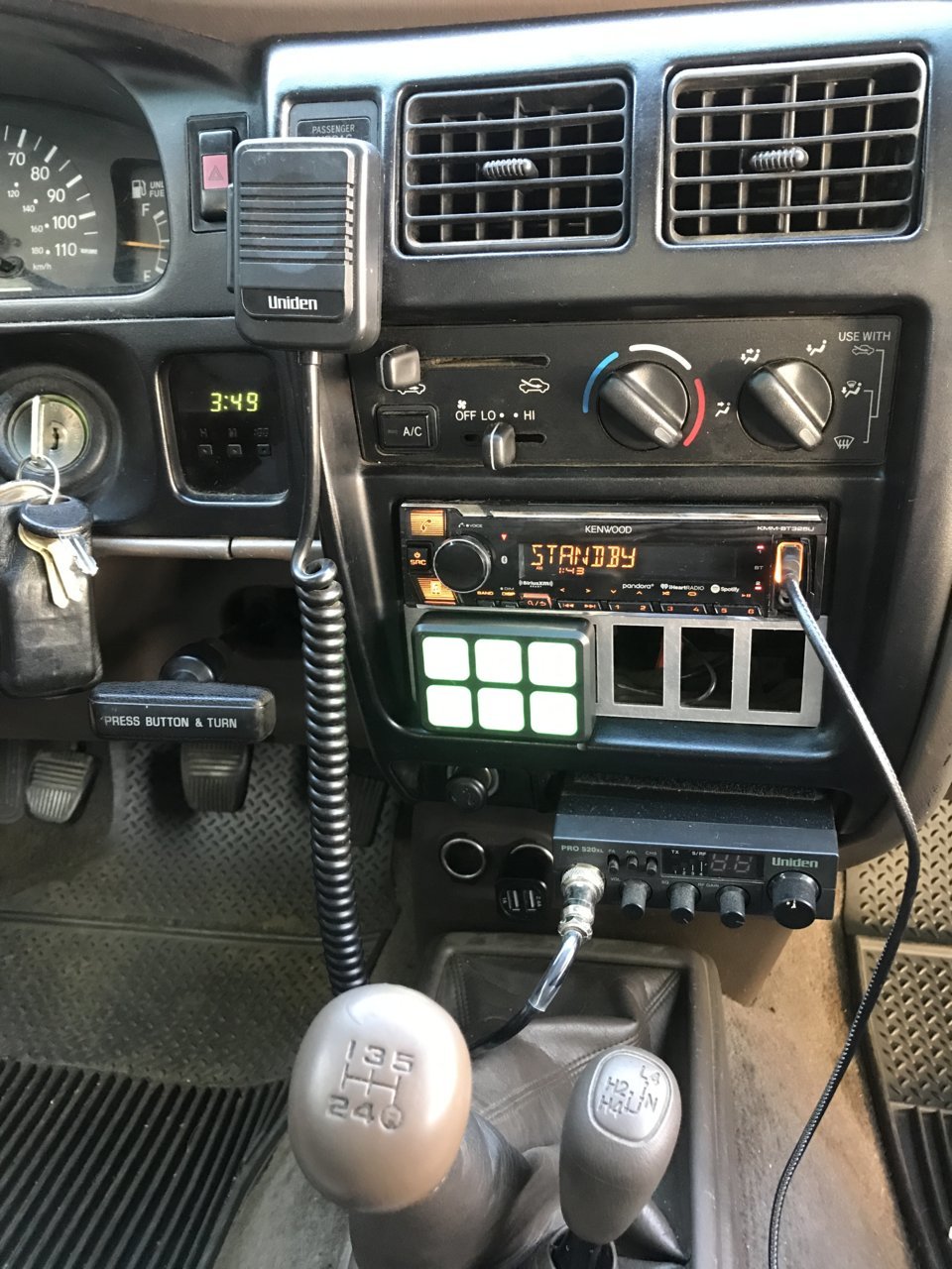

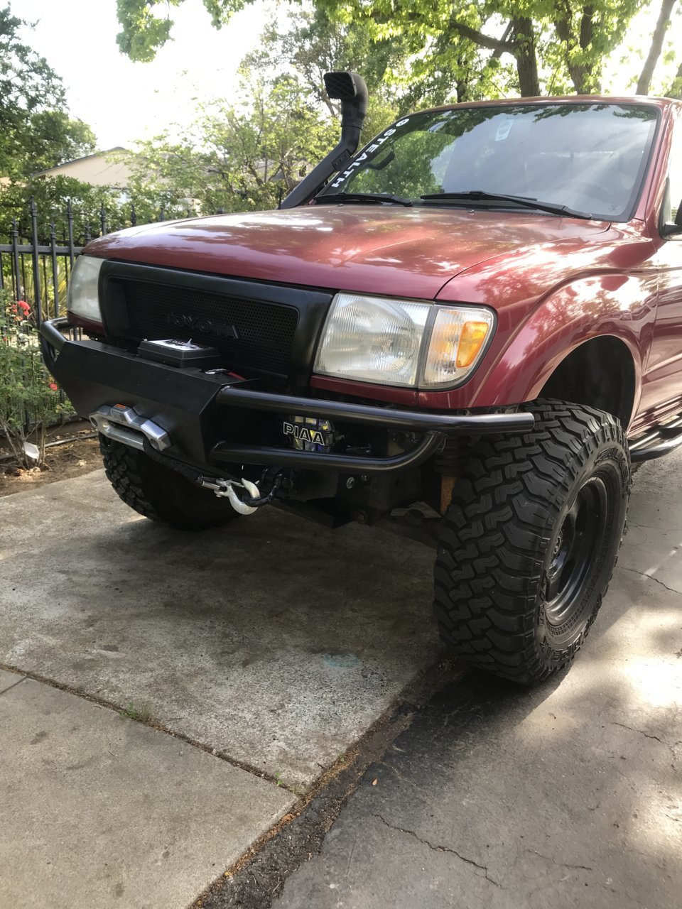

    So pushing off the bump stops for a later date, but still productive this weekend.

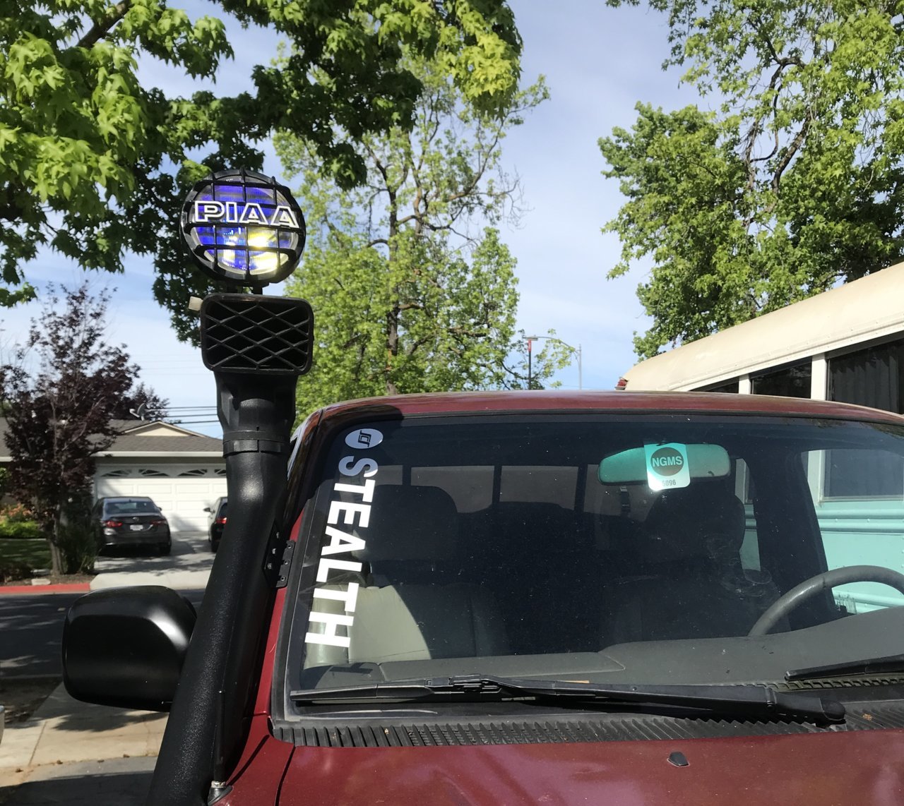

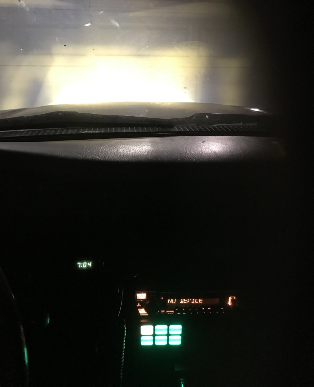

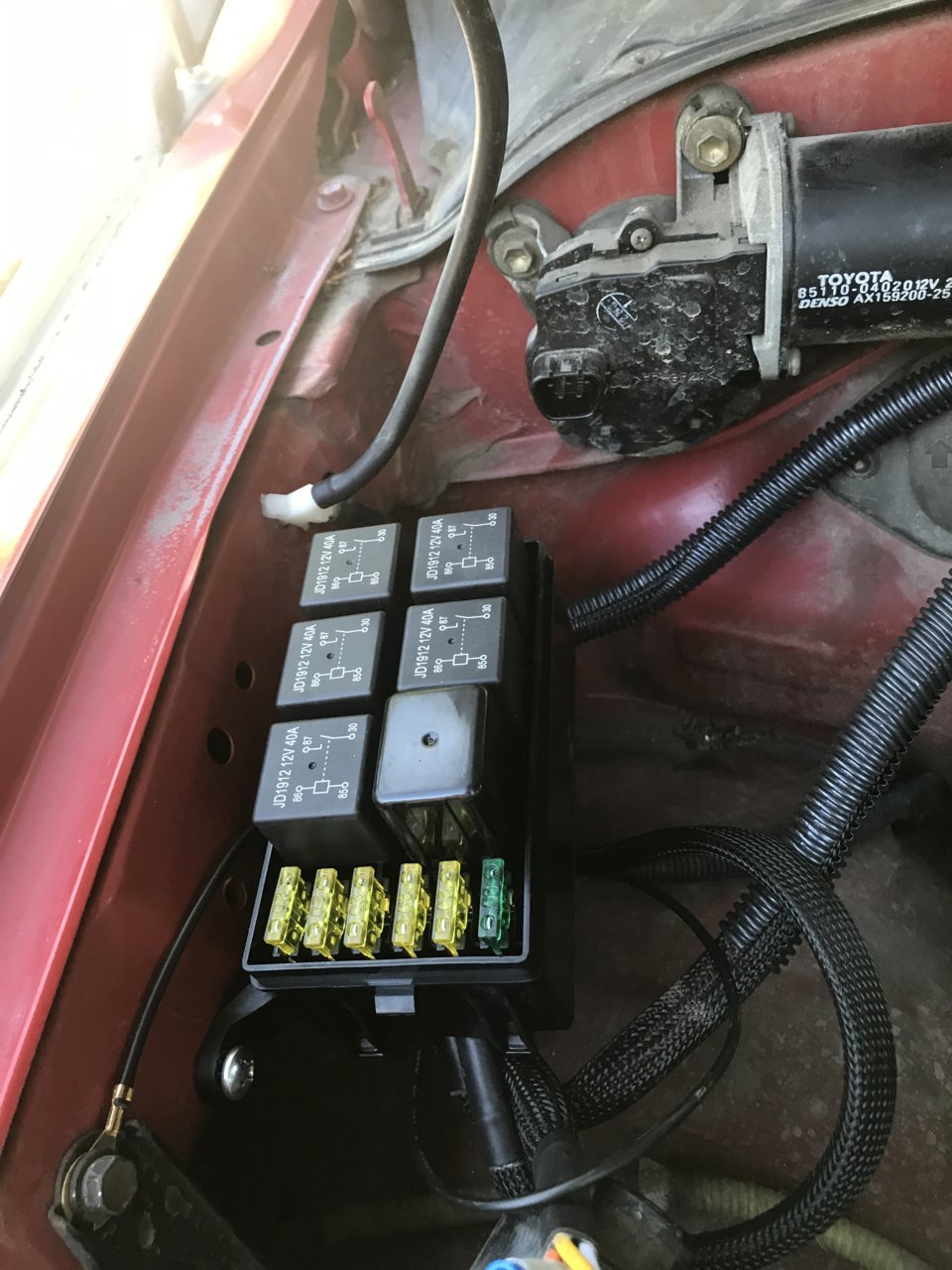

    Installed the 6 switch relay setup and added a circuit breaker near the battery. Hooked up a set of Piaa’s and tested them and everything worked gouda. Just need to figure out where to mount everything. As you can tell I was originally looking at getting the carling switches, might end up swapping them in we’ll see. D6F07A7C-83FC-413A-970C-EDB274E822FA.jpg 0BA3F5E4-FA63-42D8-AE7A-87E917901390.jpg
    And the 4Runner tires are on and fixed the leaky sunroof.

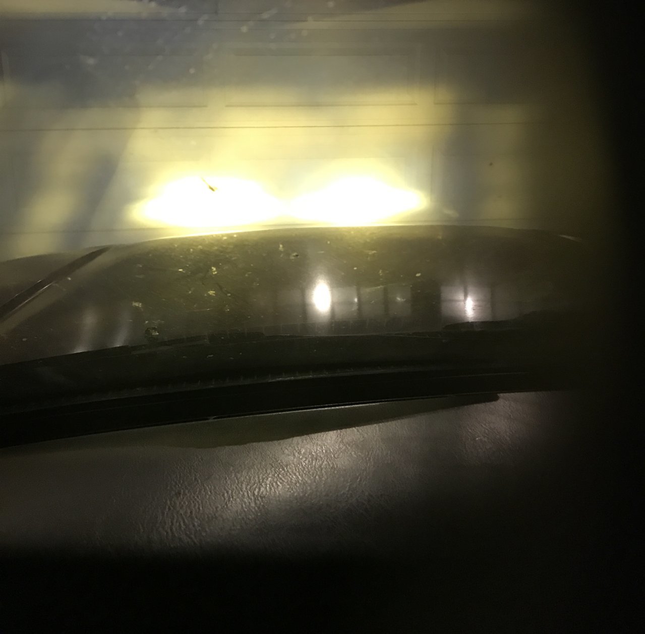

    Getting the lights set up.
    A1409F52-2957-409A-9C26-99541F6F8603.jpg 3A24F8B8-A212-4E79-B107-6F3D63A4F774.jpg 1EEA79B4-386B-4420-B00A-678FB4963FEA.jpg 627E41AF-C8C5-49DB-9DCC-B256BD405255.jpg

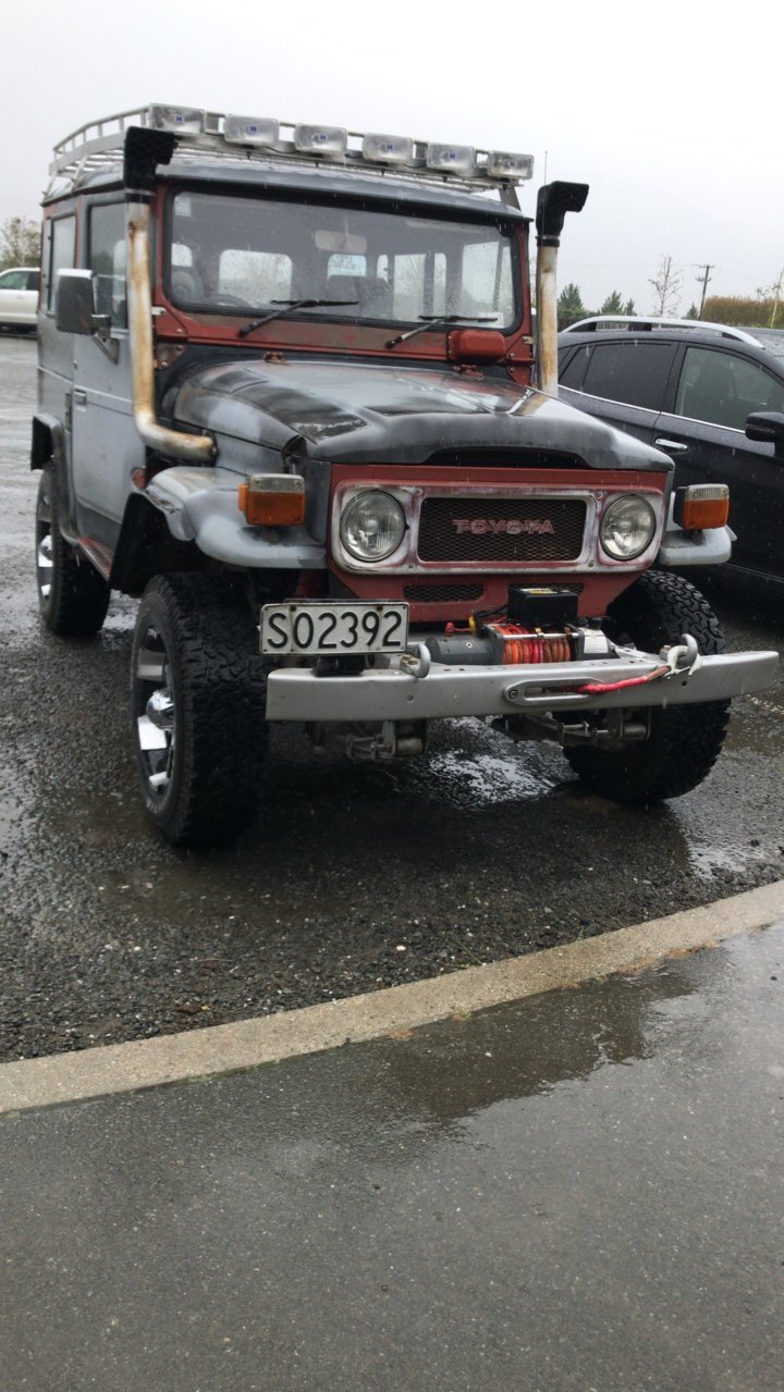

    They have the best camper vans in NZ & Australia, and of course the South Island rocks..

    I’d go back in a heart beat, only downside is those dam those sand flies!

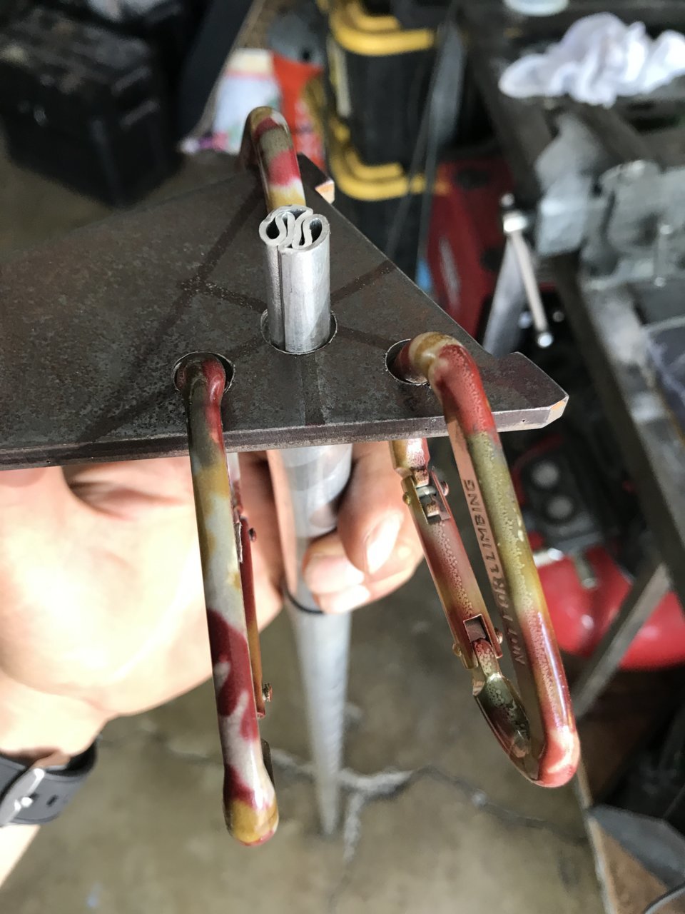

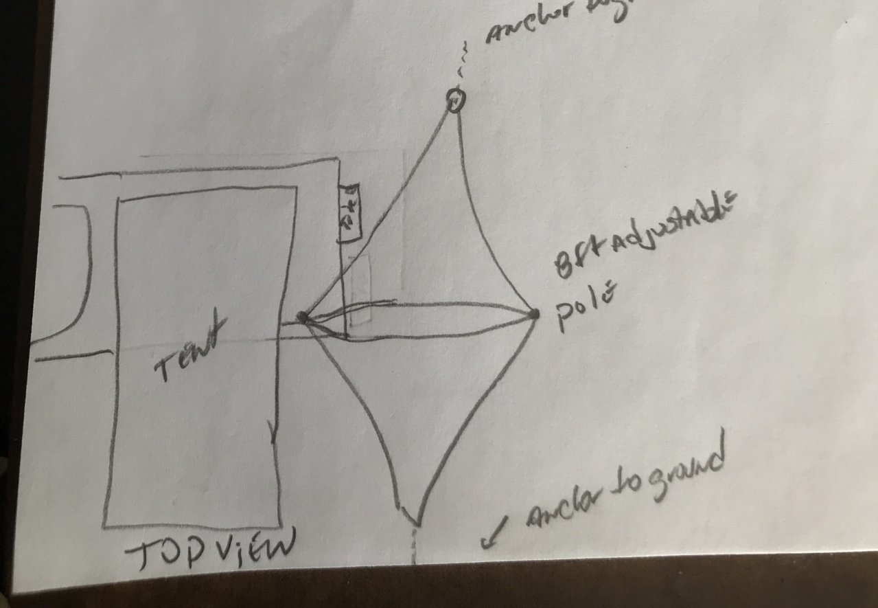

    I like the concept as I am running a low pro rack and i don’t want to run the standard awning but still want shade.
    But like usual, wanted to do something a little different.
    Purchased two triangles
    Sekey 10'x10' x10' Triangle Sun Shade Sail PES Polyester Canopy Waterproof UV Block Weather Resistant Durable, Big Shadow, Perfect for Outdoor Patio Garden Yard Backyard, Dark Grey https://www.amazon.com/dp/B07TLJ2MQL/ref=cm_sw_r_cp_api_i_p77QEbC8EH4BZ
    And 1 telescoping tent pole
    Stansport Telescoping Tent Pole https://www.amazon.com/dp/B004Z10D16/ref=cm_sw_r_cp_api_i_O87QEbFJPW657
    Paracord for tie down lines, heavy duty tent stakes.
    This should be interesting.

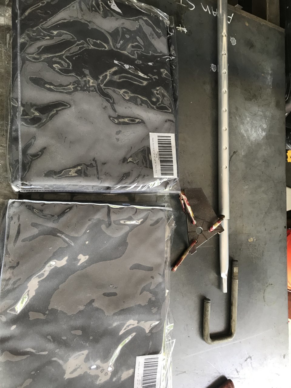

    Here it is the new awning tarp system concept
    still need to finish cutting the scrap into a triangle. Cutting the corner off the old u bolt and using it as the bedrack mounting point.
    also moving to a new driveway losing the garage....and getting a basement. Spotted a new neighbor with a built 1st gen too

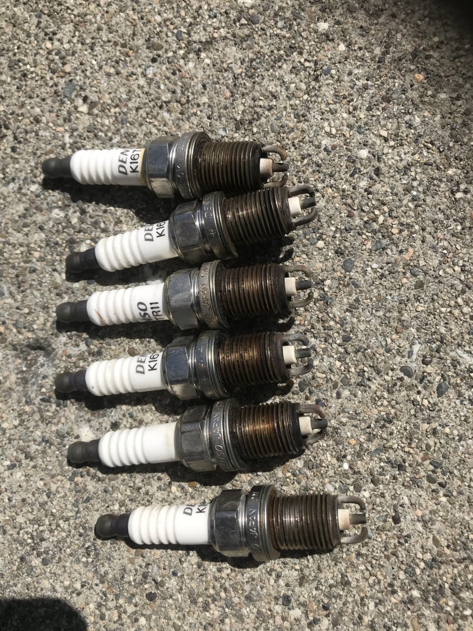

    Been chasing bogged down acceleration on the 4runner. Typical scenario:
    come to stop at a stop sign, skinny pedal then 2000-2500 RPM then stumble, with no acceleration Traveling at constant velocity approx 15-20mph, push little harder on the gas pedal and nothing But a slight increase in RPM but get a backfire. Eventually it just goes away. No real pattern other than it occurs from the stopped position to acceleration.
    Happens periodically.
    So far cleaned the throttle body changed all the associated gaskets and checked the tps mechanism. Cleaned MAF. Adjusted accelerator cable. No crazy corrosion around the o2 sensors and wires looks new.
    With no CEL it could be a few things plan was to do plugs, wires and coils. Parts were on order.
    But today my wife almost got stranded after the 4runner couldn’t accelerate and shut down, still not F’in code. A simple, turning the 4runner off and turn back on got her to a friends house(the desitation). I got the call and said fuck it. Canceled the online order, Got my tools together, Rosie puppy and picked up NGK plugs,wires, coils packs.
    After I got to the 4runner, drove it around for 30mins had my scanner in hand, it bogged down! Waiting.... waiting.... still no F’in code after 10 minutes, no code and then magically I can hear the proper idle ahah.
    Pissed I park the runner near the truck and get to work.
    The spark plugs have seen better days.
    With the maintenance done, the test drive was great! But question is does it solve the problem??
    Nope, about an hour later took the 4runner for another test drive and it bogged down. But Finally got P0172 and
    P1130 TOYOTA - Air/Fuel Ratio Sensor Circuit Range/Performance Malfunction Bank 1 Sensor 1.
