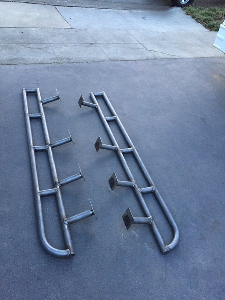

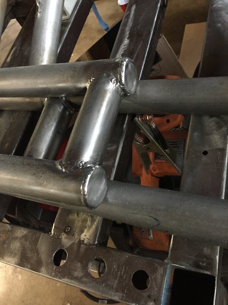

    Need some gussets, and some end caps

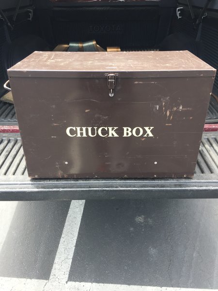

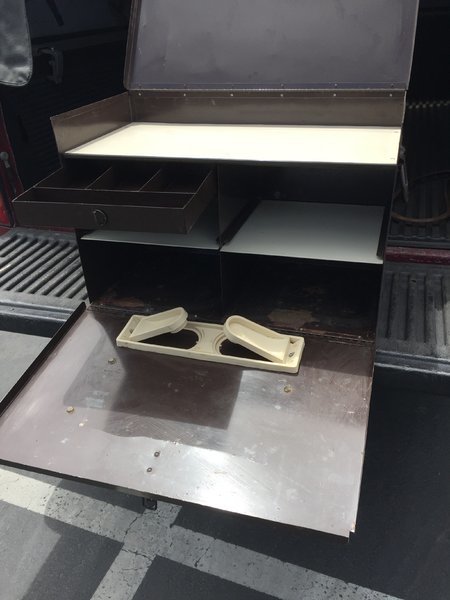

    Pick up this awesome camping organizer called the chuck box

    Cut out some end caps, and got them welded on. Also cut and tacked gussets.
    Just need to finish those welds and inspect and clean up!

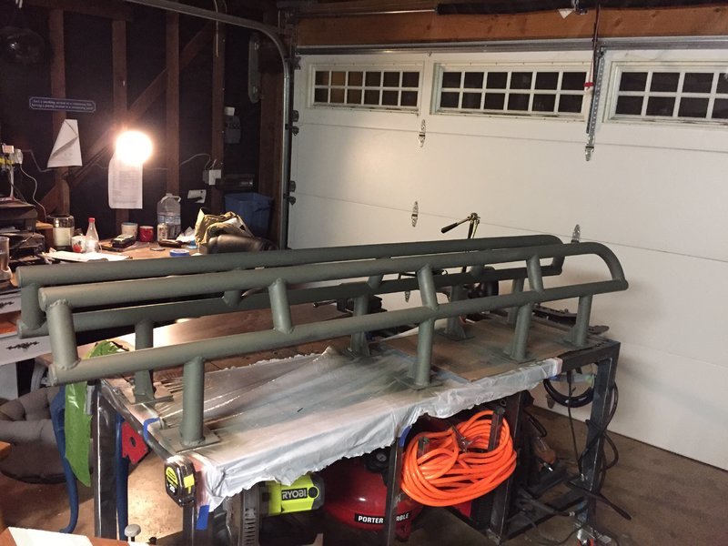

    Finished welding gussets, cleaned everything up, ran some acetone over them, and got a few coats of primer

    After another coat of primer then, BLACK!

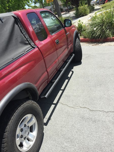

    Reviewing the sliders, things I would changed if I were to do again, squared tubing for the mounts and first rail and tubing on the kick outs. Reason, life would be easier with less notching allowing me to be more creative. I would have liked to utilzed the bender more. Overall I'm happy so far, I am going to add some kick ups its just a matter of time

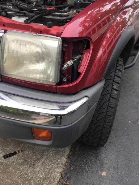

    Picked up a 4 by 4 sheet of 3/16 to begin the bumper build but first the blinker relocation

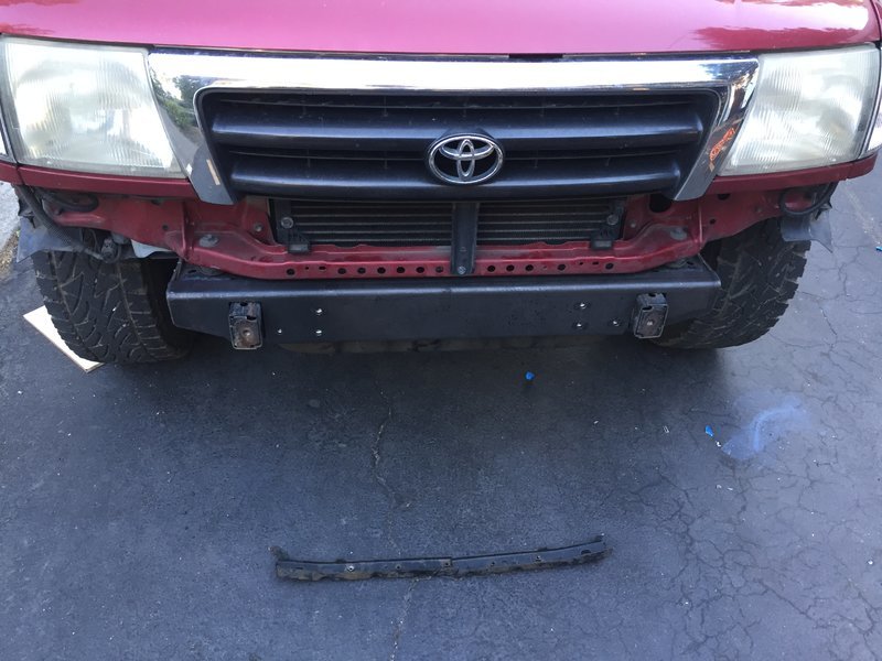

    Got the bumper mount on, had to cut off the bar (housing skid mount nuts )across the frame posts to get the correct fit. Ive seen people with cardboard designs and always wanted to try it out.
