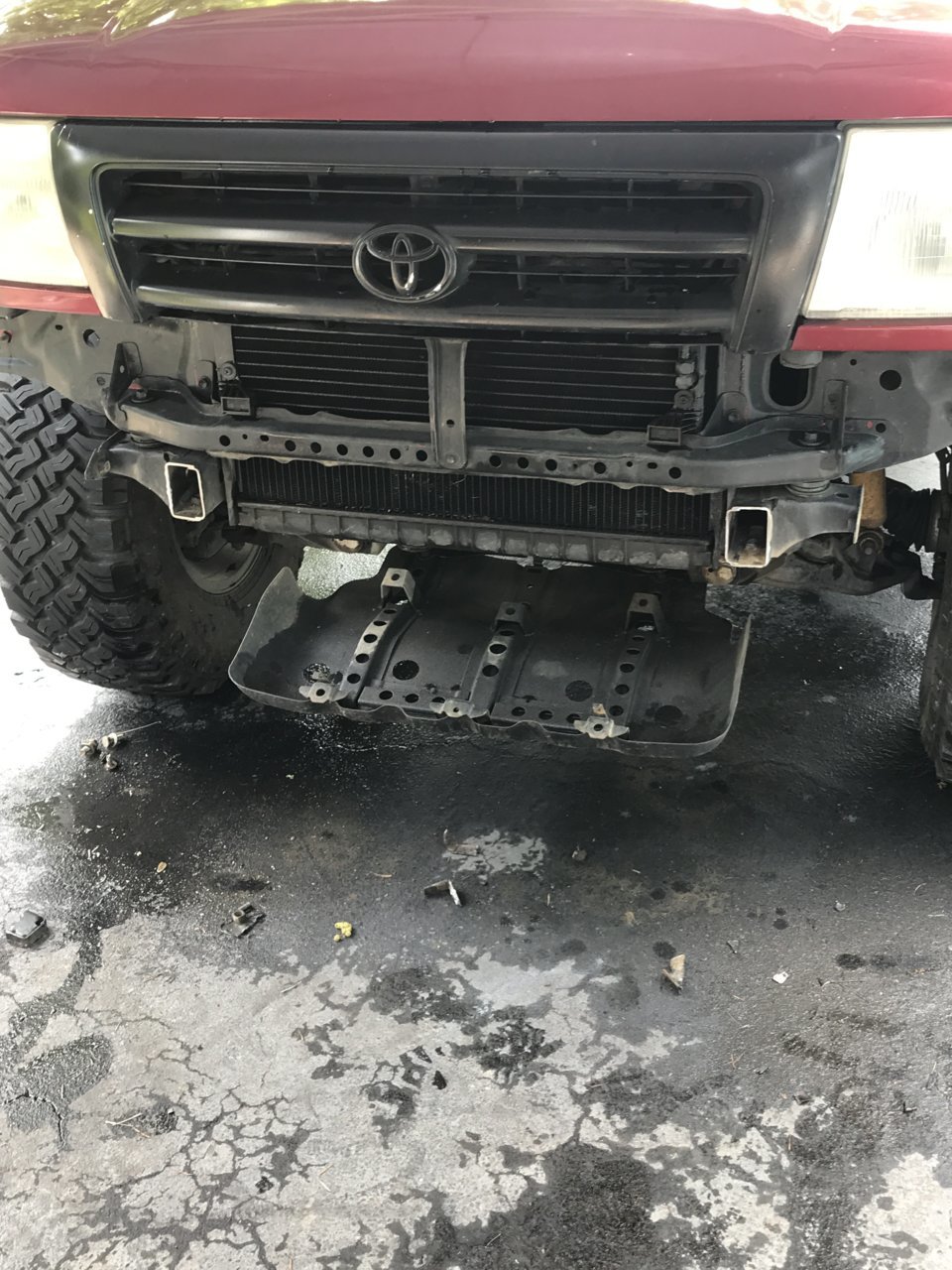

    I’ve seen these on the forum. And contempted using them but during recovery you’ll be applying a large load to the two bolts in shear and a lot of stress will be focus at the frame horn.
    http://www.4crawler.com/4x4/ForSale/DRingAnchor.shtml
    You’d be a lot safer with better bolts in tension, mounted at a place with a larger area. It’s just a suggestion.

    That makes sense. So, bolts that go all the way through the frame and out the other side and secured with nuts rather than bolts threaded into the captive nuts that are welded into the frame?

    The mounts I linked are threaded to the nuts welded but inside the frame. If I remember correctly the nuts are on the bottom inside of the frame.
    For recovery points it would be best to have them bolted or properly welded and reinforced on the bumper in tension, this also allows for the use all mounting points to the frame
    Edit: you mentioned bolts going completely through the frame, it would be a little better but it would still be in shear which is something you try to avoid

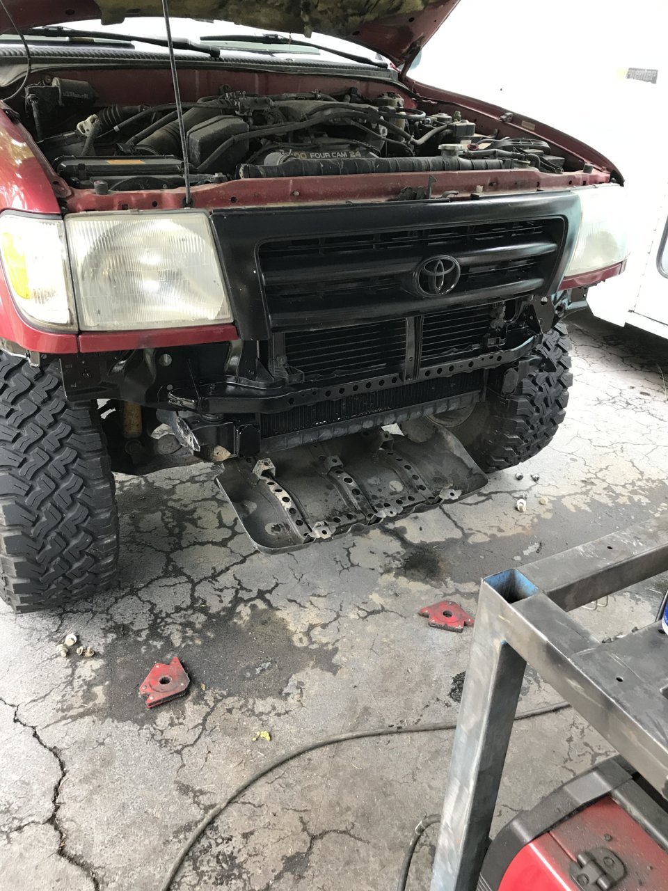

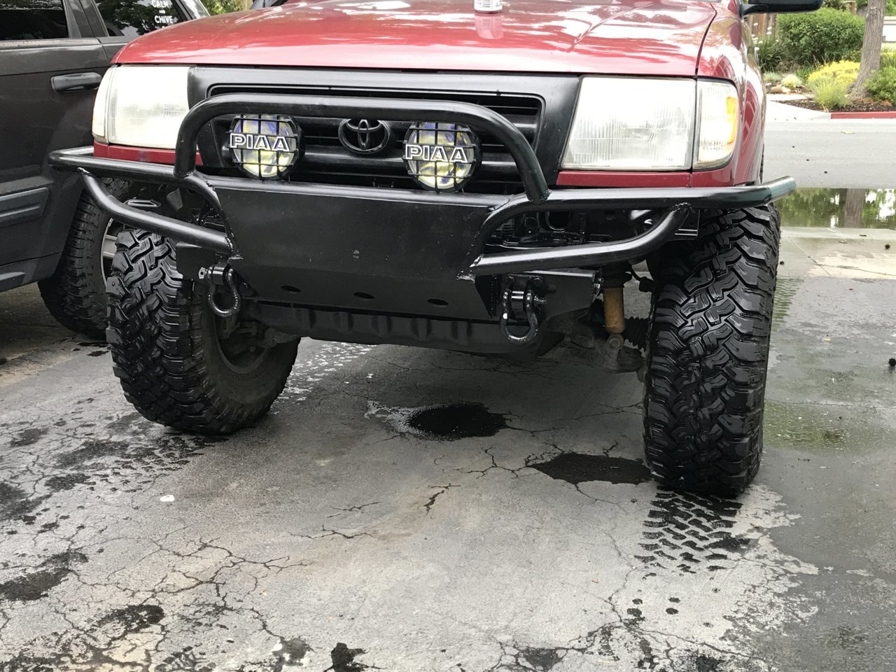

    Finalized recovery points for front bumper
    6533F683-C8F0-4E52-B8AE-C09B169072AD.jpg 29C3284A-312D-4E07-A982-94C63043E44D.jpg 5AC3044F-D049-4B68-B18F-F1C02EFBDD36.jpg

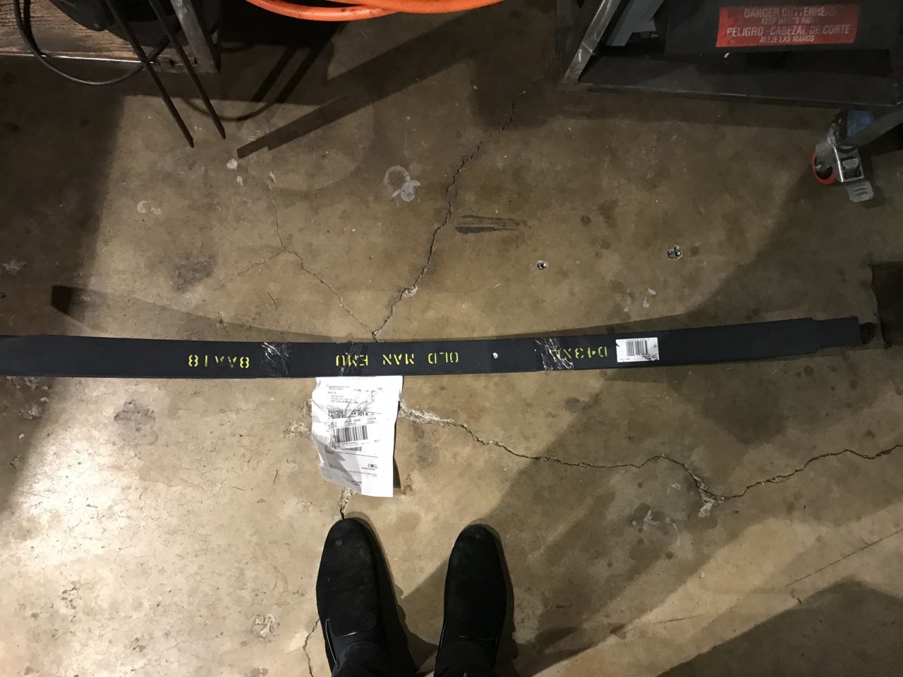

    So on the original install of the leaf pack I cut the top off the center pin to allow for the bumpstop to be mounted. Now I don’t have enough threads too add the leaf.
    Gotta order a new set of center pins I’ll up grade the bump stops while I’m at it.

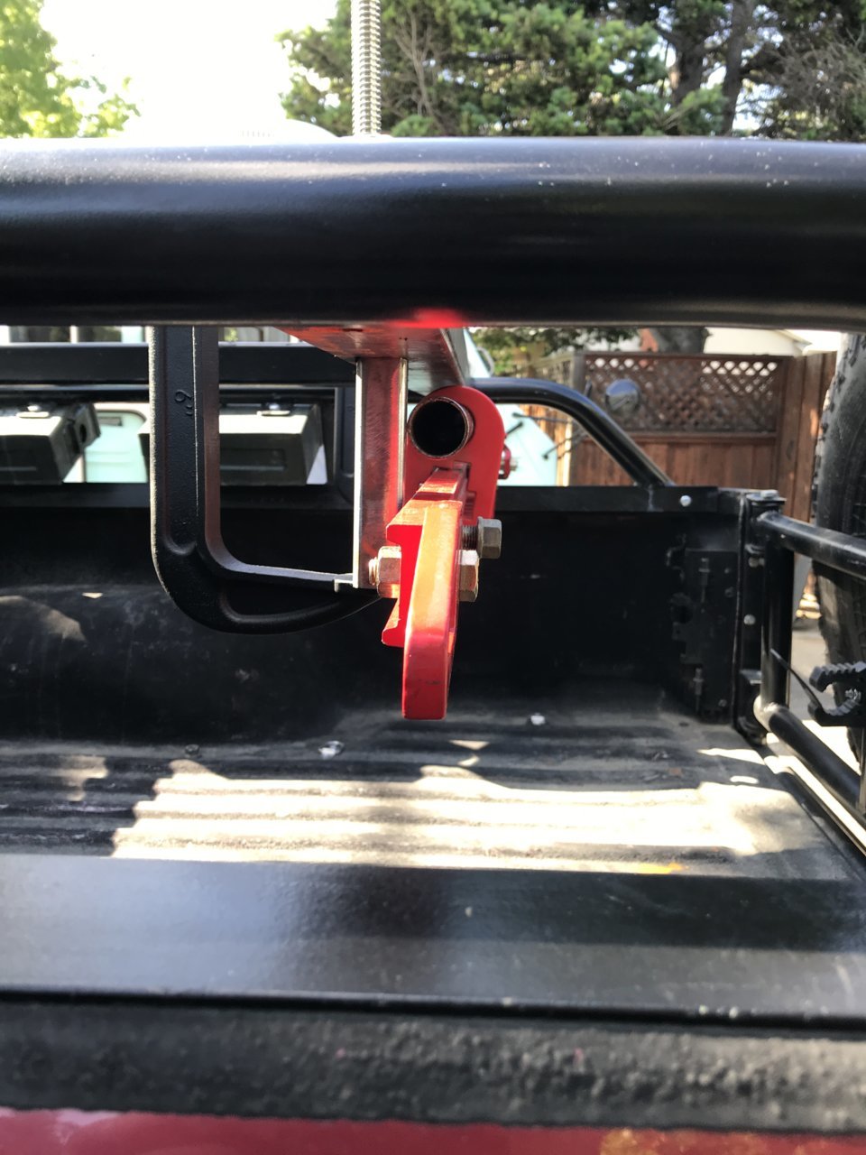

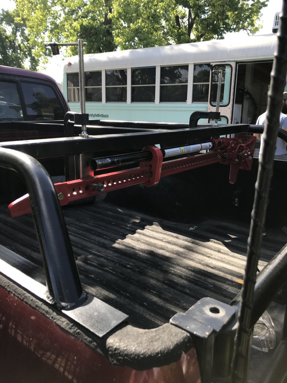

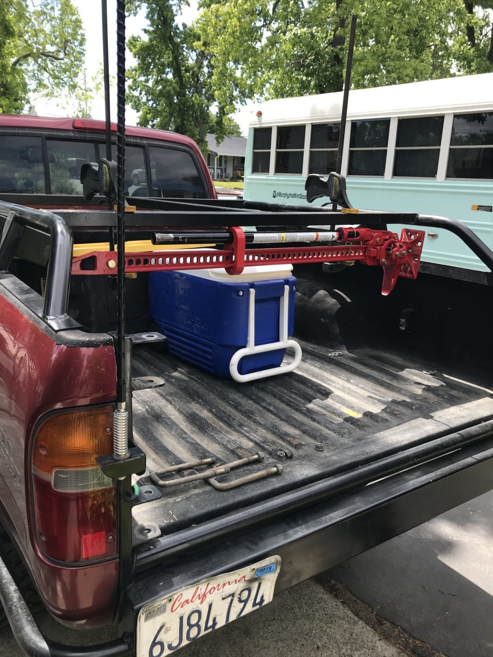

    After playing around with some hi lift mounting ideas, I took some scrap tubing and cut up my old U bolts
    Below is the general idea of how this will end up. Just gotta weld them in place.

    Did you mock up anything on the outside of your rack? I've found that space under the rack is premium space for gear, so try to keep from having things hang down there and block the top N inches. We all pack differently of course, so may not be an issue for you...
    Here's where I put mine: Hi-Lift on side of Bed Rack
    And here's where I needed more space under the rack: Eeking Out Another Inch Under the Bed Rack
