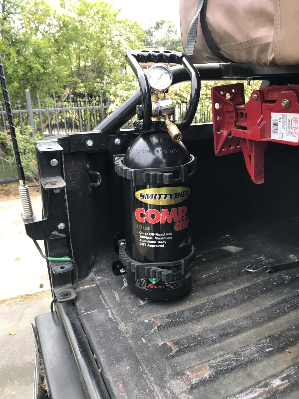

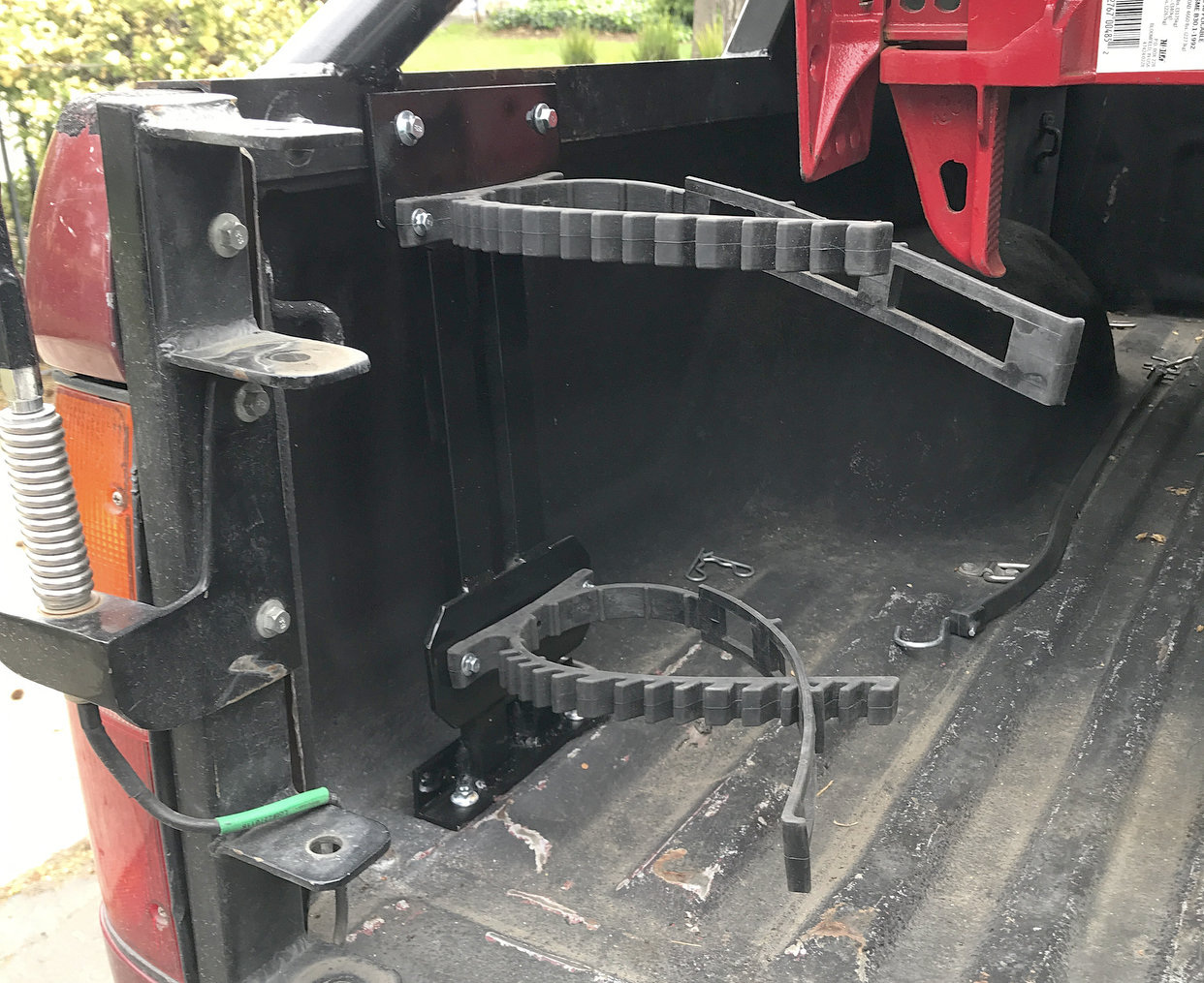

    Weather has been a bit rainy, which is slowing fab work down a bit. But working on the CO2 mount with some scrap metal I got laying around and a set of quick fists

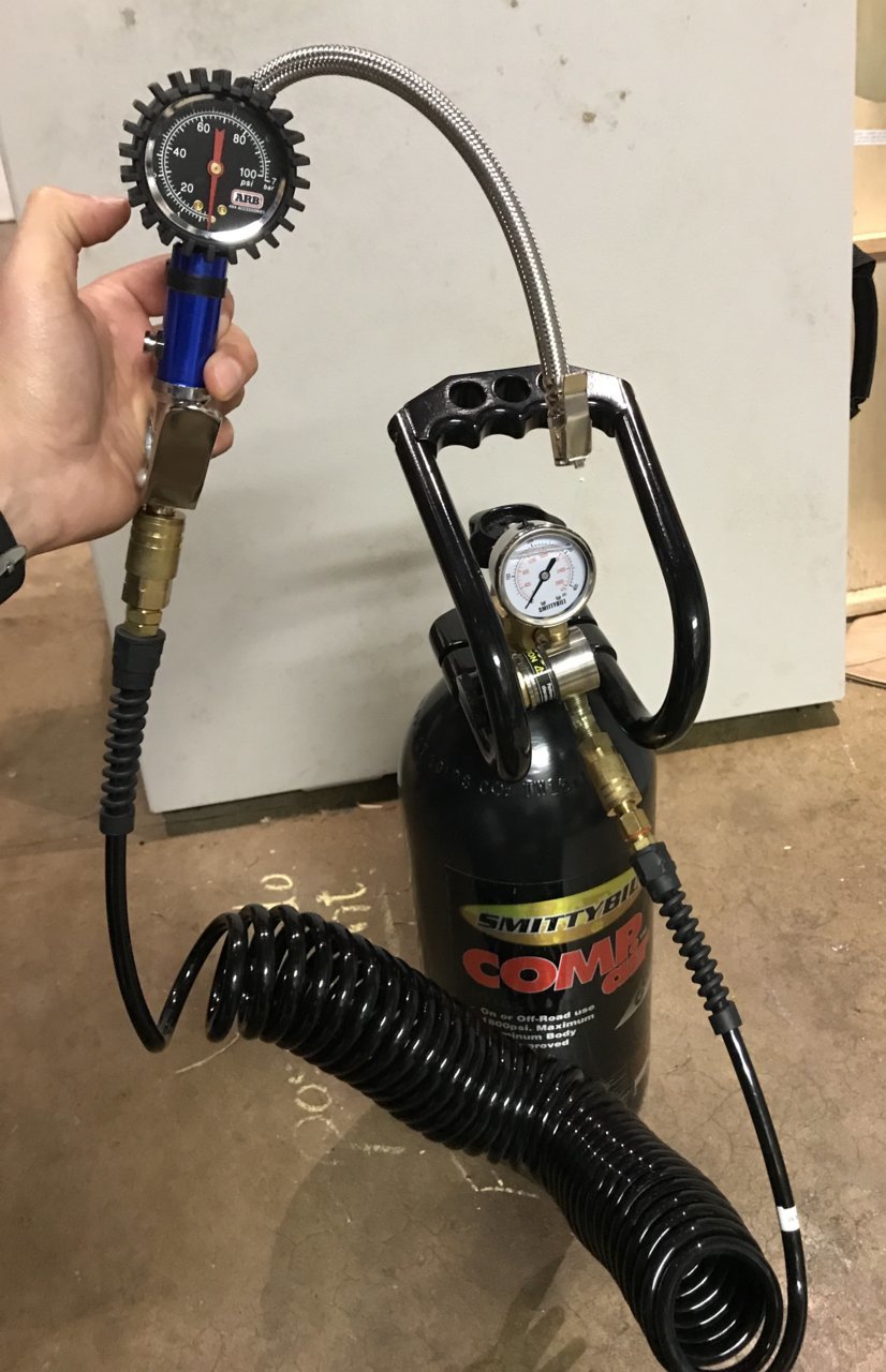

    Thanks to @theed and his garage sale, I was able to pick up an arb pressure gauge/inflator to complete the CO2 Setup.

    CO2 is so friggin fast!

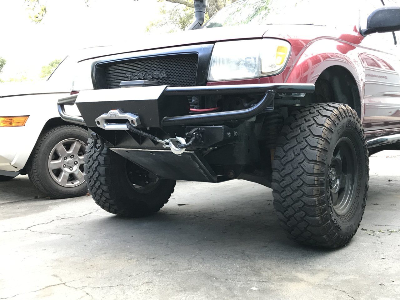

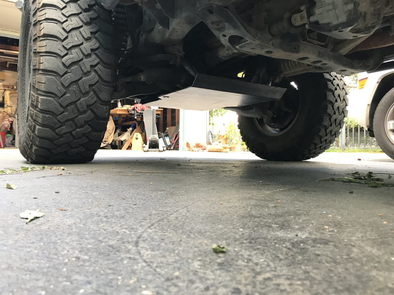

    '16 Silver AC TRD OR
    Enjoy! Nice looking setup too! (PS, for my $0.02, throw some gussets and ribs into that IFS skid - my first generation Mobtown 3/8" IFS skid - from before they started adding the reinforcements - has got some 3 or 4 pretty sizable dents in it and generally looks like a weird ruffle chip. I didn't even hit it that hard. ;) )

    thanks man! And thanks for the input, gussets are in my list of todos for the skid, along with a cut for oil changes and reinforcing bolting locations near near LCA’s.

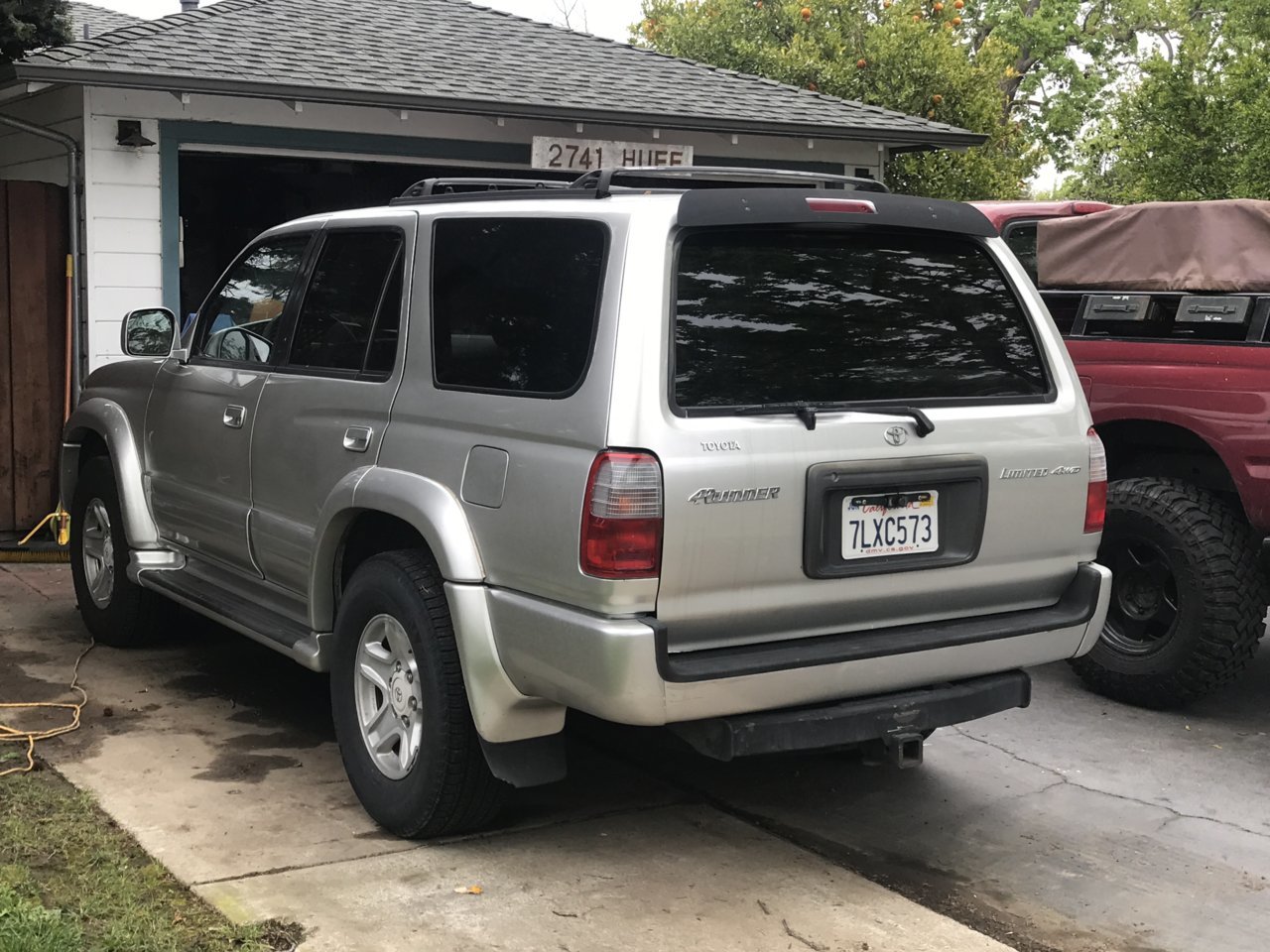

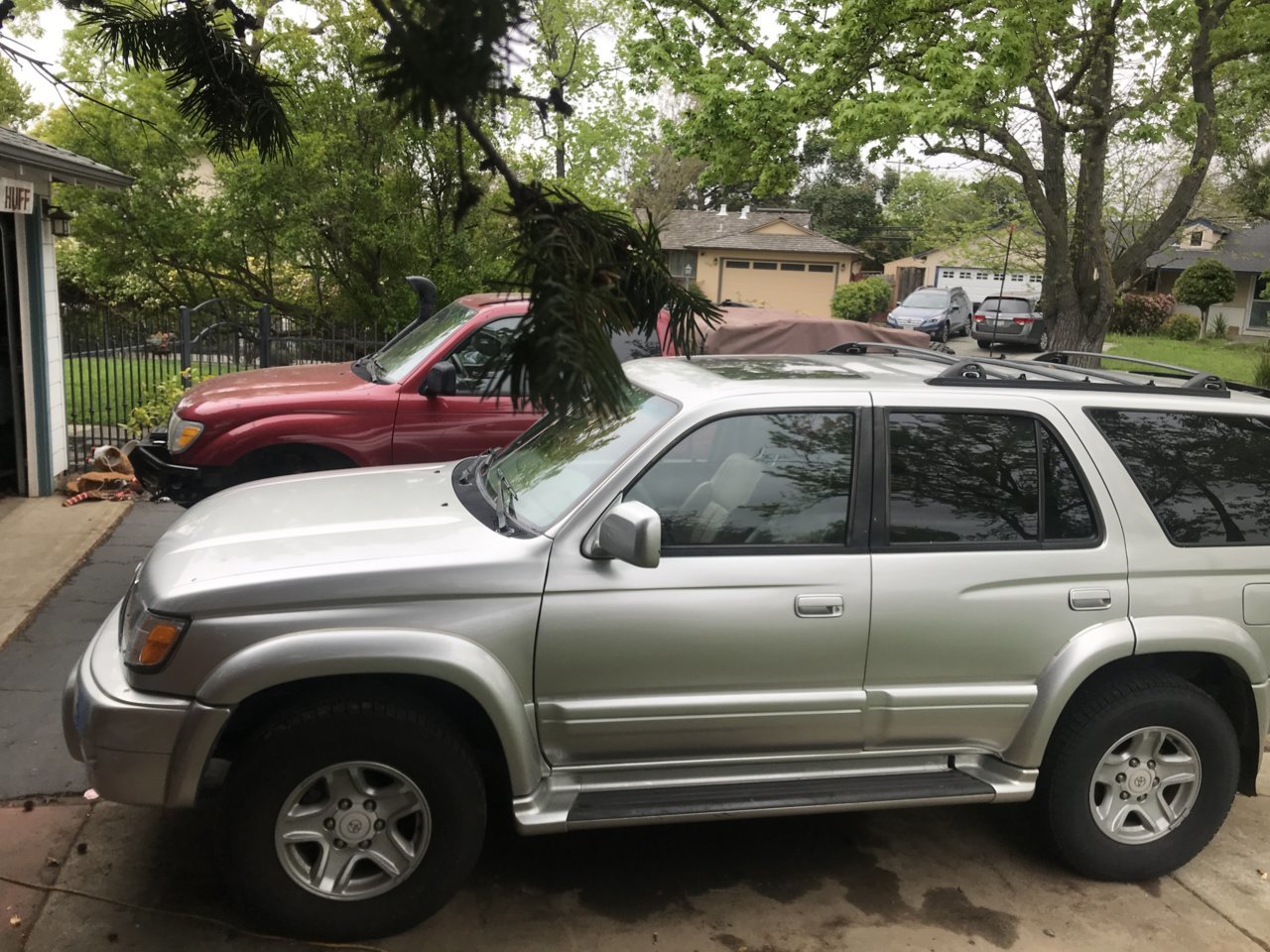

    Well... wife was saying she alway wanted a 3rd gen 4runner.
    2000 limited 140k 4wd with a rear locker.
