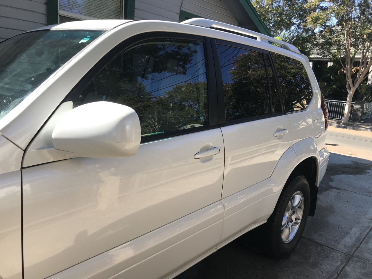

    yeah paint touch up is expected especially for rock rash. Spray paint is always a simple fix and a preferred repair ahaha

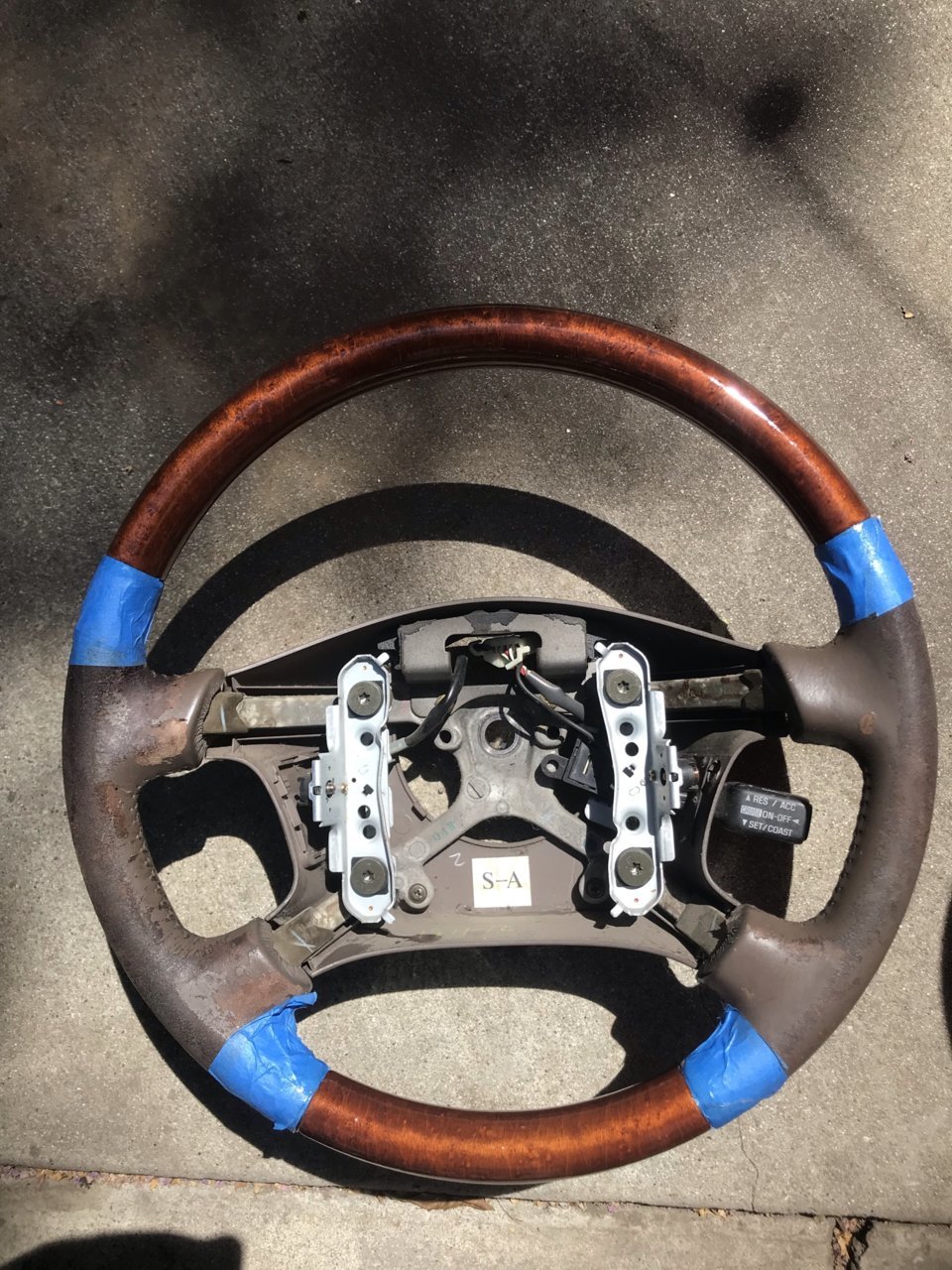

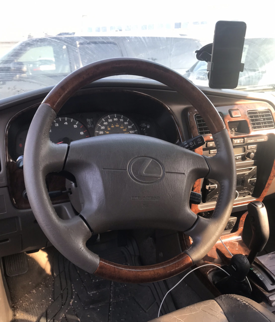

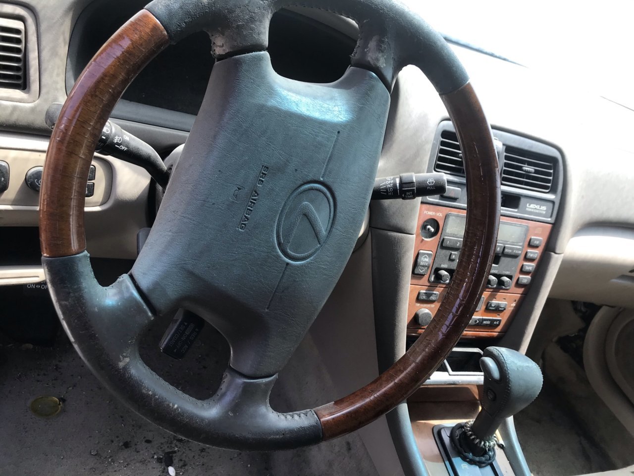

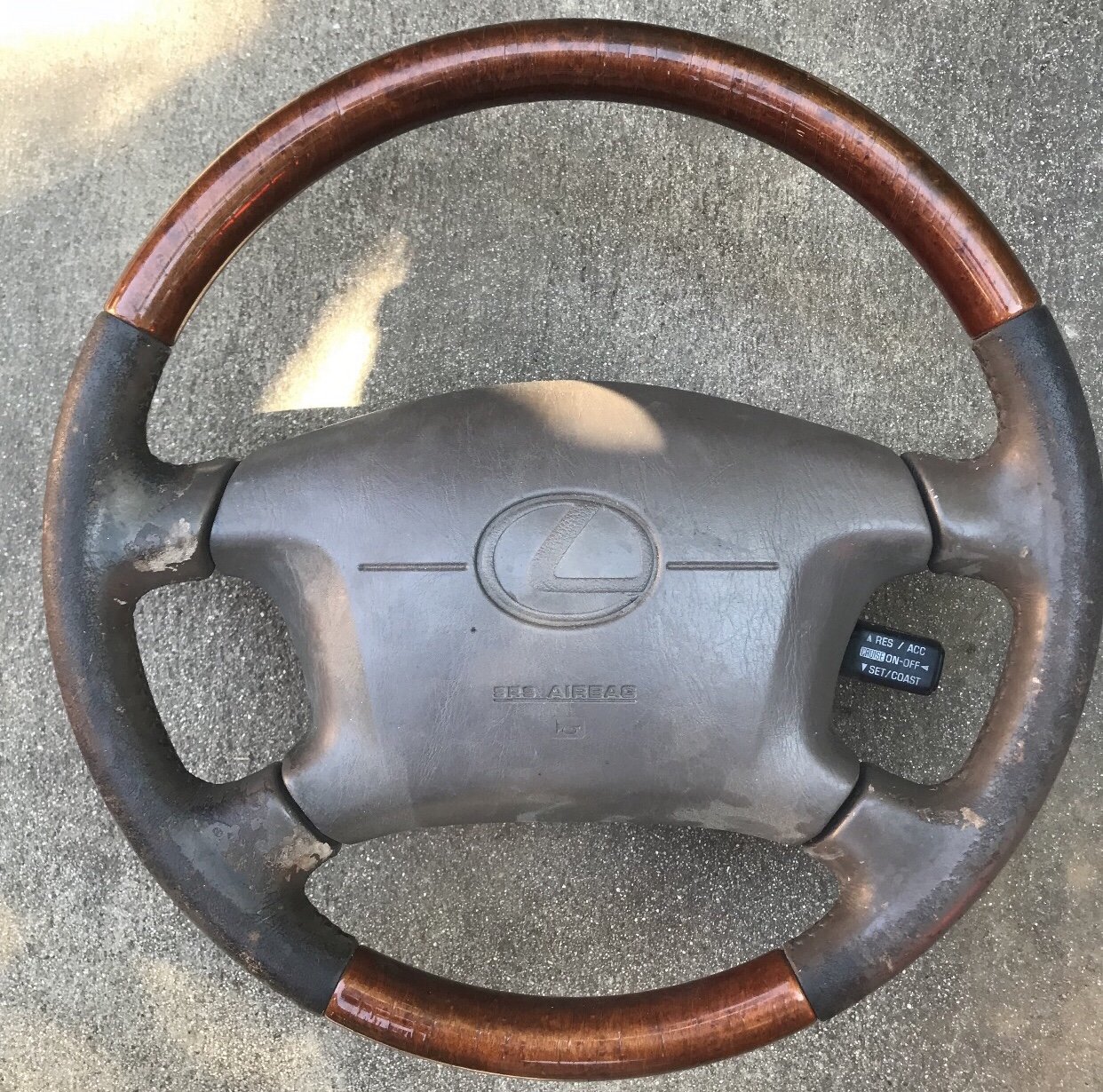

    Style Points

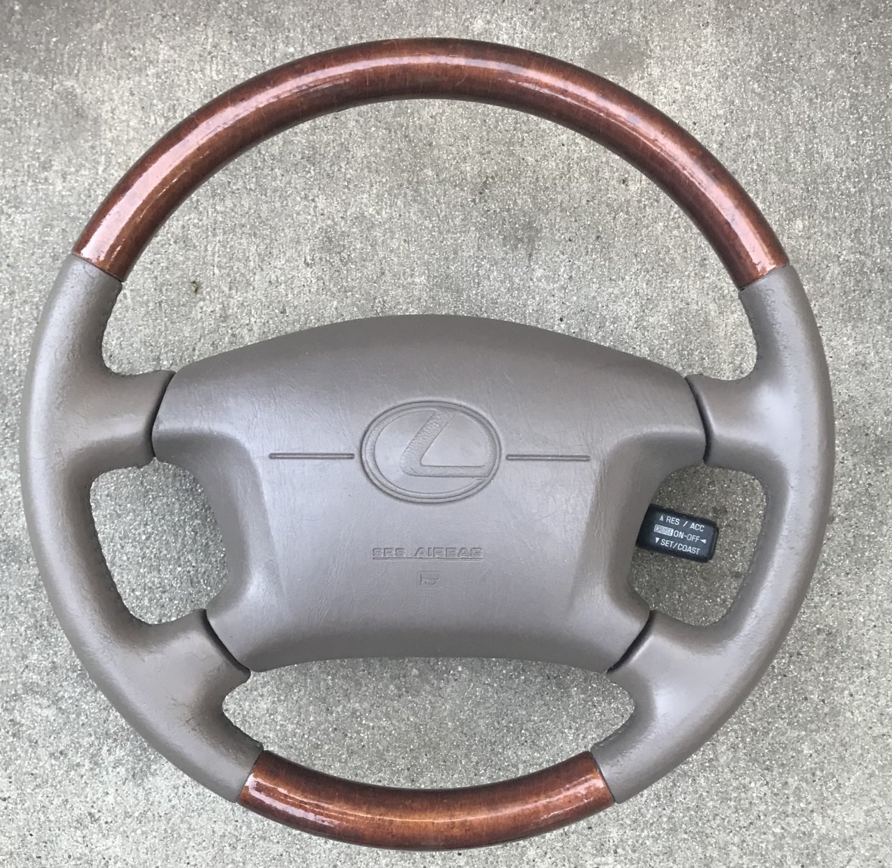

    Donor 2000 Lexus ES300 with Birds eye Maple wood trim.
    Removal is straight forward T30 Torx on either side on the steering wheel near column this allows for air bag removal, and 2 electrical connections Air Bag and Cruise control. With everything removed you brace your self and pull. (May need to use a puller, had to use one for the to remove the 4runner steering wheel during install of this bad boy)
    Junk yard condition was bad, leather was discolored and wood had deep cracks all over

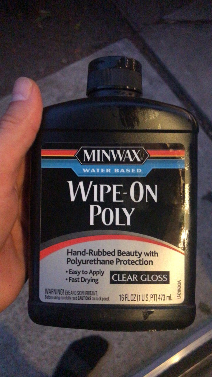

    Taped off the leather and sanded the wood with 600 grit to remove the proud material(near cracks) then applied some wipe on poly and finished sanding with 1200 grit. Took at least 10 iterations of the sand poly sand to get a smooth finish.

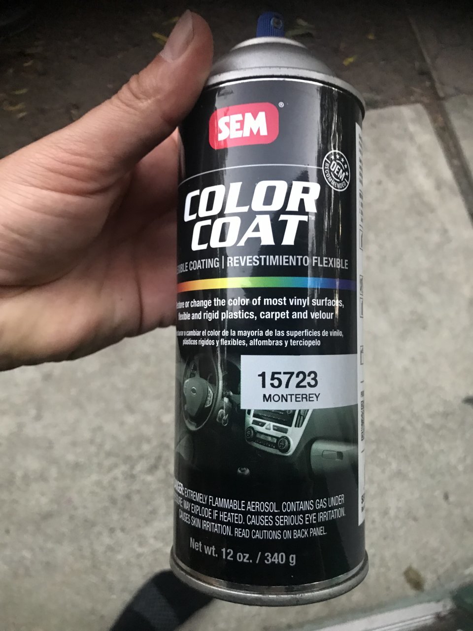

    With the wood in decent condition, sanded down the leather to make the surfaces somewhat smooth and coated the leather with a pretty good interior match.
    Before
    Final result
    Installed matches the interior and plastic “wood” limited trim pretty good.

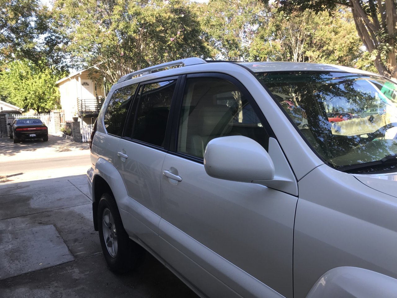

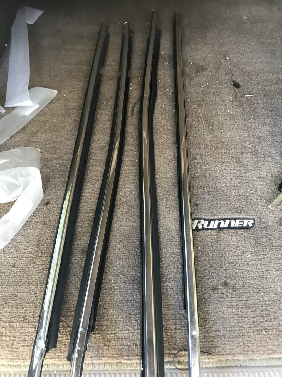

    GX 470 Window Trim
    Nothing fancy just black trim to get rid of the metal chrome crap you got in the early to mid 2000’s.

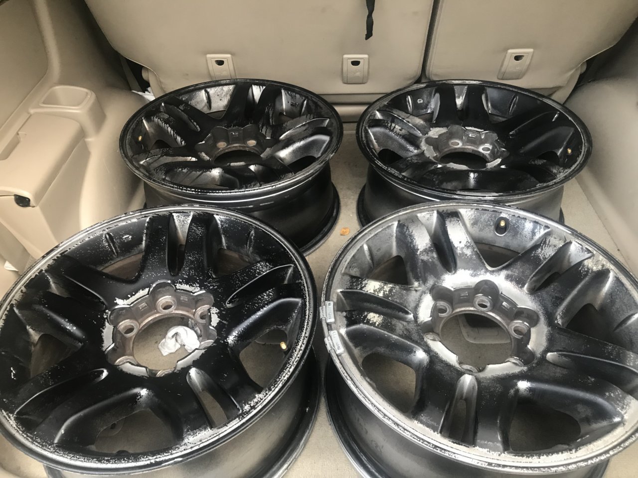

    Just picked up a set of sequoia/ tundra wheels for the GX. Cant wait to clean these up and paint them bronze.

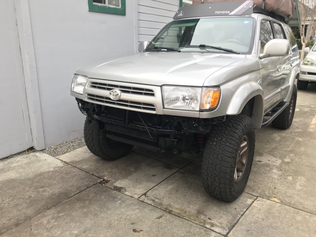

    4runner:
    Bumpers!
    Front
    - TG Tacoma front bumper mount
    -TG winch mount then
    - Cut up the damaged ARB and make something of it using TG mounts
    Rear:
    Beef up the tow hitch bracket and use it as a bumper mount.

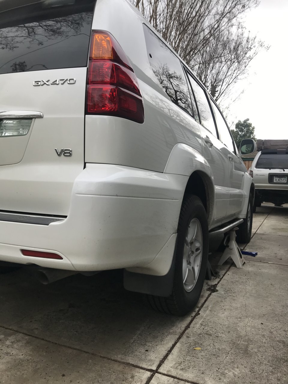

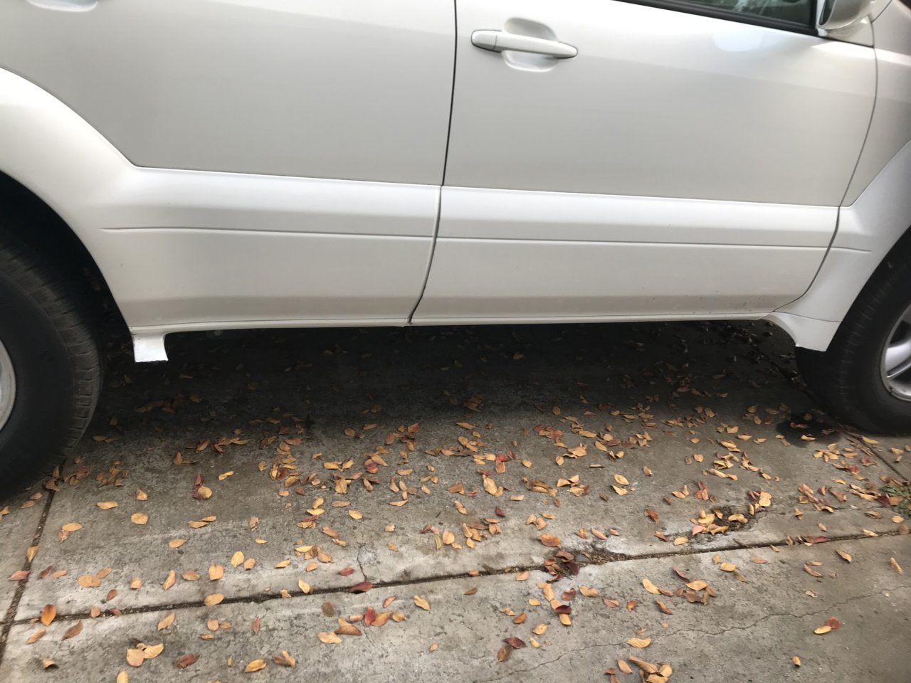

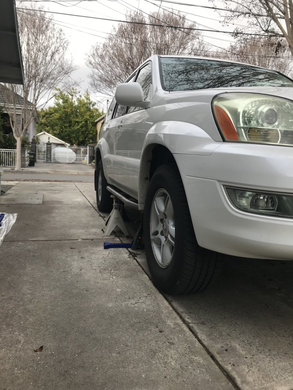

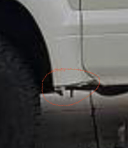

    Running board removal on the GX leaves a small section exposed to running boarding mounting location near the front wheels, as shown in the great internet screen shot below:
    Cutting up the running boards allows you to fit the top trim piece to cover the section up. Just need to trim everything flush. This is all in preparation for some sliders:D

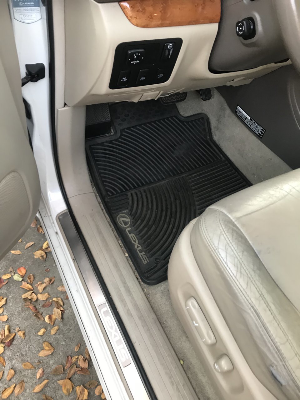

    Found set of front and rear seat OEM all weather mats. Stoked on these

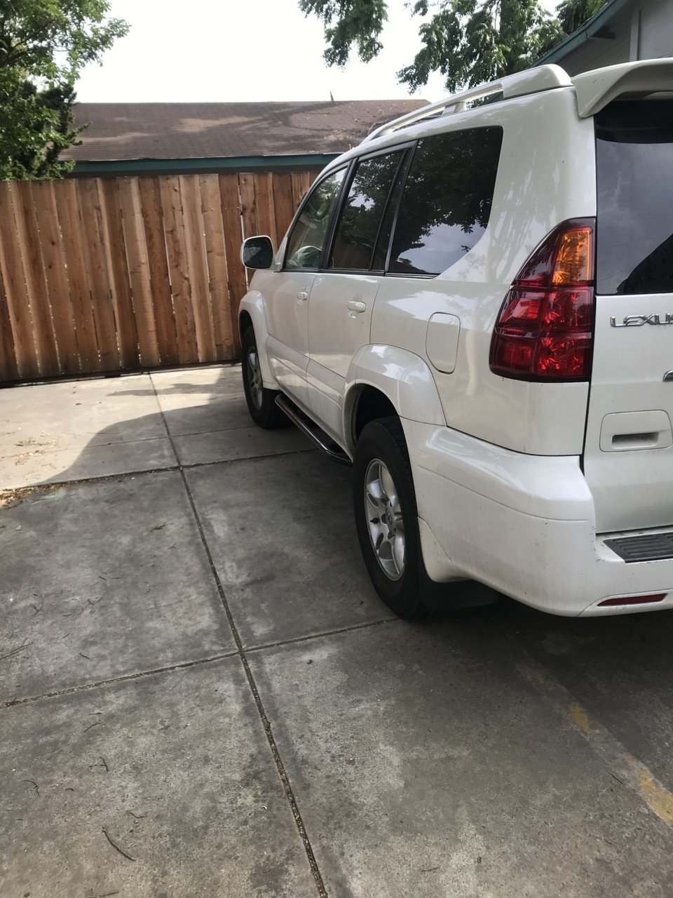

    Trims trimming now complete just waiting on the sliders to come in. Nothing fancy just some 67” TG weld on sliders.

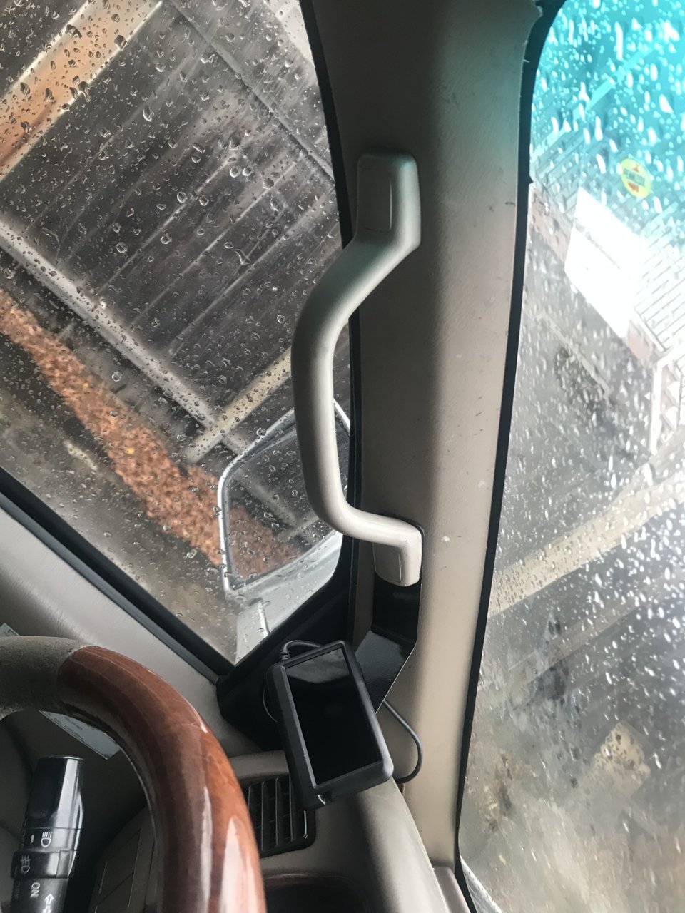

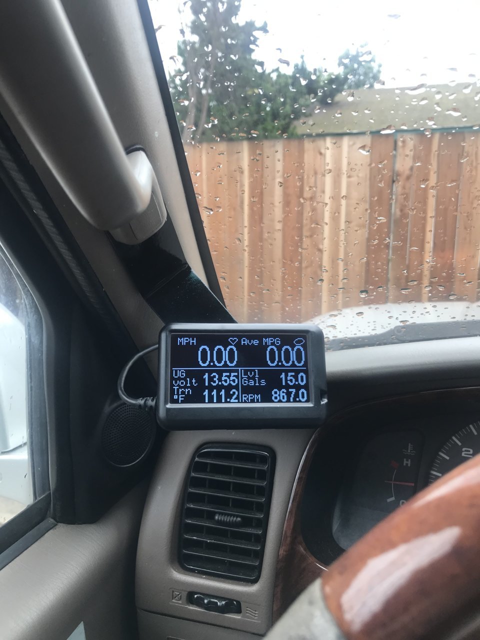

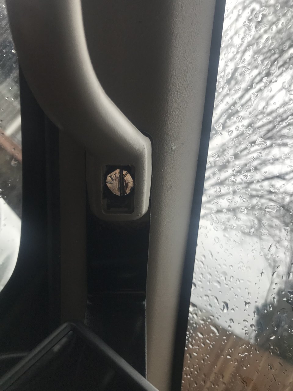

    Ultraguage mount, also set it up to read tranny temps
    I have made a couple of these mounts but this install was by far the most interesting, PO had stripped the Phillips heads of the two mounting screws to a cones. Using and extractor kit I was able to get out one (the top screw) and the bottom threads must have been damaged as nothing was budging.
    After thing about a few possible solutions I decided it was best to drill and oversized hole and tap a larger thread (the angle of the A -Pillar and access made this fun)
    end result oversized thread with ghetto custom fastener with a reduced head diameter and a slot for installation and removal. Eventually this slot will be replaced with a more traditional tooling feature.
    at the end of the day it’s fit form and function is not affected, plus also retains factory look hahah

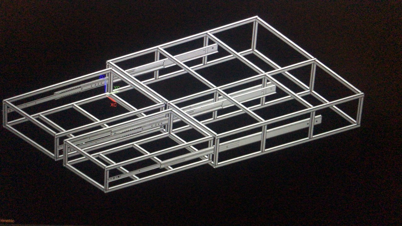

    Drawer concept still in the works:
    Basic overview:
    Steel Frame .750x.750 with .0625 wall
    500 lbs drawer slides with one side locking
    Wood or composite skin
    Allow for fitment to 4runner or GX
    Goal weight 120lbs

  12. Dec 30, 2021 at 11:06 AM
    #592
    Kwikvette
    Feb 27, 2019
    #284735
    81,082
    Fresno County
    4 run, 2 don't
    Shit; going steel is going to make it really heavy.
    Why not aluminum?
  13. Dec 30, 2021 at 11:21 AM
    #593
    Fuergrissa
    Fuergrissa [OP] If you build it, trails will come.
    Jan 9, 2013
    #94858
    2,123
    Devin
    San Jose
    2000 T4R Limited
    Just a preferred material to work with, that’s the challenge is to keep the weight down running with steel also reduces costs.
    I’ve modeled in the tubing radii and wall thickness and based on the volume of the frame I’m sitting at 60lbs and estimating 5lbs of weld so approx 65lbs.
    Also Using steel for the drawer frame will allow my to try and find light weight skins.
    At the end on the day still a work in progress and still being in the design phase nuthin is set in stone yet.
    Kwikvette[QUOTED] likes this.

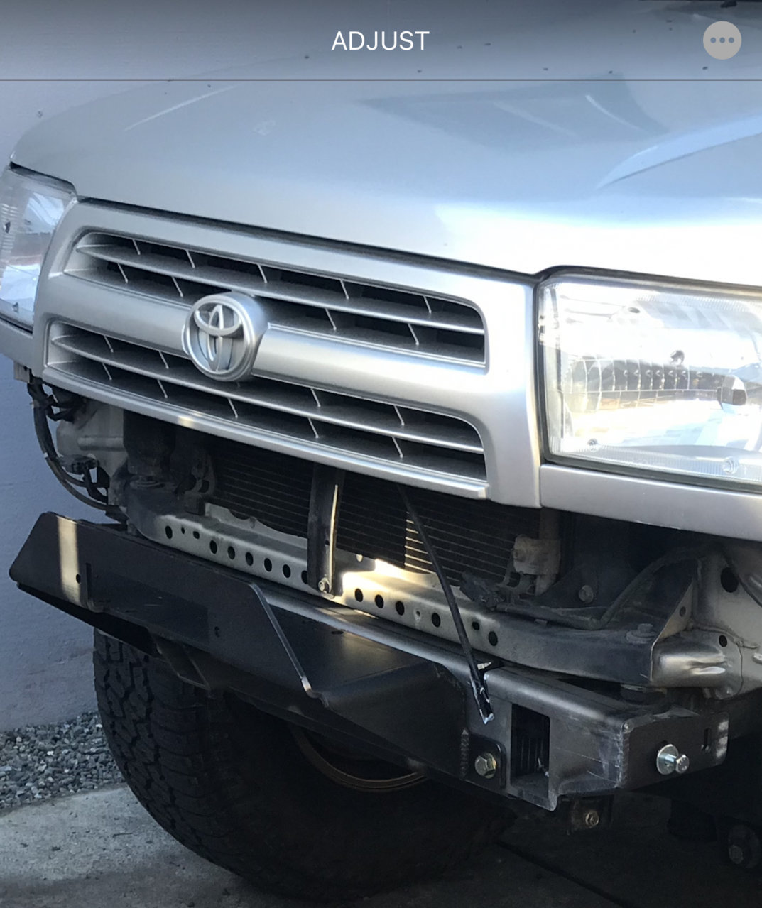

    Test fit the 67” sliders on the GX.
    Trimmed the bumper mount and test fit the winch mount.
    Trimmed the frame horns and welded some end caps on.
    More to come in the next few weeks

    You gave me an idea to build a bumper off of my winch mount.

    Sliders are on the GX.
