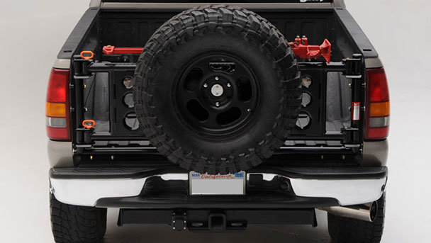

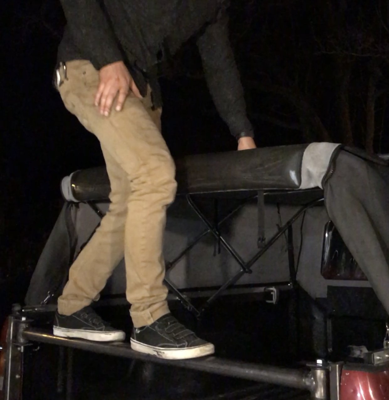

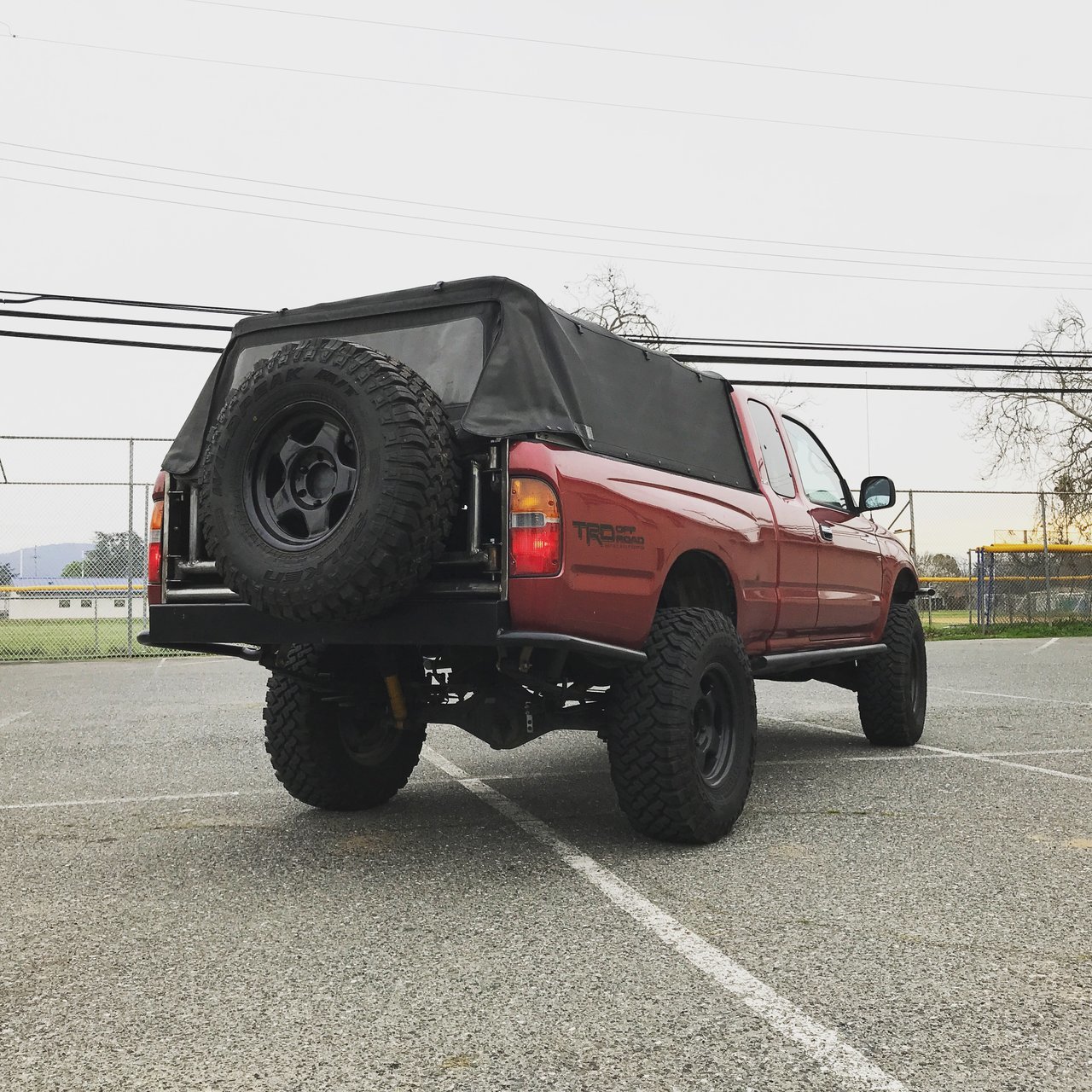

    Thanks man, got the framing idea and fastener locations from Wilco off road.63B169AB-E6BD-4A76-AFC0-2590250C1E13.jpg

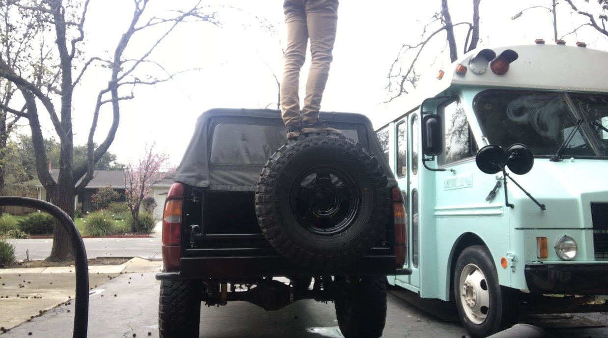

    I did some non destructive testing last night, which means I jumped up and down on it, no real movement/ deflection so I’m happy.
    There are other designs out there Alecoverton on ista has a really cool set built of his bumper.
    I would say the downside to Wilco’s/ my setup is it’s attached to the body and not directly to the frame, seeing that I designed mine able to be welded to the top of the bumper if I decide to go that direction.

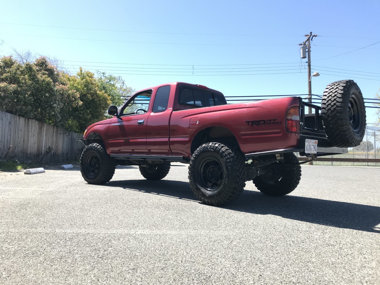

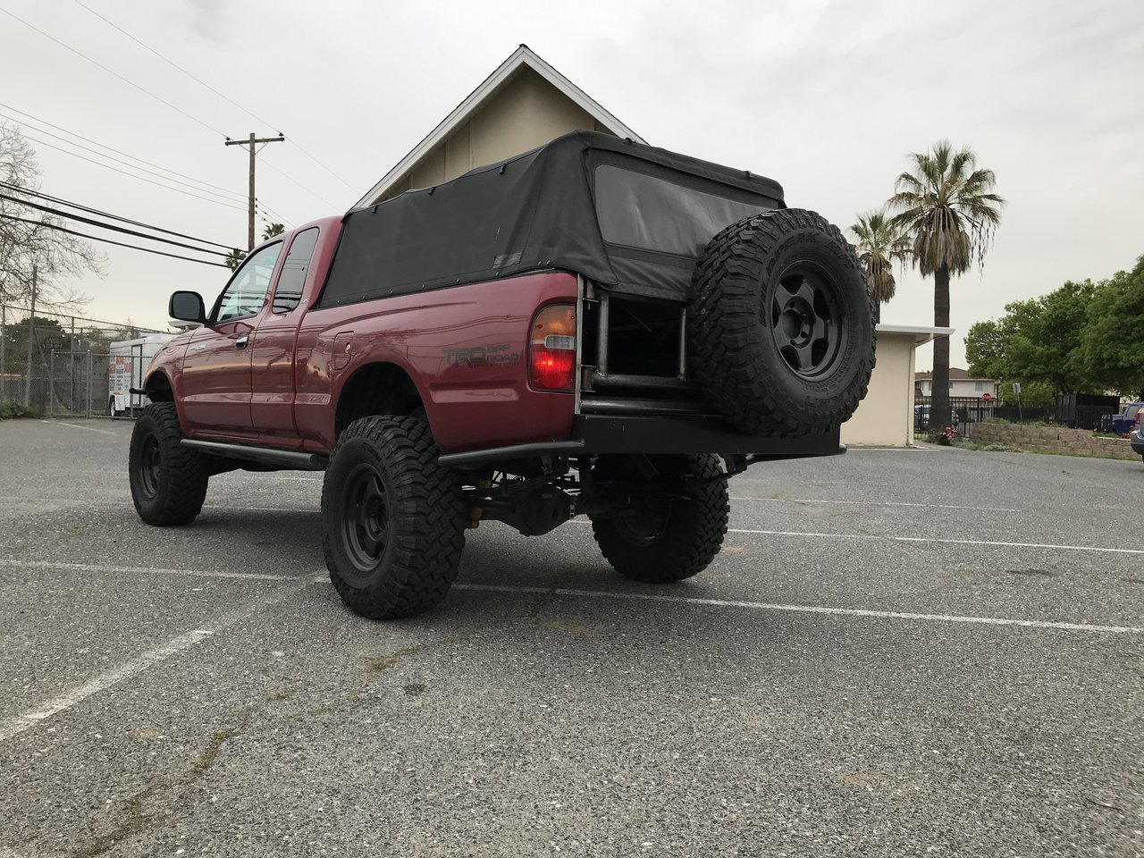

    Almost done!
    9776E4C8-AAF8-4031-A912-92E0DDE01E1F.jpg 0F9CE1F4-90AA-4A0C-8808-23A747571D08.jpg

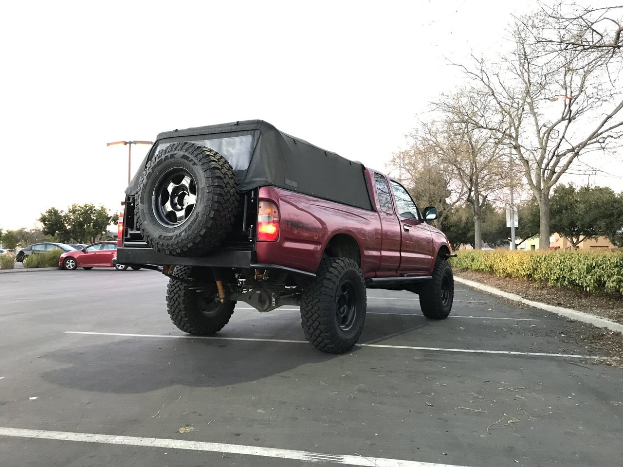

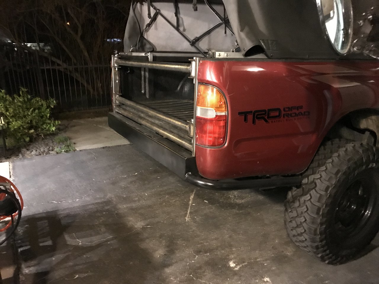

    Added gussets,stock tail gate mounting points and paint0D2C44BD-EF81-4F25-9FA6-FE0FC35B85FD.jpg959F8460-C4C3-4863-942E-EC3D4B6E50F7.jpg

    Dalandser likes this.
