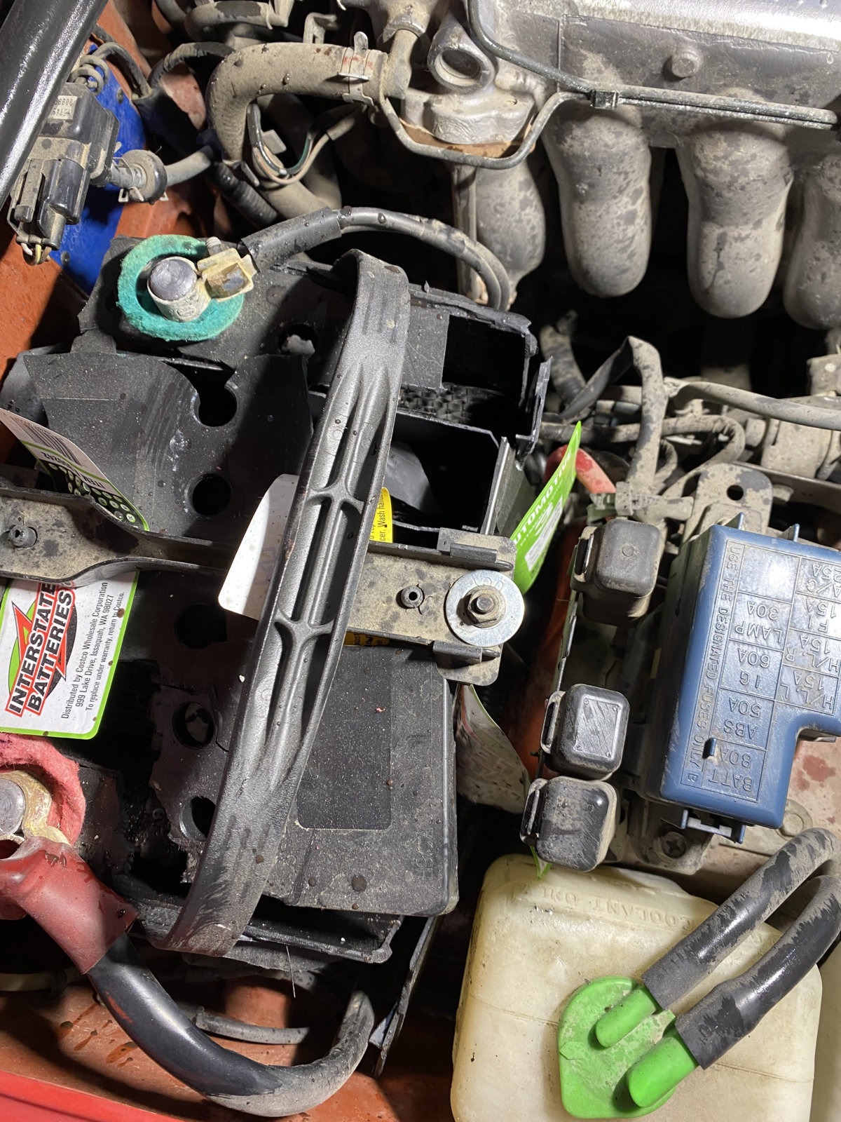

    This would be a better click bait in the EV section, but it happened to my wife's car. The weather has been cold and she doesn't drive the car much so I had the battery on a tender just to keep it charged. Today's weather wasn't too bad so I decided to start her car and warm it up a bit. I turned the car on and everything seemed fine, so I twisted the key to start it up. There was a huge bang, like make your ears ring huge, and then nothing. I looked under the hood and this is what I saw - - Battery acid all over the car, rotten egg smell, and plastic shrapnel every where.
    I pushed the car out of the garage and hosed everything down with fresh water from the hose. Then I raided the fridge for the baking soda and sprinkled that everywhere. There weren't any reactions so I'm pretty confident I rinsed all the acid off. I've heard of batteries exploding, but this is my first time. Fortunately I was in the car because if that had gone off in my face it would have been a very bad day.

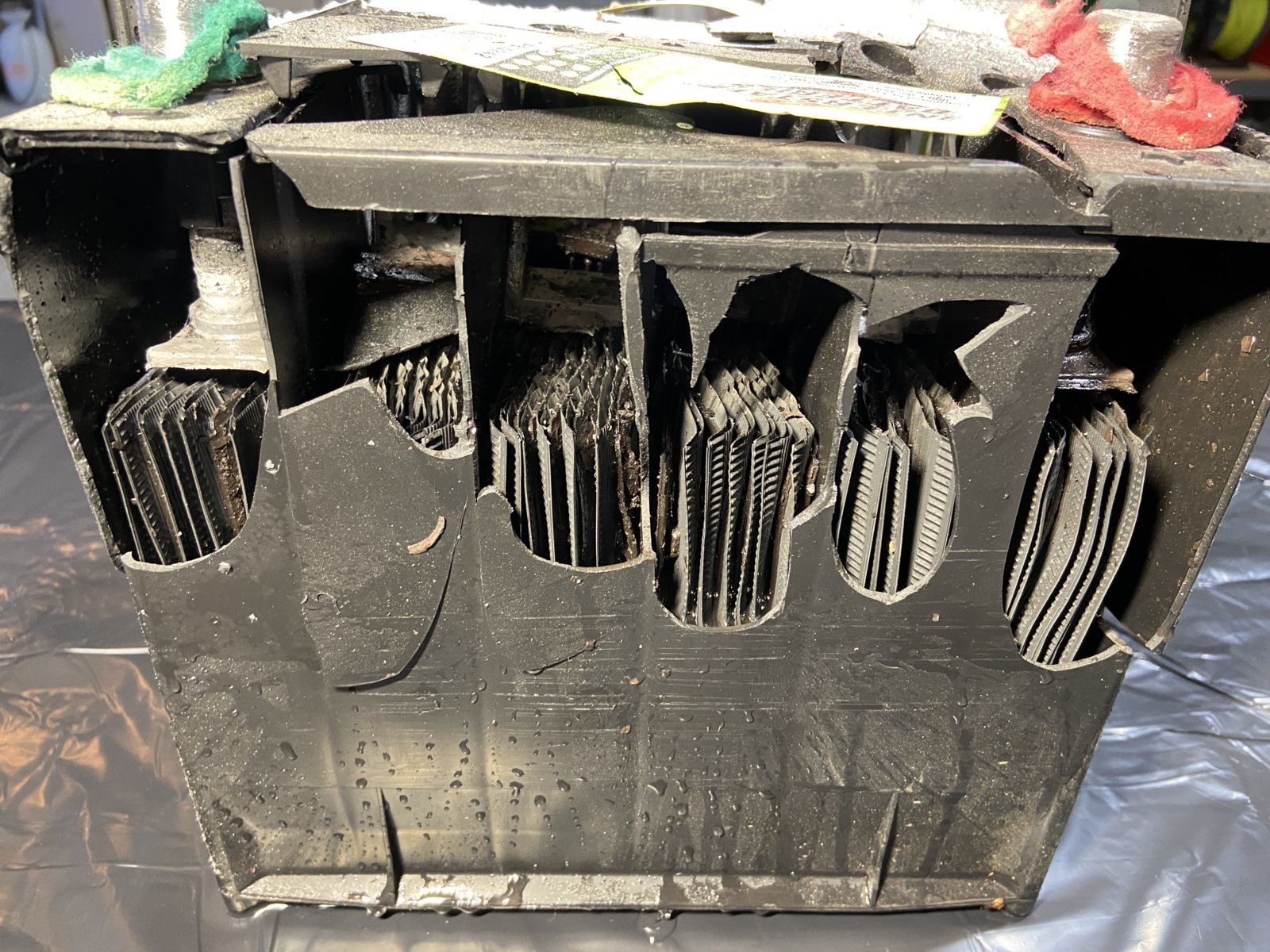

    Not very common for it to happen but it does happen, I've seen a few explode before.
    They generate hydrogen gas when they are charging so all it takes is a spark in the right place (like an internal short) to set it off.

    It was and Interstate battery I bought at Costco. It was on it's last legs and my wife was bugging me to buy her a new one. When she saw what happened she freaked out a bit. I just laughed and said well, you did want me to get you a new one. lol

    1) How old was the battery
    2) did the battery case look swollen
    3) how long has it been hooked up to the battery tender
    4) what charging cycle was the battery tender on when the battery exploded ...... bulk charge / solid red light, maintenance mode/ solid green or absorbsion charge / flashing green
    Generally I would never try to start a car while it's hooked up to a battery tender or charger for the exact reason as you found out

    How old was the battery? I don't remember exactly when I bought it, but 4 maybe 5 years old.
    Did the case look swollen? No, it looked fine and the battery was working fine a back in November when the car was parked. However because of the long periods of sitting idle it struggled to hold a charge.
    How long was it hooked up? Two months.
    What charging cycle was the battery tender on? Well, that's a long story. The short version is a family member passed away and the charger was in their garage. They had an RV so I just assumed they were using it for the RV batteries. Then some internet stranger asks what charging cycle was it using and I had no idea. So, I went out to look at it and the damn thing is not a battery tender but a 1 amp slow battery charger :eek:. It has two states, plugged in and charging or unplugged and not charging. I have been literally cooking that battery for months.
    I'm going to have to thank my guardian angel for letting me be a lazy ass and not disconnecting the charger before I started the car. I just glanced at it to make sure the cables were out of harms way. Disconnecting it could have easily created a spark and a very, very bad day for me.
