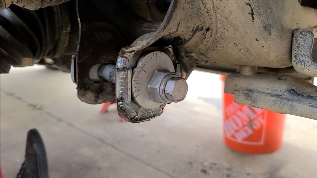

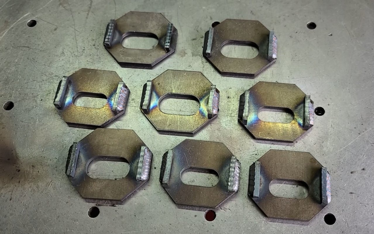

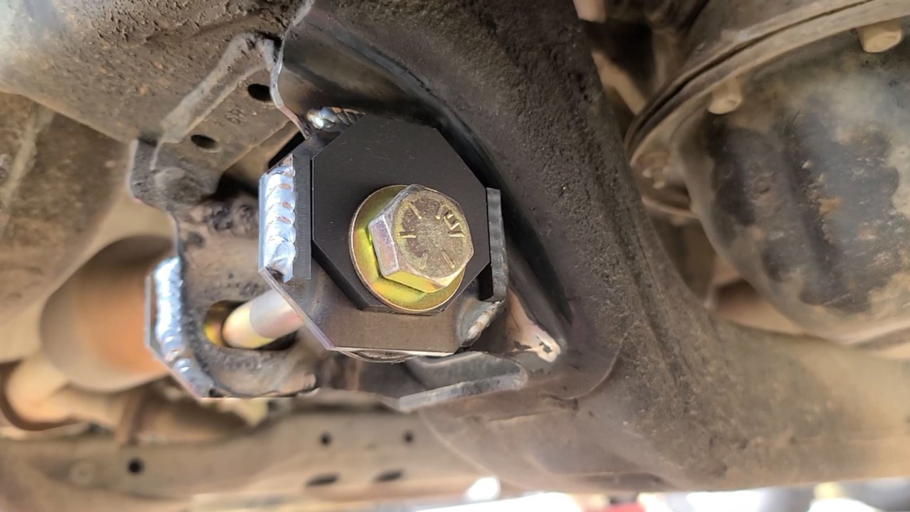

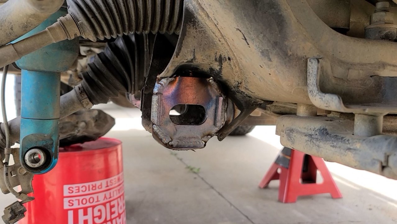

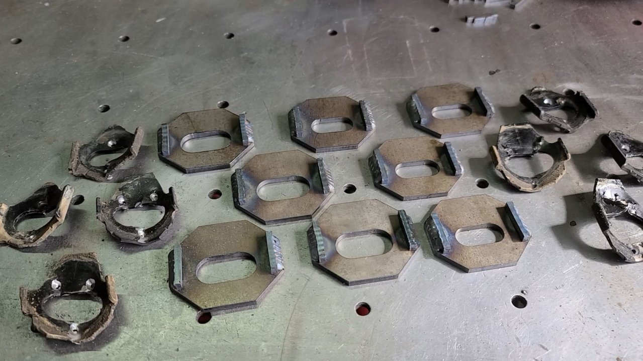

    Some pics as promised. These are screen captures form the videos of the install I took. I'll be sure to get some good pictures of the truck once it's all back together.
    Complete set of cam tabs all welded:
    Old vs new cam tabs:
    20mm cam tabs in the front:
    Octagons painted and ready for install:
    Perfect fit in the cam tabs!
    Perfect fit of the OEM cams in the upgraded cam tabs:
    Back ones hang off the frame a little (so did the factory ones) so you can get a nice weld on it like this:

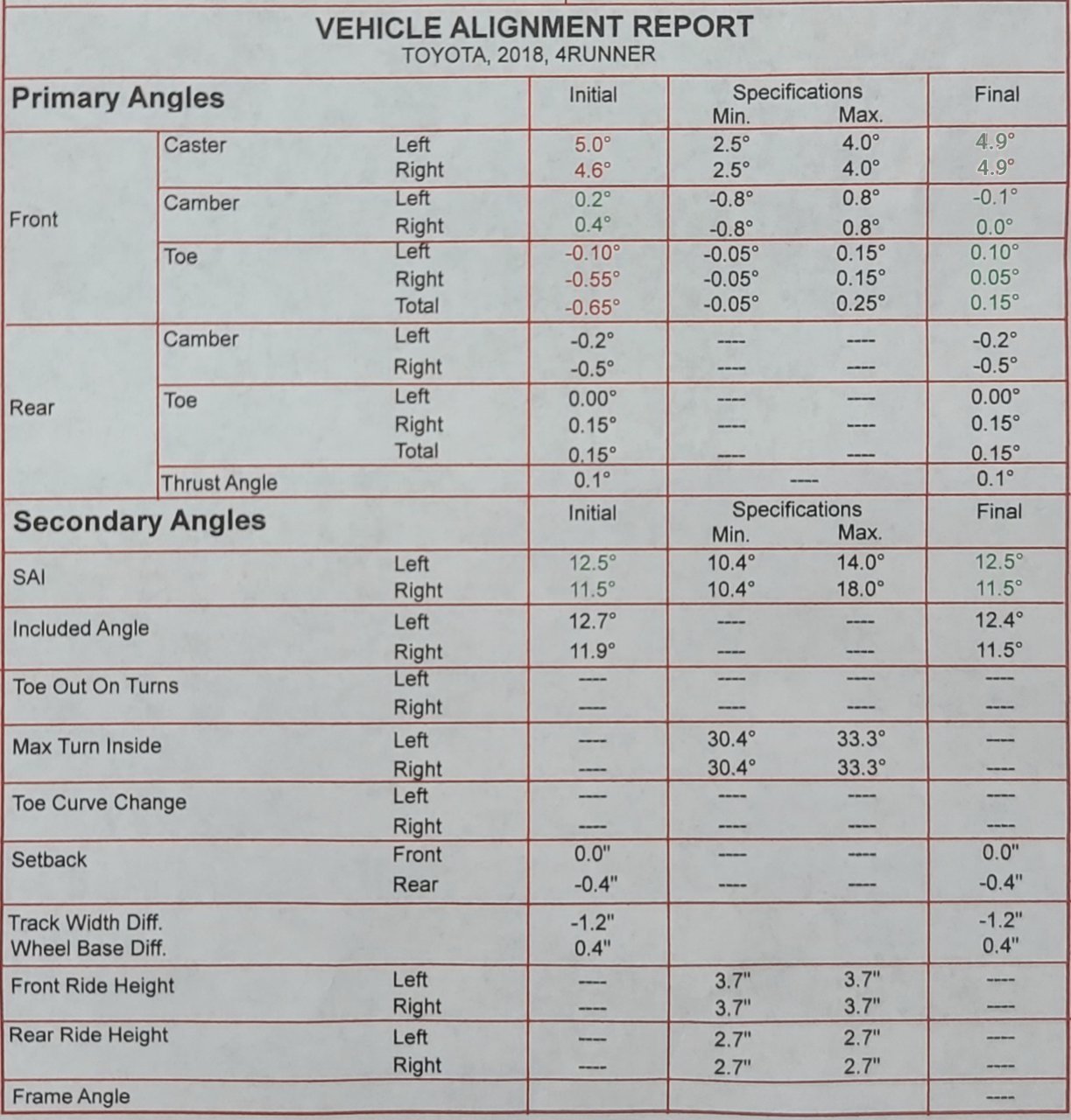

    1st 5th Gen aligned with the kit and everything came out great!
