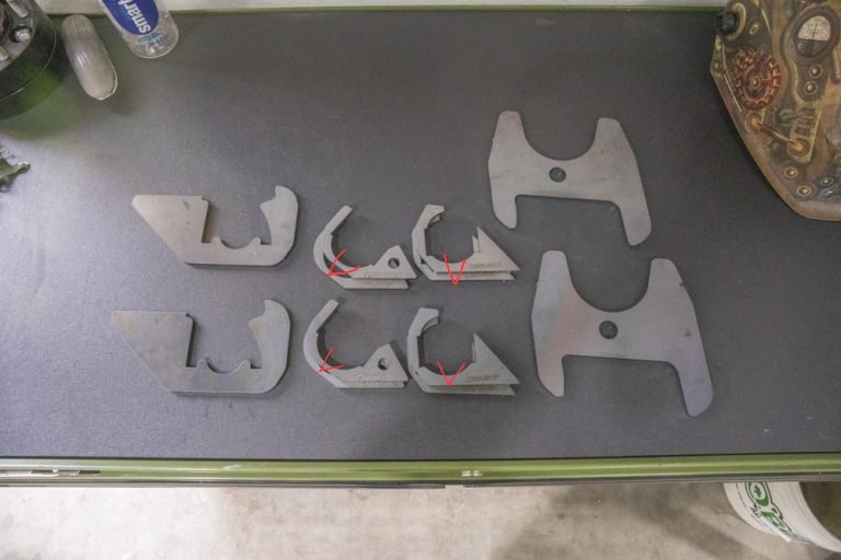

    So it's really easy to do when the MC kit is off the truck, you only need to notch this section to fit the corner of the octagon:
    If its on the truck it might be a little more difficult to do so, but the same notch needs to be performed.
    We've installed our kit with the MC kit at the same time and it all worked great. If you're going to run our cam tabs for even more beef it will require some more clearancing on the MC kit to fit the wider cam tabs.

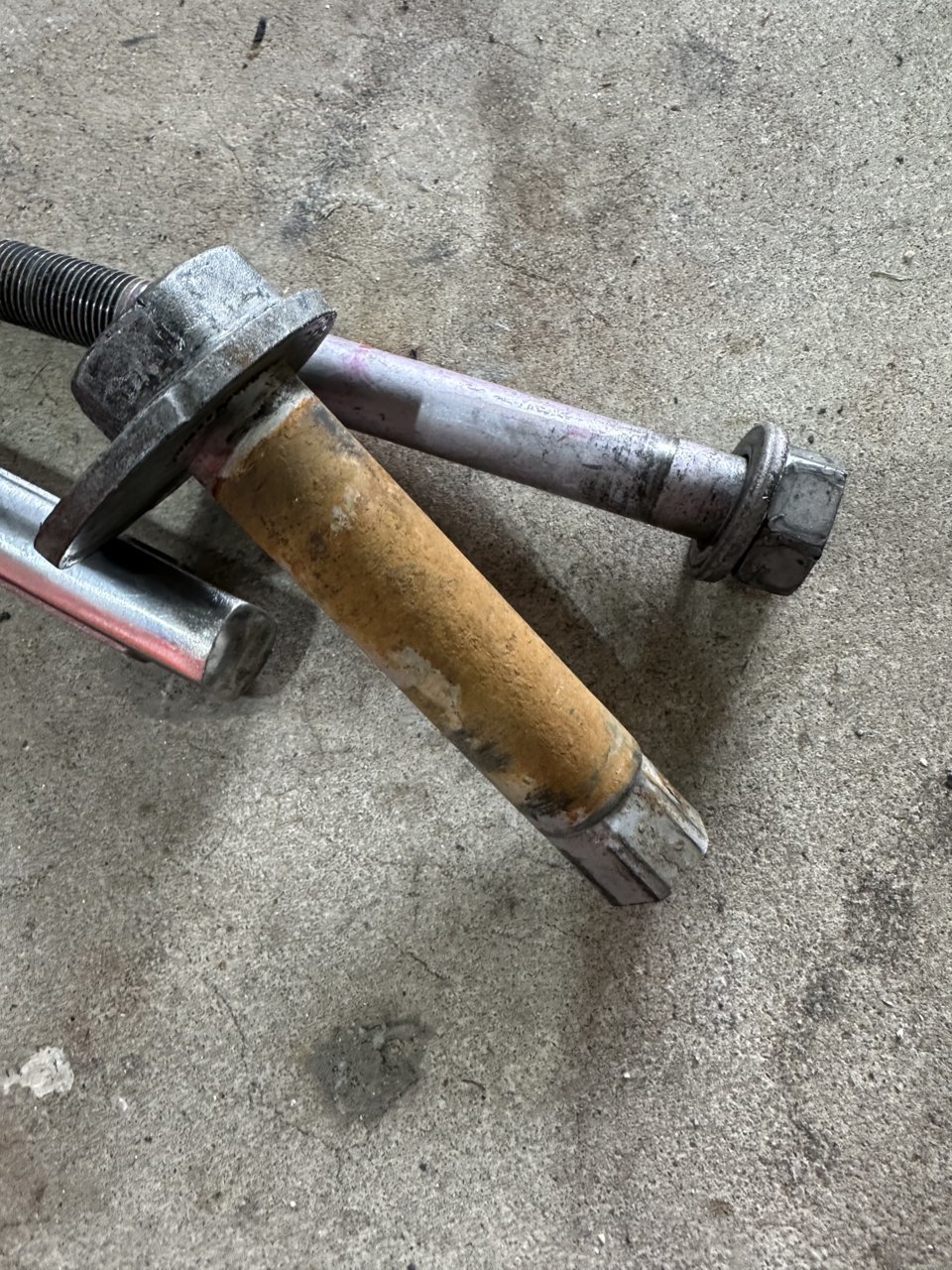

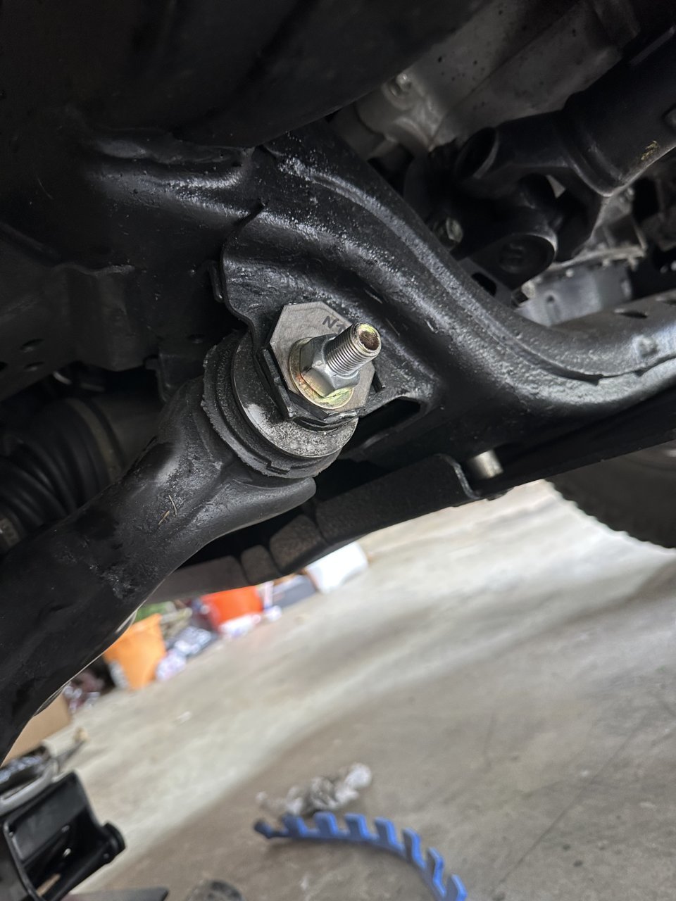

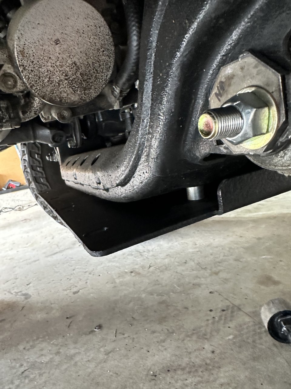

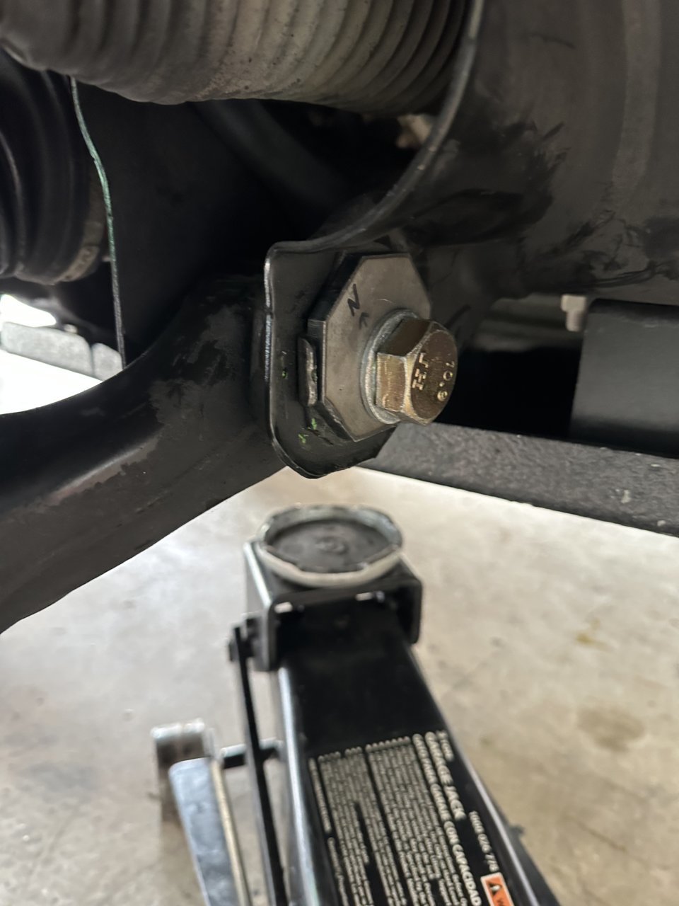

    After an initial test drive truck is back to riding normal, besides needing an alignment. I got around to installing the octo-cam tab plates and bolts from @ForestRunnerFrank99. The threads one the one oem bolt were fubared which was causing the lca to shift going over any bumps. I tried to not drive much with it like that.
    The replacement was really easy. The passenger side I disconnected and let the lca drop to have more room, the fd bolt was the passenger front. I also had to bend a few tabs back. Drivers side I didn’t drop but I made sure to take pressure off the lca bolts with the jack. The rusted sleeve was the drivers front.

    Super nice!! I've never seen the factory threads strip like that. That thing is like a Grade 12.9 bolt.
    Looking at it we might need to start cutting that 5/8" bolt down a little. We use a longer bolt to make sure the shank is the correct size but in turn that means there are extra threads lol.
