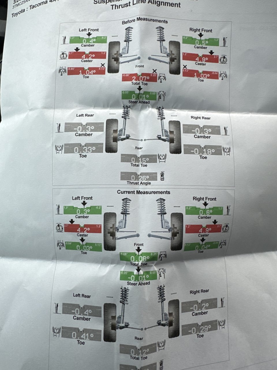

    Got around to treating the plates and cutting about 3/8 or so of the end of the threads off. I should have cut the threads after the bolt was back on the truck but I cut while the plates were drying. Just needed to be careful using the nuts to thread on there again since I don’t have a tap and die set.
    Alignment was also done. The adjustments were made using the ball joint slide nut of the SPC UCA and the tie rod ends. This was the second sheet, took them a few readings/road test to get where it drives right.
    Plus side, it’s been over 6 months since my truck has driven straight after an alignment :rofl:

    When we shank our bolts we spin them on a grinder to get a nice chamfer, then run a stover nut over it to fix up the threads. Works perfectly!
    Alignment looks great! Glad they were willing to work with you to make it darn near perfect.
