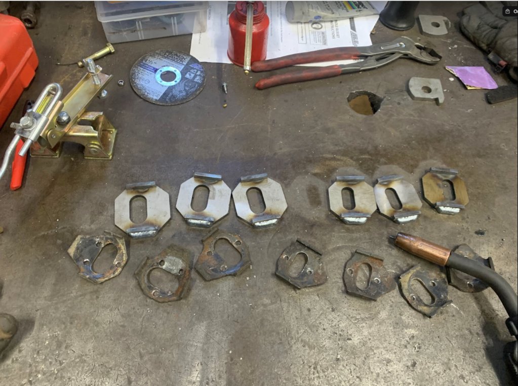

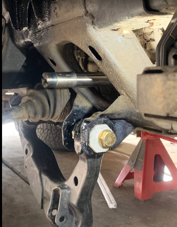

    do the bolts all need to be facing in the same direction? it seems like my CV is blocking from inserting the bolt where the head is in the rear.

    On this platform the bolt can go in whatever way works best for you.

    what size bolt head are they? 3/4" ?

    This platform has 2 different bolt sizes, a 30mm and a 7/8"-13/16"
