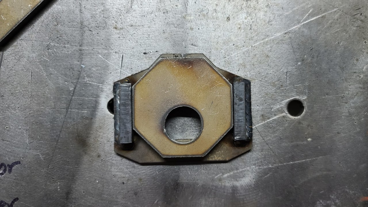

    I had a chance to compare our kit to another kit which I won't name *cough* [AllPro] *cough* and I thought I would share my findings.

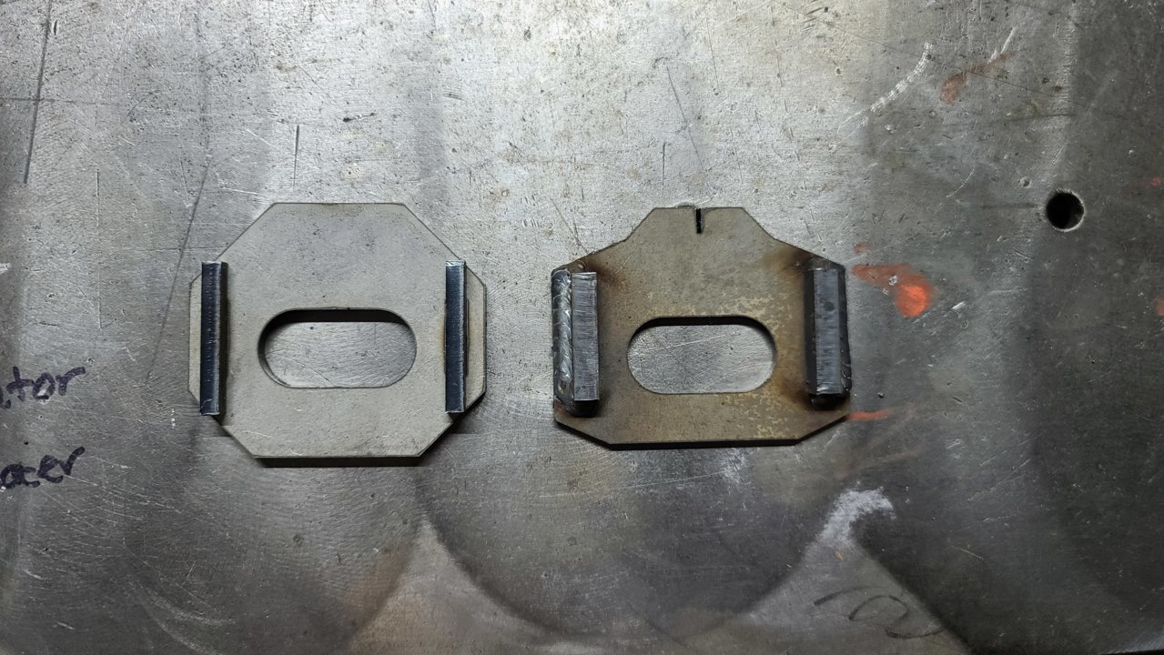

    DESIGN
    Ours is on the left, other is on the right. Off the bat you can probably see a few differences.
    Most obvious difference is the shape. Let's hold off on that for now.
    Next you may notice the keys are different. Ours are a little longer and narrower. You may think the thicker keys are better, but I will show you why they may not be. The length is important as well. We designed our keys to ensure our octagons stay in full contact at any adjustment. With the shorter keys the top or bottom of the alignment cams will hang off. This probably won't be a huge issue but I imagine it could cause some slippage, like a putting the wrong size socket on a bolt. It might work, but may round off with enough force.
    We also get a lot of questions asking if our octagons work in other cam tab upgrade kits. Yes, they do:
    I'd also like to note our tab plates are quite a bit thicker, meaning less bending and more strength :)

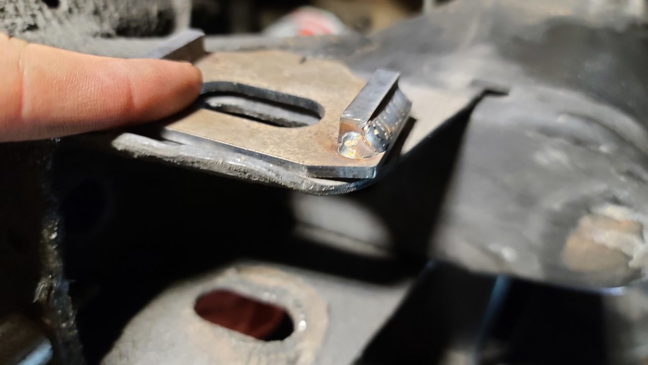

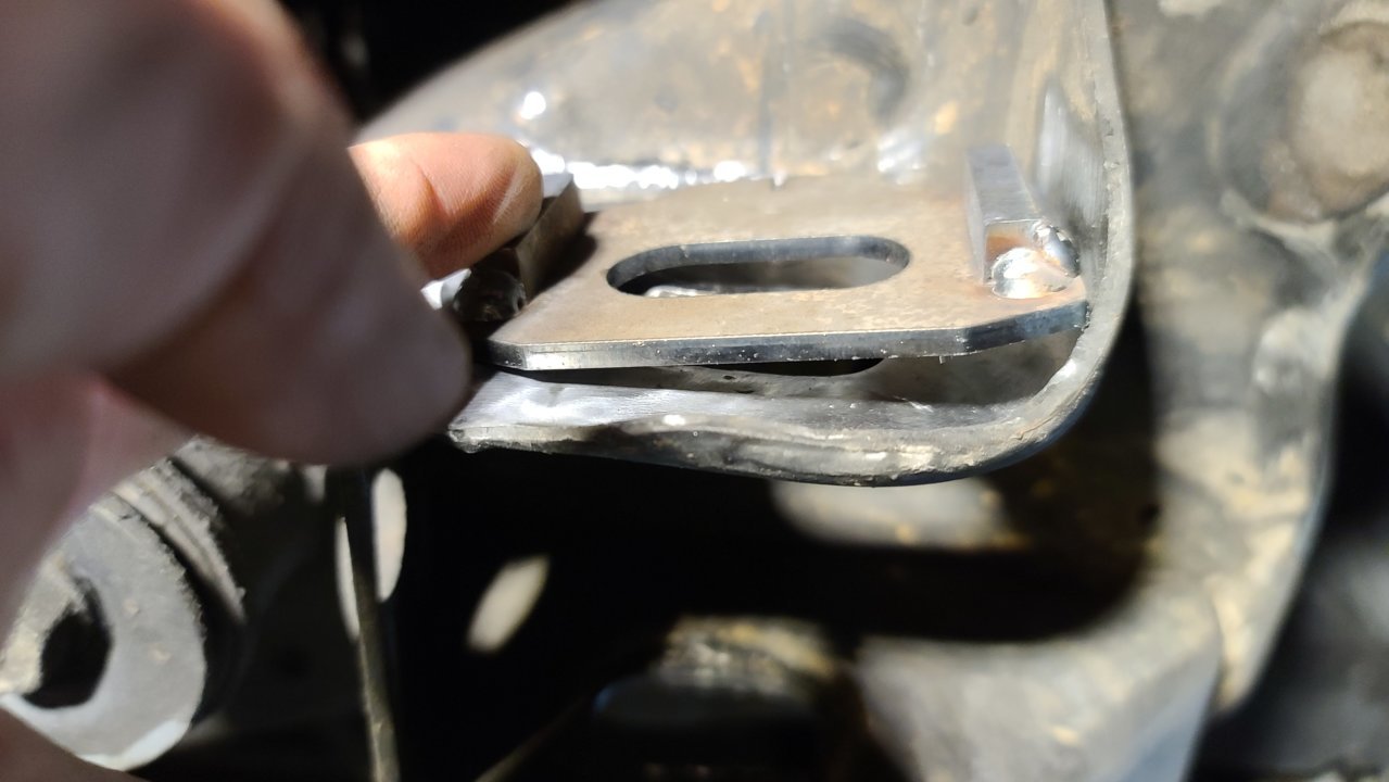

    FITMENT

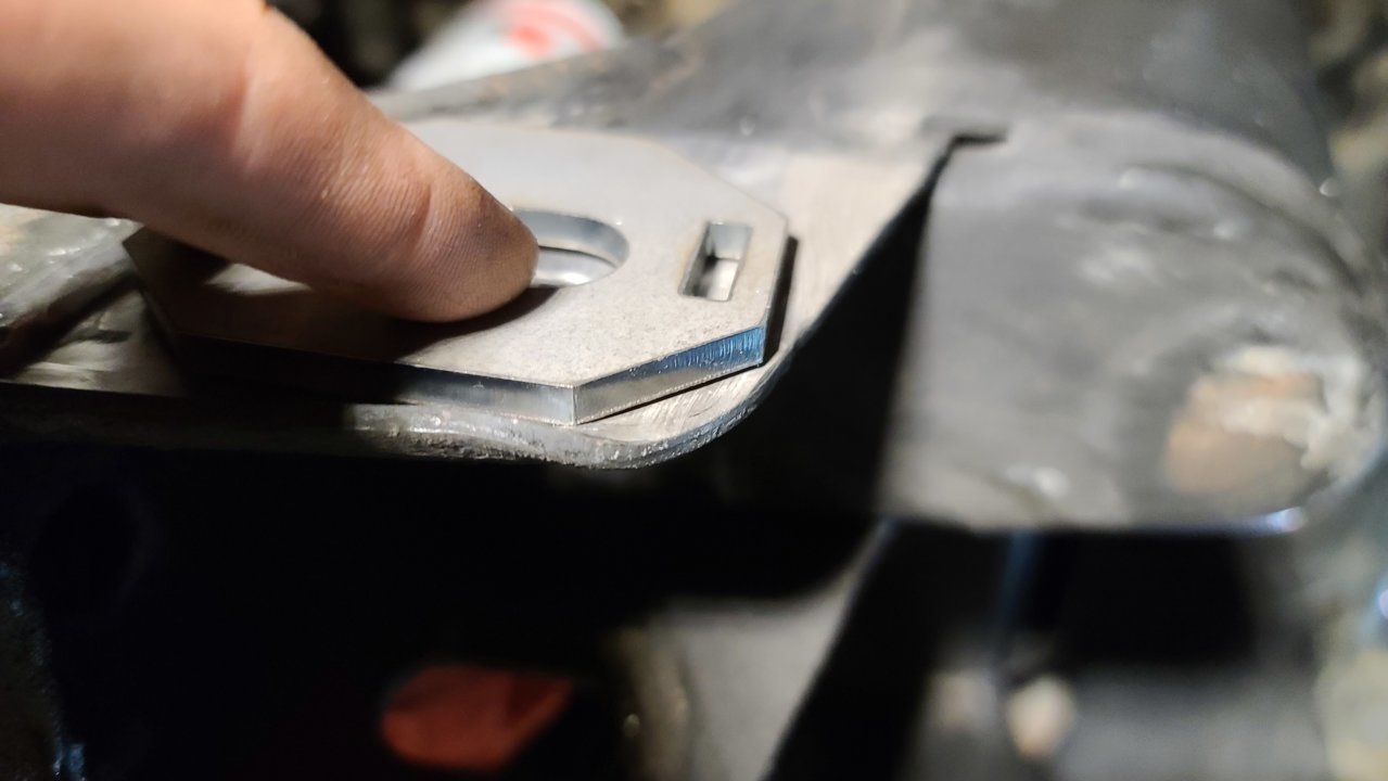

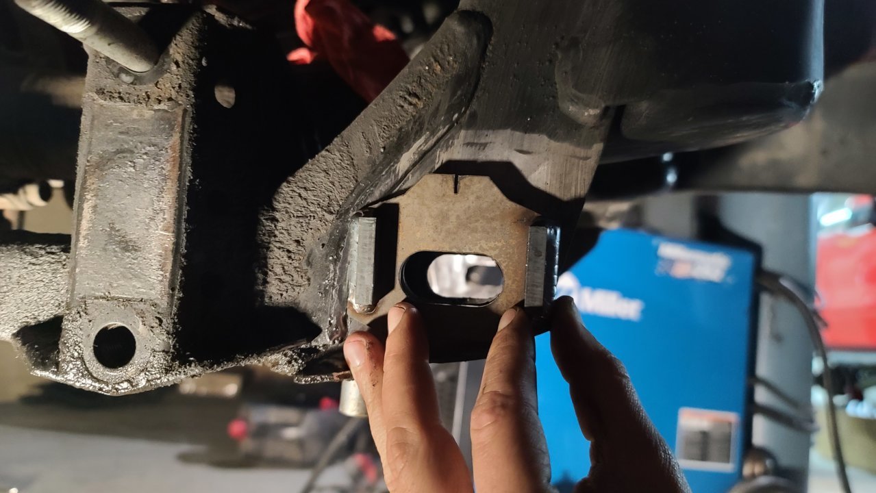

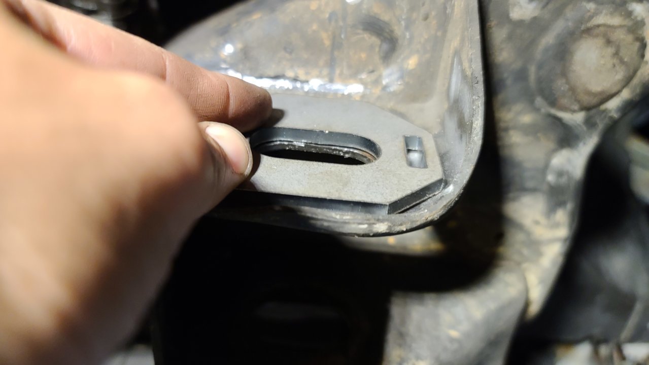

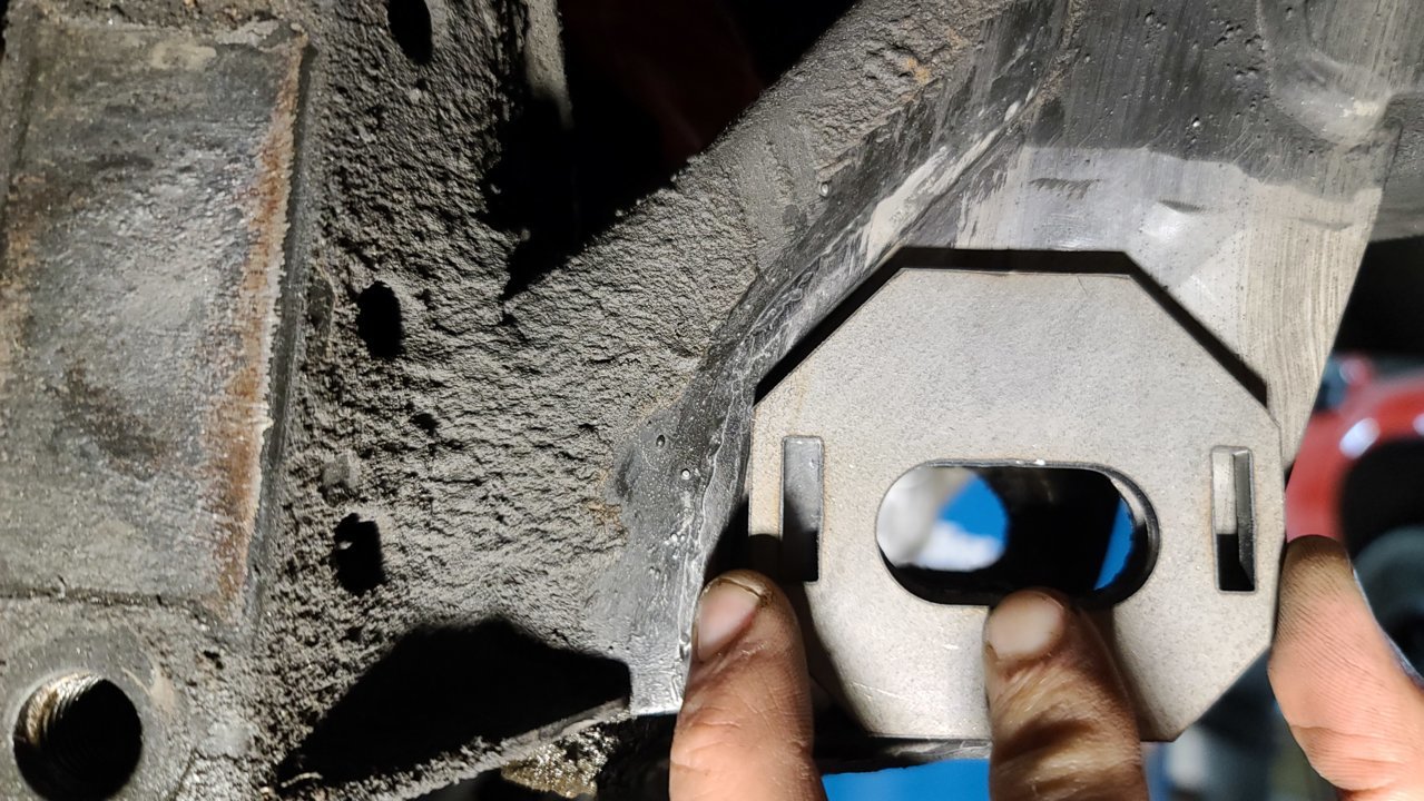

    Now on to the fitment. I'll let the pictures speak for themselves:
    ^Top left corner hits. This is on the rear-rear LCA tab
    ^ No hitting
    ^Bottom right corner hits. This is on the front-rear LCA tab.
    ^ No corner hits
    ^ Bottom right corner hangs off frame
    ^ No hanging chads here
    Basically with our more aggressive corner chamfers and overall shorter length (due to the slightly smaller tabs) we are able to clear just about all the little bits of the frame that get in the way.

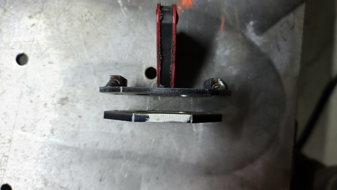

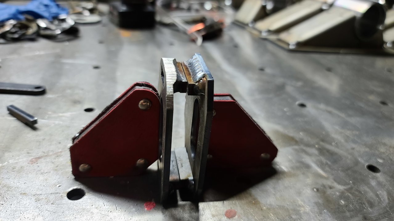

    INSTALLATION/LONGEVITY
    Finally, to get the other kit to fit properly we had to grind quite a bit off the edges. This just adds installation time.
    You'll also notice we ground more than 1/2 the weld away. This overall makes the tabs weaker! Even though the tab is thicker, the actual bond is smaller. This could create some issues with tabs breaking if the weld did not penetrate properly.
