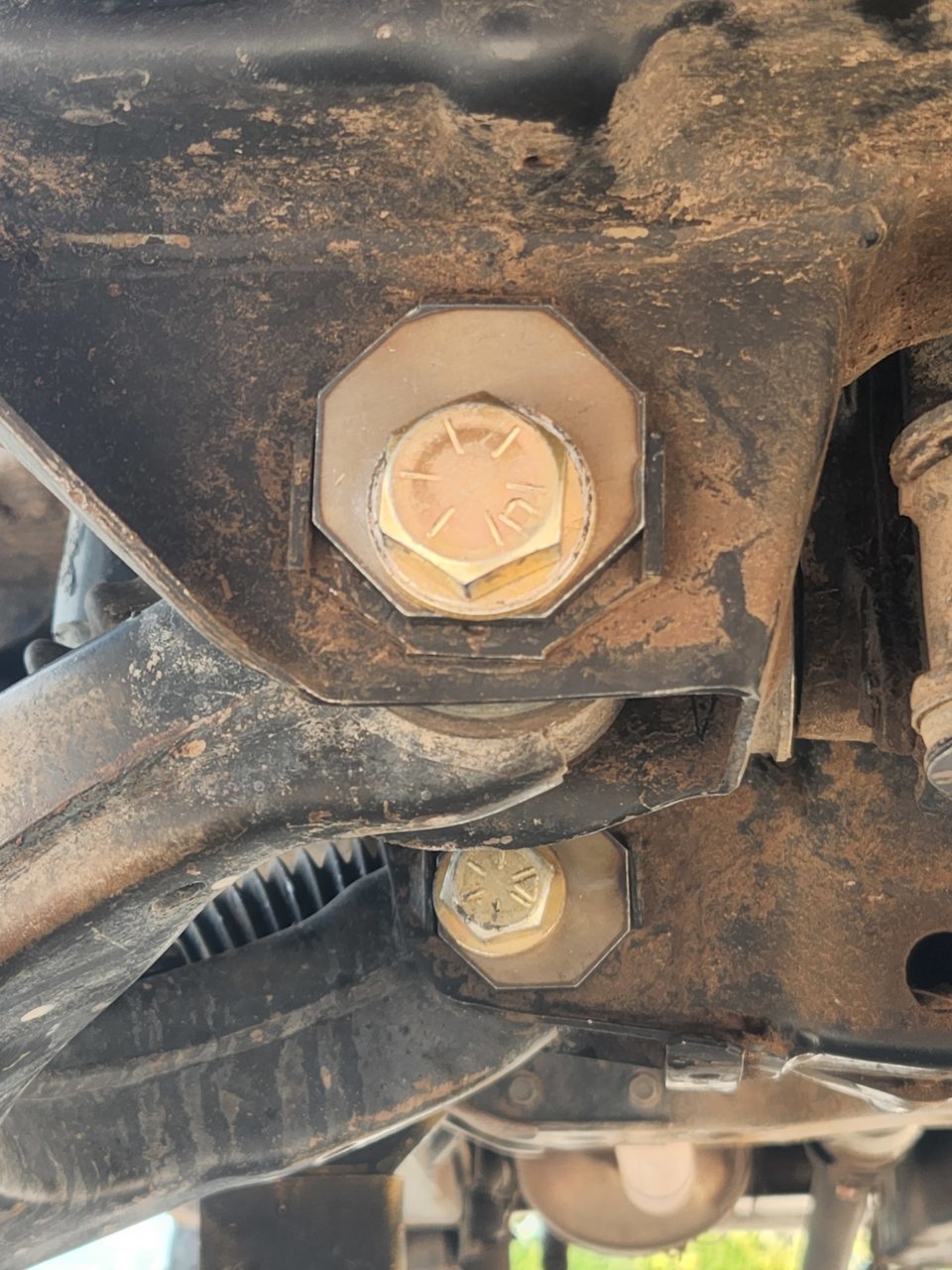

    Just installed mine. Thanks KPOffroad. It would be helpful to know you need a 1-1/8” socket to install these. (I assumed it was a 28mm but Advance didn’t stock any and 1-1/8 fit).

    Looks great!! And yeah they are 1 1/8" bolt heads and nuts. We will be making an install video for these guys soon which will outline everything.

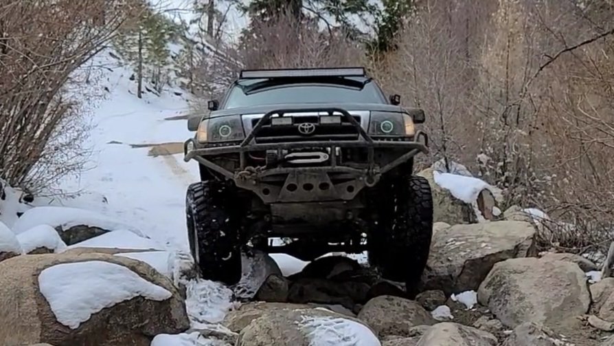

    You are correct in that an octagon will have a less adjustment points (a circle has infinite points) but what's great is the octagons lock in, so to speak. They won't twist around on you so you'll never need to get caster and camber adjusted again (provided your tabs don't bend).
    Here is s picture of my truck after my cams rotated on a trail and the reason I developed this kit:
    As you can see my tires are pointed in at the bottom. The reason this happened was because the cam bolts were a little loose. After I installed the Octagon kit I never had this issue as the octagons won't rotate, even if the bolts loosen up.
