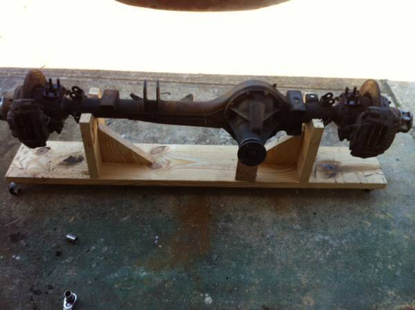

    Pics of the axle: :D
    I put a stand together on casters so I can move this heavy SOB by myself.

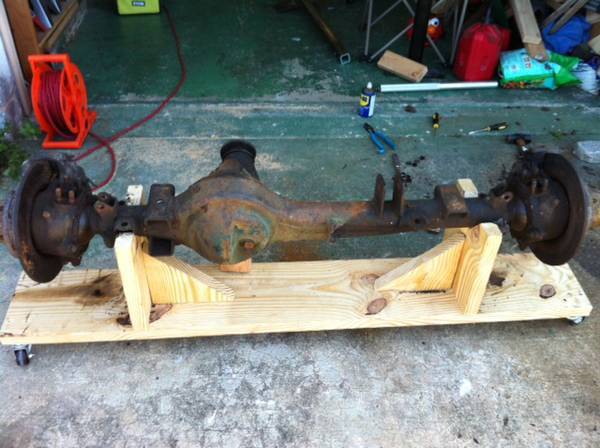

    The axle is striped down and ready for paint. Still haven't got the
    locking hubs separated from the knuckle though, damn cone washers.
    I learned a cool trick off the web for separating the Birf's from the axle shaft. Basically you take a piece of tubing the shaft will slide into, place it on the ground facing up. Drop the shaft in, letting the Birf hit the top of the tube and gravity separates them.
    The stock ring and pinion was trashed. Pieces of gear all inside the housing. Thankfully it was never in my plans to reuse it.
    The axle will get a complete overhaul, new seals, races, bearings,wipers and felts. I'm thinking its a good idea to upgrade all the hardware too.

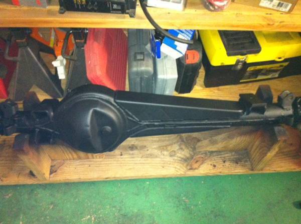

    A big old pile of parts showed up this afternoon! The big stuff is out of the way, just a few odds and ends left to buy, oh and some way to cut the IFS off.
    Going wheeling tomorrow too, maybe the last time with IFS :D
    GH

    Got the truss welded on. The kit came with a small weld on diff guard, don't think I'm going to use it. They make a much nicer one with better coverage for 30 bucks, have to order it.
    I should have time to paint the steering knuckles tomorrow, I'm going to do them in red.
