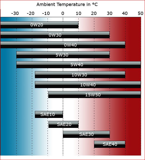

    This may be a dumb question, but if this is ambient temperature, then why would 0W-20 be recommended at all as most of us across the US will see ambient temperatures easily over 10°C (50°F) a much higher percentage of time compared to seeing -30°C. Going from this chart, we all should be in the 5W-40 range most, if not all, of the time.

    I agree, but still, if 0W-20 is supposed to be for -30°C to 10°C at start-up, wouldn't that mean that most of us are outside that range and are using an oil that is too thin at startup?

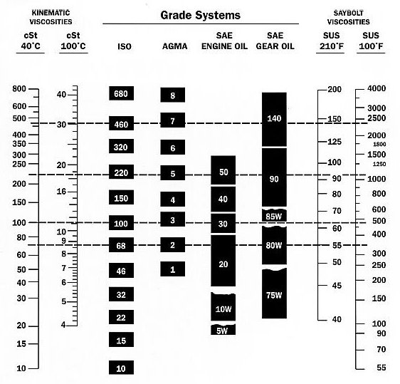

    I wouldn't put too much weight on those generic temperature range charts. Good for visualizing how there is a correlation between viscosity and temperature, but not too valuable for picking what specs to use for your application.
    Ambient temperature has little impact on engine operating temp, and it's the latter that engineers spec oil viscosity to keep all the metal parts from rubbing on each other. Most standard fleet engines are built with such tight tolerances they don't need the higher viscosities of yester-years.
    Here is a better chart. Left two columns show how viscosity is impacted by temperature @ a particular SAE measure. Based on Toyota's spec 20 weight, they are looking for a 5.60-9.29 cST @ 100 deg C:

    Actually engine "feels" better with 5W-30. Took the truck out for a spin for about 108mi round trip and the MPG increased by 1.2mi. Also truck feels a bit tighter and quicker to accelerate. May be my impression but this is the way it feels.
    Have compared the M1 0W-20 with M1 5W-30 and both look the same, like water....Not really a big difference. Outside the US where EPA is controlling the car farts, same Tacoma truck oil is indicated 10W-30. Ask around from different countries and will see. Why 0W oil???? I am in AZ and outside temp is 85F in the morning...

    LOL.
    That is quit an impressive graph.
    And I am very happy you think your engine "feels" better.
    But.
    Did you bother to check how many degrees Fahrenheit 10c and 20c is?
    Ill save you the trouble.
    10c is 50f
    20c is 68f
    According to your chart, you will need at least 40 weight oil to protect in PHX summer temps.
    Still believe your graph?
