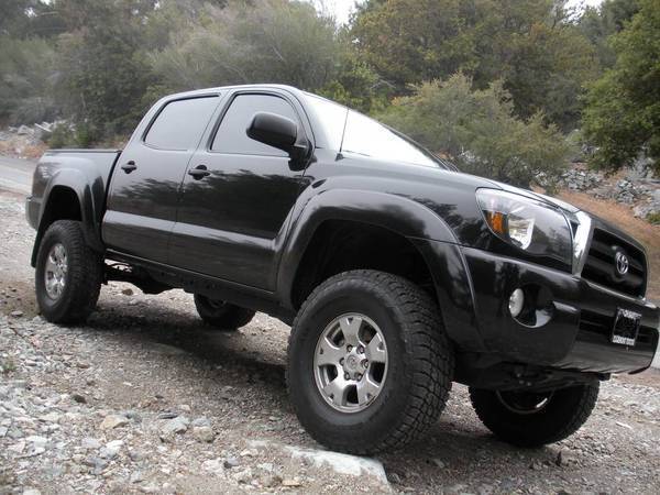

    x2 on the procomp as long as its the 3in shock lift not the spacer....if you shop around you can find a deal on it for around 300 shipped. I ran that setup for just over a year and I had no real issues with it. It was stiff but then again its a budget lift
    but just as everyone says if you are going to do it, do it right the first time.

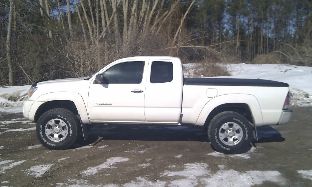

    I put a spacer lift in mine and to be honest with you it's ok. It aligned perfect and leveled my truck. Then I installed a winch and lost some of my front lift. I already have the Eibach springs and the plan is to pull the spacers out when my 5100's get here. I'm thinking about setting the shocks at 1.75 plus the 1.6 in the springs minus the 3/4 inch i lost after adding the winch should put me at around 2 and 1/2 inches in the front. Once I see how it looks I'll decide how much to lift the rear.This pic shows the spacer lift before the winch.
