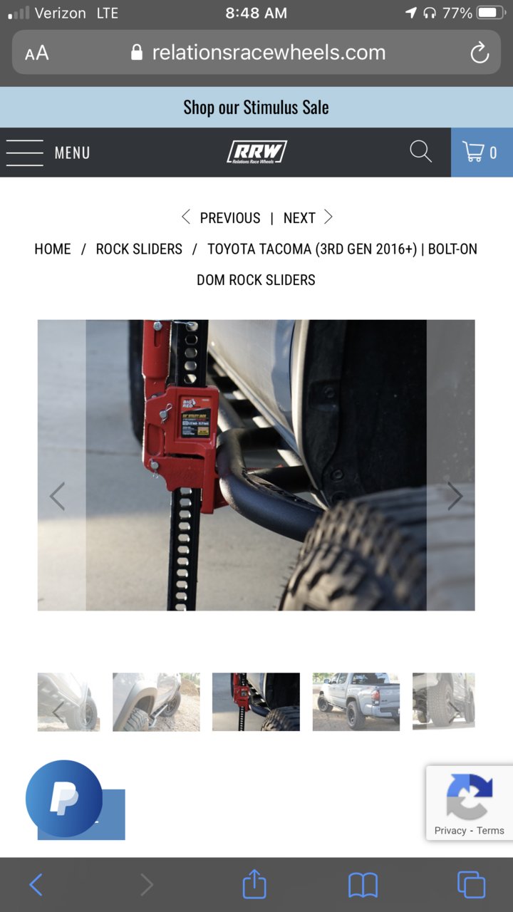

    The RelationsRaceWheels DOM Bolt-On Rock Sliders come with a full length option that will go all the way to the bed. You’ll have to look it up yourself since their website is blacklisted here for some reason

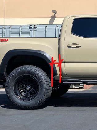

    He's talking about this gap
    Unfortunately, the frame goes up and over the axel in this area, so there's really no way for that rear portion of slider to be supported. Sure, they could make the slider longer to close the gap, but that unsupported tube can and will bend... into the body that it's trying to protect.
    Some companies try to brace this area... but even they don't have "full" coverage.
    I think most companies rely on the concept that usually, your back tire will encounter the obstacle and raise the body off of the slider, before it gets to that point...

    I think that space is so small that it would take a knife-edge rock to fit in there. Anything else your rear tire will contact before it leaves the slider. I think you guys might be over thinking it... But then again, I'm just some dude on an online forum! :D

    I would propose there are exactly 0 beds that have been “ripped off” due to that gap as OP suggested. If anything, there’d be a 500 page thread about it here on TW. Haha.

    Agreed. I've been here long enough to know it's a non-issue. Most people would have the forethought to stop driving forward, if they dropped their sliders onto a small narrow object, that could fit in that gap....
