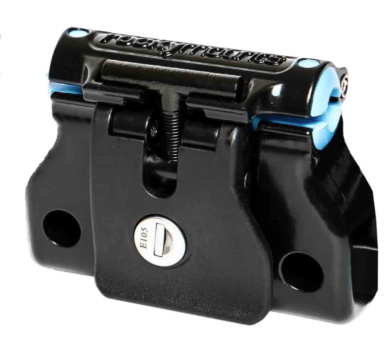

    So I prefer to mount the bikes more firmly. I love Rocky Mount Hot Rod Mounts.
    They are modular, so one single mount will work for pretty much every bike you may have, from traditional skewers found on road bikes and townies, to solid through axels on modern Mountain Bikes. They can be had for $42-some on Amazon.
    But how do I mount them to my bed rail you may ask? There are lots of things online that show people using washers and bolts and all crazy cheap-o methods to attach the mounts. I've done this and it can become super frustrating trying to hold the bolt still while tightening the nut, and finding washers that are big enough and strong enough to handle the tension. Plus, I had the washer/bolt method fail whilst carrying a heavy townie bike.
    But there is a better way, oh yes, there is a better way. 1018 T-Slot Nuts. These are designed to slide right into your existing bed rails, and thread into any standard 3/8"-16 bolt (very common).
    A pack of five will run you about $15.00 on Amazon
    So now for the fun part. Installation.
    The Rocky Mount Hot Rod Mounts need to have the holes re-drilled to accommodate the larger 3/8" bolt. And I like to use a flat washer and a lock washer to prevent the bolts from working themselves loose.
    Put everything together loose so you can slide the mount into your bed rails.
    Leave the silver adapter out of the Rocky Mount so you have room to tighten the bolts. But be careful not to overtighten the bolts. You don't want to crush the bed rail.
    Reinstall the adapter you need for your bike, And there you have it. No muss, no fuss.
    I then keep all the extra adapters and allen keys so I can swap adapters, or even loosen the t-bolts and relocate the Rocky Mounts as needed.
    Incidentally, many bikes will fit sideways if mounted near the tailgate, behind the wheel wells!

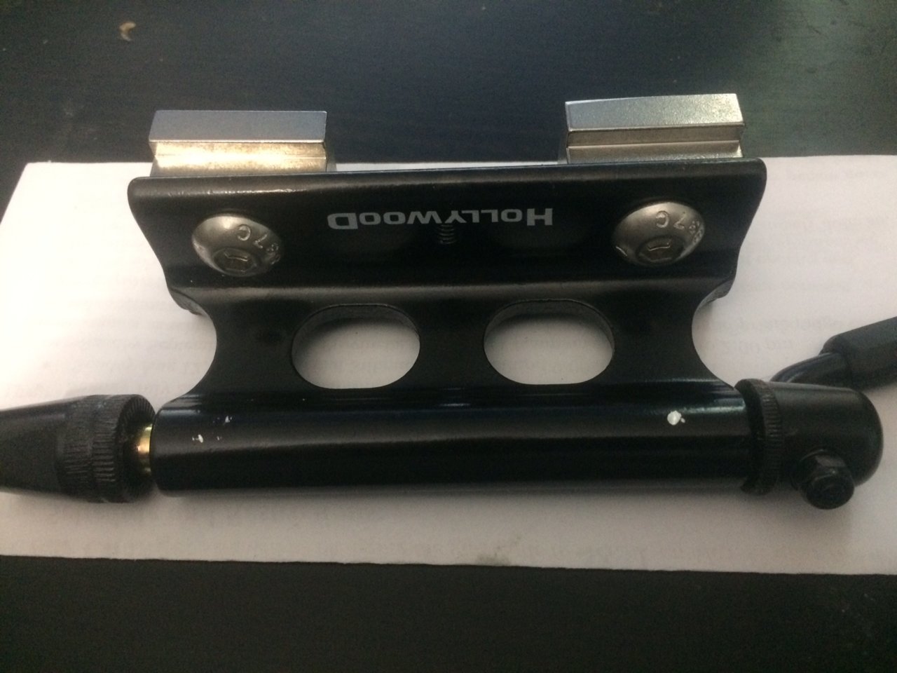

    If you only need to carry one size of thru-axle bike(s) the Kuat DirtBag is similar and much cheaper. No sleeves or adapters for old-style skewers or to fit a variety of thru-axles. That said, I probably would have got these Rocky Mounts if they'd been available then, because ... progress. I have at least seven 9mm skewer mounts that don't get much use anymore, and I'm sure there's Boost or a fattie in my future someday.

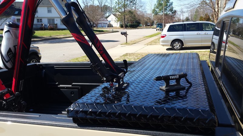

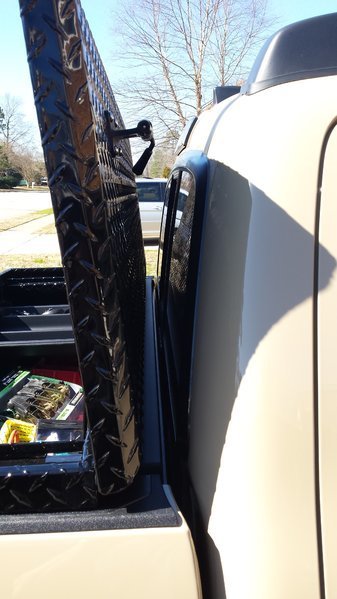

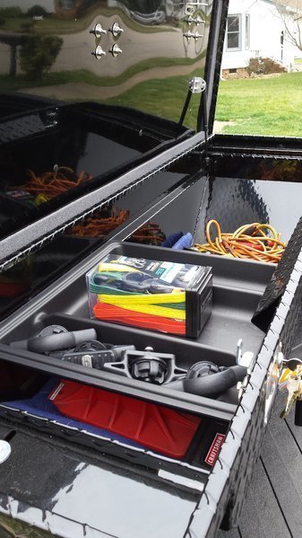

    My way includes storage.20160228_132746.jpg 20160228_133102.jpg 20160312_114117.jpg 20160724_094535.jpg 20170329_173606.jpg 20170329_173616.jpg
