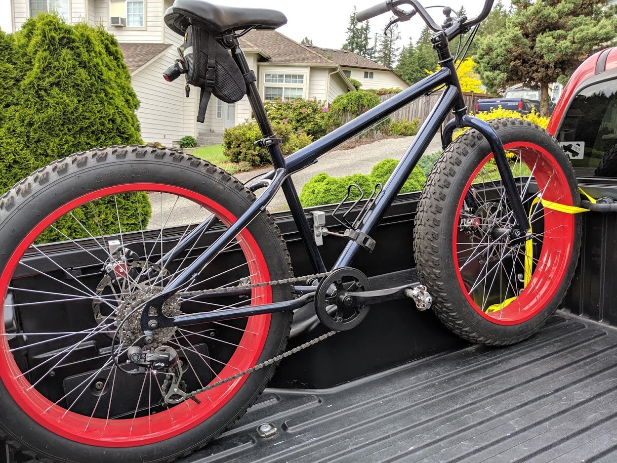

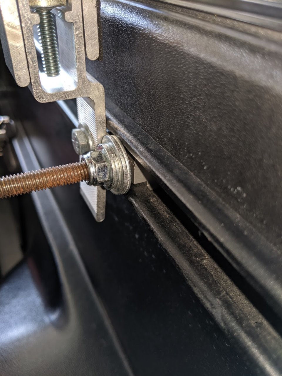

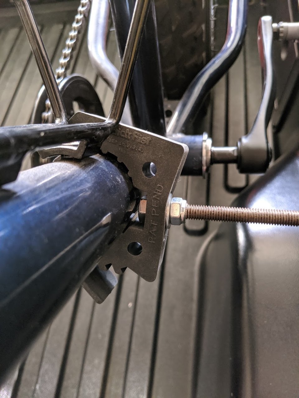

    Mine is a homemade version of the Inno mounts.
    Since this, I have brushed and painted the allthread and wrapped the QuickFist with self-bonding tape:

    Yeah, that bolt looks awfully close to banging against the frame when the truck hits any kind of bump in the road...

    Exactly. So like I said, I used some self bonding tape and wrapped that area. I might have also used a felt pad under the tape. Still, it was cheap to make, does the job, and no scratches.
