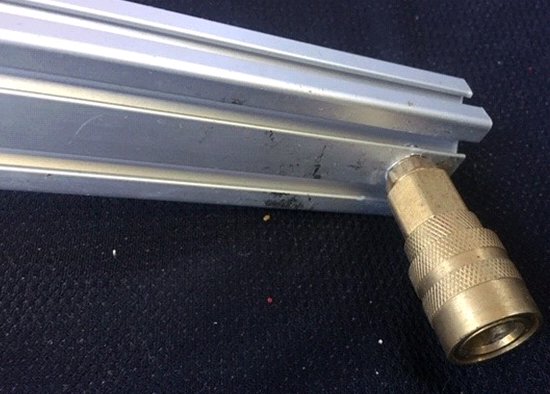

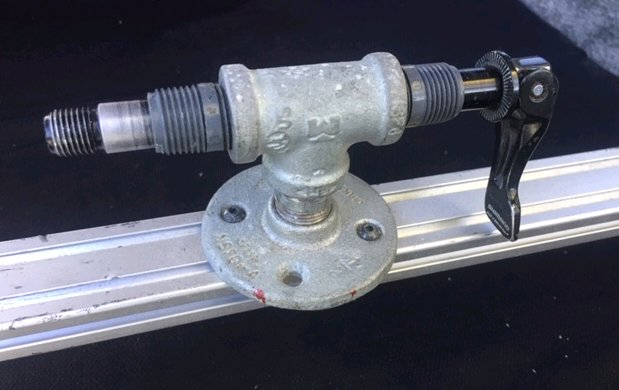

    FWIW I made a couple of these back when 15mm was a new standard and no pre-made options were out yet-- they work perfectly enough I have never needed to change them. 1/2" galvanized pipe and threaded PVC nipples, mounted onto a scrap piece of 80/20. The 80/20 quick releases to the sides of my carpet kit near the rear window using 1/2" brass quick release air compressor fittings which are press-fit into the aluminum. It only takes a few seconds to pop it in across the mattress to load up the bikes, and pops off in 2 seconds if you want to take it off and use the bed. 29'ers fit too since the shell is a high-rise 122.

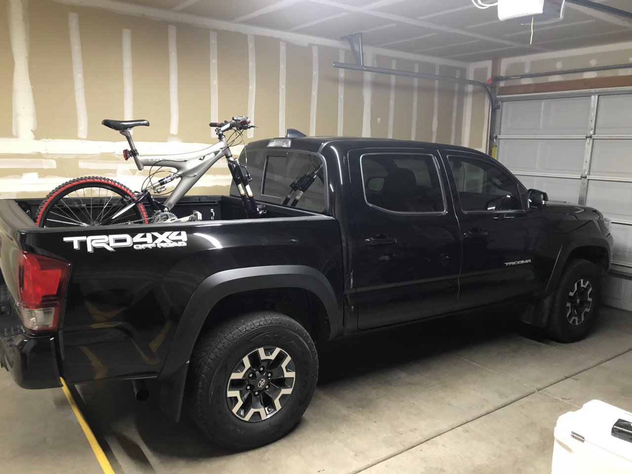

    I can't speak to the mount itself, but those angle brackets are on my truck. I put them on to lower the front of the bike so the handlebar gear wouldn't be in the weather.
    I've been using this setup for three years, often with multiple bikes, including two 40lb plus fat bikes mounted at the same time. I ride three to five times a week, and often down rough dirt roads. Obviously, I've had no problems and checked today, no signs of crackingor fatigue.

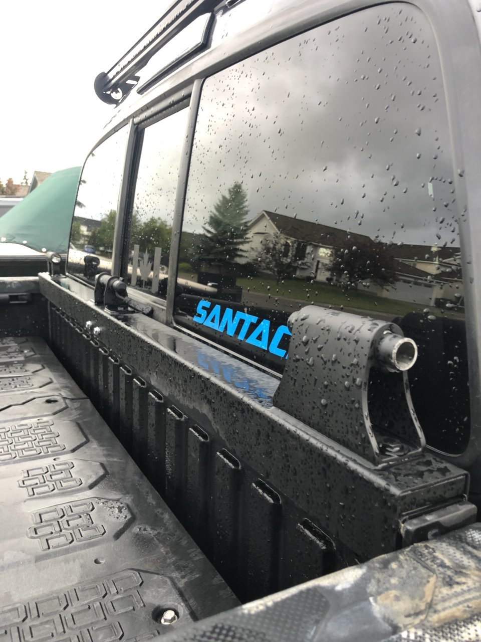

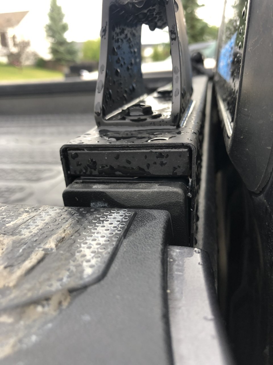

    Missed this reply earlier. See pic below. Reversing the rail cap does not reduce space between the cab and the back wall of the bed because the piece below the cap already sticks out more. This is a non issue.
    Gwlee seems to be too stubborn to do any sort of modification whatsoever. For everyone else, reversing the rail to be able to use the Rockymount works great.
    My only issue is not with the rail or the mount. My thru axle is tapered in the middle so the Rockymount clamp doesn't hold it 100% firmly. Need to get an axle that doesn't taper. Otherwise this setup has been perfect.

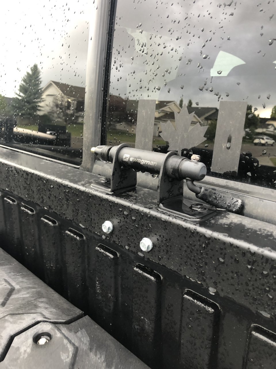

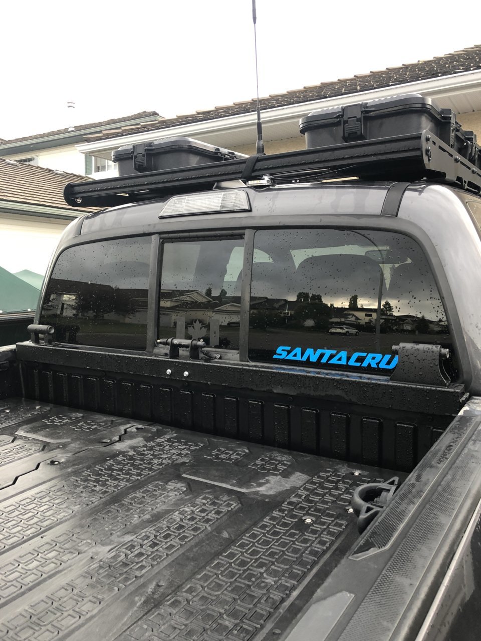

    7E338973-B0E5-449E-907B-B82C67562AD8.jpg 23735BBB-7527-455D-B0AE-37DA659A3ABC.jpg I made a thing the other day. Had a metal shop cut n bend, then I welded on the 1/2x1/2 bar for spacers. The silver bolts hold it into place but it rests on the bed rail for support. I can pull it off easily and use it on a Prinsu rack or my cage on the trailer. 3 diff style of fork mounts for the three bikes we usually take. Cost me about 20$ (without mounts).
    F002351C-C982-4CB3-8203-F31D68FB1066.jpg 2A1B9C6A-55A2-4510-A11F-8E9BAFDD99C0.jpg F002351C-C982-4CB3-8203-F31D68FB1066.jpg

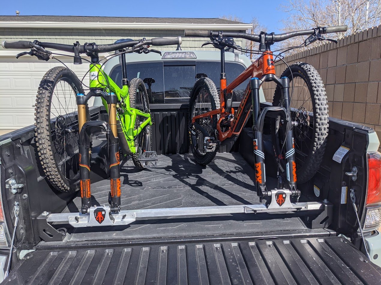

    Yes. The two outboard bikes would need to slide all the way to the outside.
    But also, I've modified my setup. It now looks like this. I got tired of climbing into the bed.
    Also, I worked with a local machinist @TMCmakes do alpha and beta testing on the Wheel Deal - the thing that holds the wheels onto the bed rail. The thread on those is here: https://www.tacomaworld.com/threads/mtb-wheel-hauler-contest-name-this-thing.711725/
