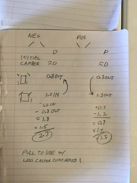

    Here were my first measurements:
    A little explanation on those numbers: when one's negative and the other is positive (i.e. one's IN and the other's OUT) you add them together. But when they're both the same (e.g. both OUT - which is weird) you subtract the one from the other. (It's even possible to have negative caster) That's why 1.0 and 0.8 yields 1.8, while 0.3 and 1.2 yields 0.9. It's not an arithmetic error.
    Using the HF angle gauge, Whenever I'd measure, then remove the angle finder and bring it back and re-measure, I'd find that it was only good for +/- 0.2 degrees or so. There was that much "variance" in the measurements. So I never bothered to try and make any adjustment that was less than 0.3
    Initial Measurements:
    Both driver/passenger Camber within 0.2 of zero.
    Driver Caster 2.7 - credit to George.
    Passenger Caster: 1.3 (!)
    OK, with a 1.4 cross caster, it became clear why the truck pulls to the right.
    See: http://www.aa1car.com/library/tr295.htm and other sources but "A greater [caster] difference side-to-side can make the vehicle lead towards the side with the least caster." Yep, bingo.

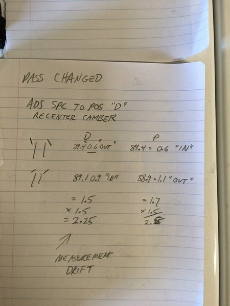

    So, how come there's more on the driver side than the passenger? I checked the factory eccentrics: both where I last left them, set for absolute max caster. Now, on the DRIVER side, George has actually set the SPC control arm to the full neutral position: Position "G." That's weird - but we don't need any more caster over there.
    But on the passenger side, it's still clearly where I set it back when I installed the arms and did that first alignment: Position "E"
    (See the SPC sheet to review what those mean: http://www.spcalignment.com/instructions/25480-INS_WEB.pdf)
    At this point, the only thing to do was to bump up passenger caster, and the only WAY to do it was to restore the passenger side SPC control arm back to "factory default" position "D." I couldn't budge the top nut. My trusty 15" crescent wrench failed me. I had to run to the autoparts store for a 1.25" socket and can of PB blaster. That (and a cheater bar) cracked it open, and with the truck jacked up to unweight the wheels, I was able to reset Position "D" and then mostly zero out passenger side camber. My final measurement was 0.3 degrees "OUT" or positive camber. But like I said, I wasn't bothering to correct anything within the +/- wander of the HF angle gauge. So at 0.3 it remains.
    But when I swung the caster, the result was epic:
    Re-measure of driver side caster went down to 2.3, but passenger side was up to 2.6 !
    One of the shortcuts I discovered about measuring caster was that 20 degrees off center was *EXACTLY* one full turn of the steering wheel. So after the first cut with angles and sheets of wood and lines on the floor - I took all subsequent caster measurements by simply turning the wheel two full turns back to top-dead-center.
    The control arm adjustment created a *BIG* change in toe - I was now toe-out by an INCH and a HALF. (!) So I burned the rest of the afternoon measuring and adjusting toe, then driving the truck and tweaking the adjustment to get the steering wheel as close as possible back to dead-on-center. Jason uses paint to highlight a "nail line" on the tire. I found a strip of 2" painters masking tape wound around the tire worked just great.
    Lessons learned:
    1. If you have any aptitude for angles and math - don't be afraid to do your own alignment. You don't need an alignment rack but you DO need a FLAT garage floor. But alignment techs just want to get the job done and move on to the next paying job. And they typically don't understand the finer points of adjusting SPC control arms - even if they do understand the caster/camber eccentrics. (And not all of them understand even that.)
    2. Trucks aren't as straight as you think. All else equal - I ended up with one control arm at the ZERO factory neutral position, and the other at +2. :eek:
