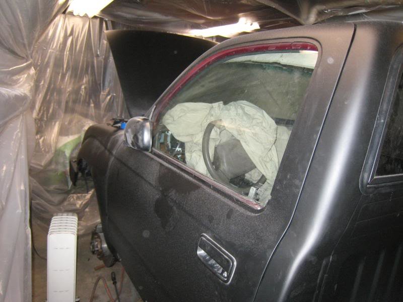

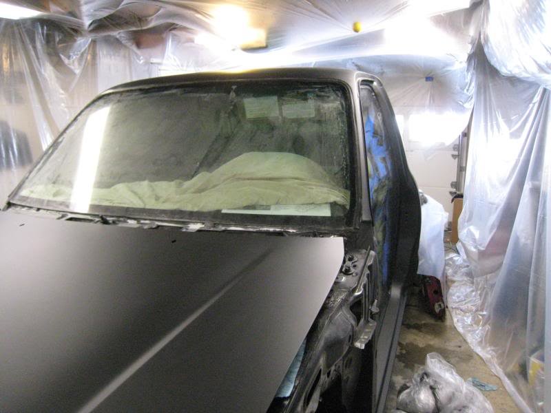

    ***Update*** Cab is now flat black, along with the hood and fenders. :D Once the paint dries and the overspray clears out, I will snap some pics and update this post. :D

    man... the flat black came out fvcking awesome.... I can't wait to get pics of this bad bitch back together... :D

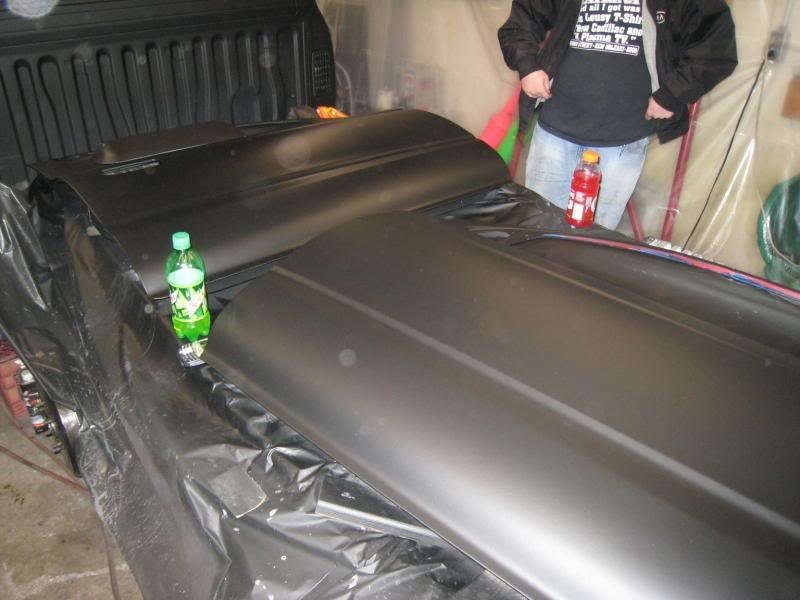

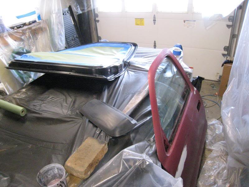

    I am a school teacher, and lucky for me the snow got school cancelled Monday and Tuesday, so I was able to get more done. We painted the doors Sunday, but for whatever reason the primer bled through. Grey primer on black & maroon doors just didn't work... so we sanded them down Monday and painted them again. :D
    By Monday night we were ready to hang the doors back on the truck... So we tore off all the masking tape, paper and plastic.
    I got doors again.... :D

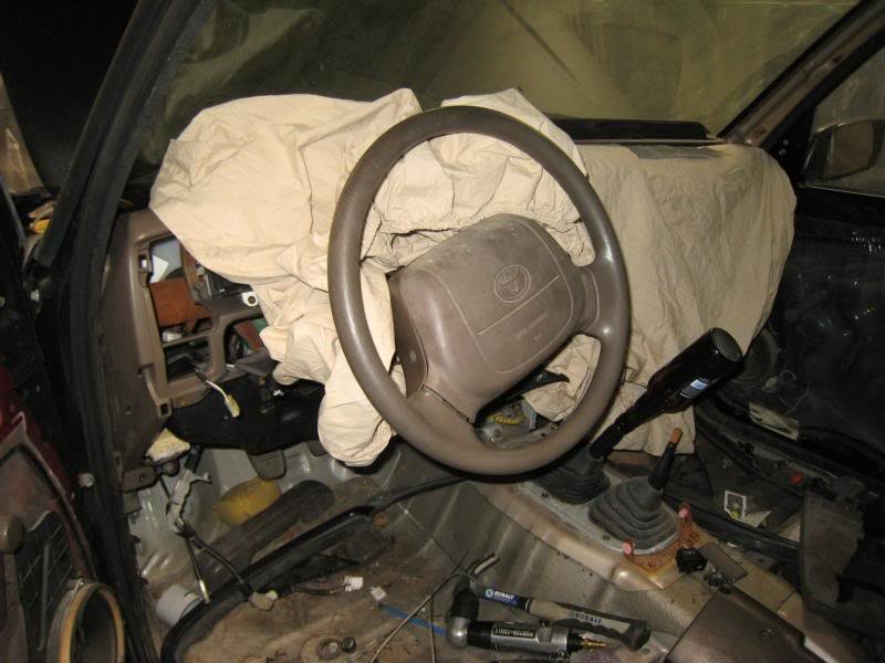

    Then Tuesday I took off to the Junk Yard. I now have 95% of the parts I need to finish the truck... I was not sure how everything went together on the steering column so I took the entire thing... :D I needed matching locks for the truck, and one at the yard had tan/brown interior. Turns out, after beating the shit out of the security bolts for the ignition on my column and the new one... I didn't have to. :D I had no idea there was a release pin to get just the ignition switch out... So that was a waste of $50 but more than just the $50 the time... the tilt column out of a 98+ will NOT work in the 97... the wiring harness is all different.
    I gutted all the airbag and mounts out of the new column and swapped it over to my original column. Pain in the ass... wasted a couple hours messing with it when in the end I realized it just wasn't going to work... And it could had taken me 20 minutes had I known it wasn't going to work.
    But now I have an airbag... oh yeah... and I have the fender on the driver side of my truck now. :D along with mirrors, door seals, working door latches...
    Aside from time... the only parts I can think of that I need are the Brown Glove Box door, Driver side interior Cab corner trim panel and a freaking antenna.
    I even got me a clock at the junkyard... :D

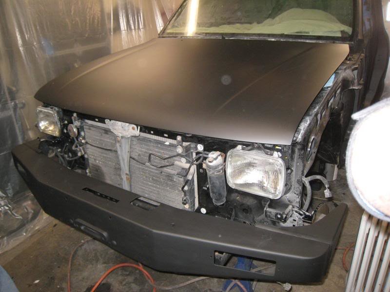

    I had a short break from work today, so I got the passenger fender on, and the grill, readjusted the hood and fenders in attempts to get the gaps lined up better. :D
