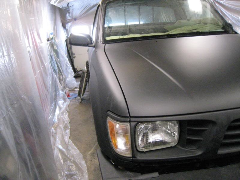

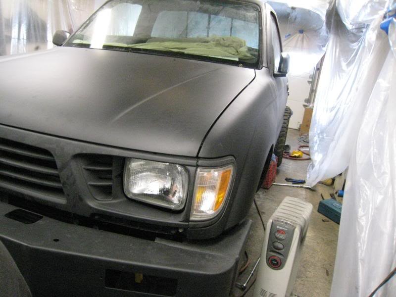

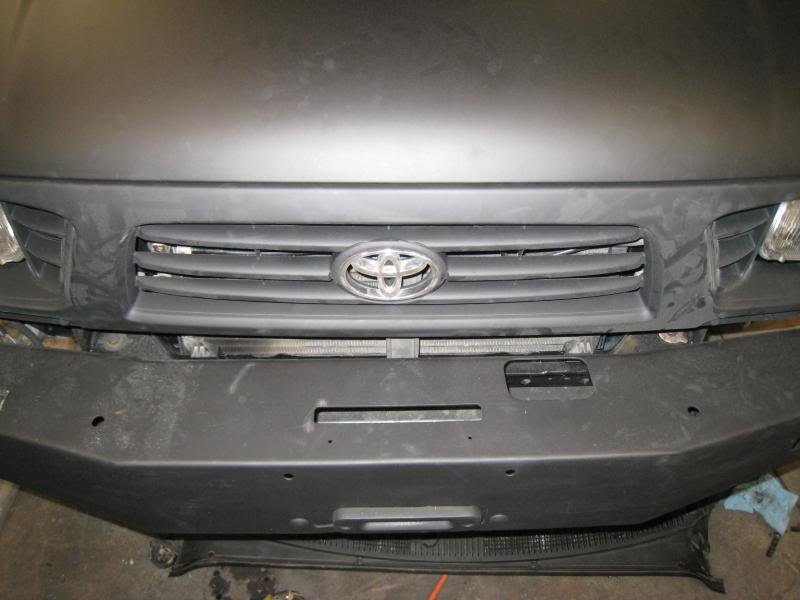

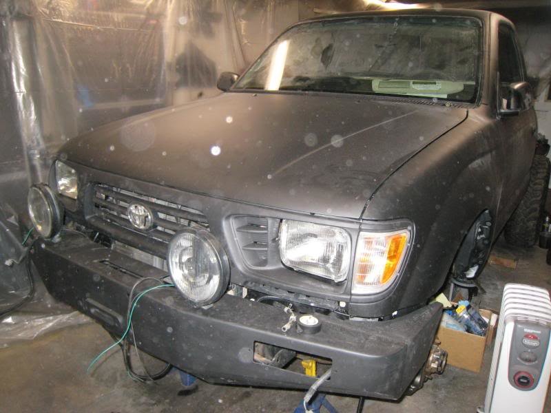

    OK, Tacoma Picture time... I only have a few.
    Here is what I have for now. The last pic somehow ended up with spots all over it, and I am not sure why...

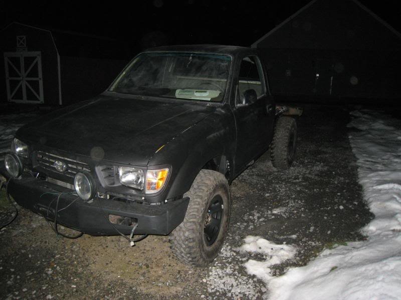

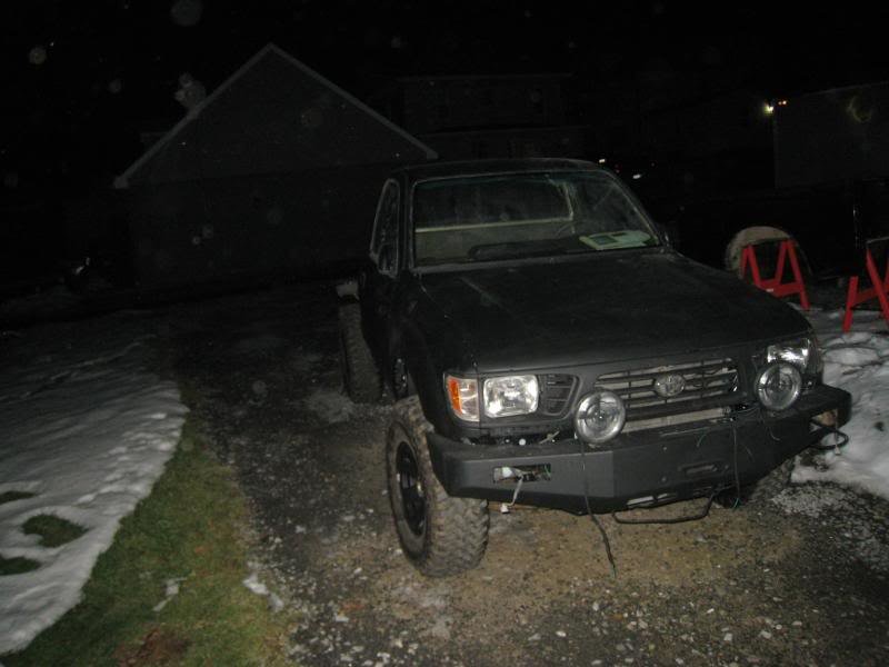

    Hey look.... It's outside... and I didn't have to push it.... :D
    The only problem is it won't stay running... I have about 5-8 seconds each start...

    progress has slowed... turns out the frame is bent, so I gotta get it on a frame machine. also... the fuel pump will not stay running while the key is in the "ON" position. Tracked it back to the computer, the tire that is supposed to ground the EFI relay is not grounding by the computer. Once the new computer gets here and I can get it running on its own... then its off to the frame machine.
