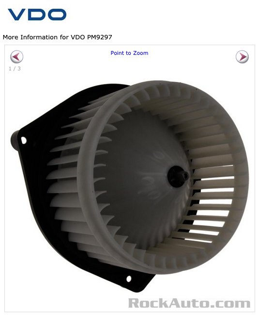

    Hi Folks
    My 2nd gen Tacoma blower motor is making some chirping noises. As many threads indicate, you can go in, clean out the brushes and those pad things, and you can turn the screws on the assembly to adjust how the rotor sits in the stator to remove chips and stuff. The short story is that the adjustments did not address the issue, and the entire blower motor assembly is not that much to replace, so I started on my journey to replace it.
    The first thing to mention is that the OE part from Toyota is like $150, which is not that much. However, you can buy one from RockAuto for $29. So I bought one.
    It was loud, not chirpy, but the sounds of a loud motor are annoying to me. The $29 blower motor, which was loud, was ULTRA-POWER 700188, from Rock Auto. I am sure it would be fine for some drivers, but for me, it was too bothersome.
    I returned it yesterday and await the arrival of the replacement, a VDO PM9297, also from Rock Auto. That one costs $50.
    If I install that one and it is also unusually loud compared to the OEM Delphi blower motor, I will return it and buy the Toyota OE blower motor.
    Please feel free to reply to this thread with your own attempts to replace the blower motor. Descriptions of sound and long-term use are especially welcome. I wish that this thread existed before I bought that cheap-o ULTRA-POWER unit for $29!
    Cheers,

    The VDO blower motor sold by Rock Auto also sucked. Sounded noisy. Returned it. Bought a Toyota OE one from the dealer for $140
  8. Jan 24, 2020 at 7:43 AM
    Reinhardtius
    Reinhardtius [OP] Well-Known Member
    Mar 24, 2019
    #287813
    222
    07 Base 2.7L 5SP
    Moral of the story: you'll likely be sorry with anything that is not OEM when it comes to blower motors.
