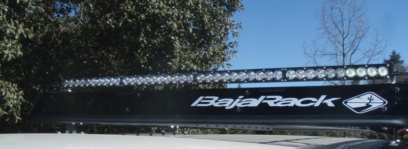

    ya ive heard the glare can be gnarly. I'm considering one of these. i think they will help reduce glare. problem is they cost MUCHO $$$. whatever i use i plan on mounting them at or behind the roof rack mounting points

    I would highly recommend it. It kind of ticks me off that I didn't plan for that type of thing. With the glare being what it is I can't really use the rack lights at the moment. But I'll eventually get around to finding a fix when I get a freakin' weekend off..:rolleyes:
