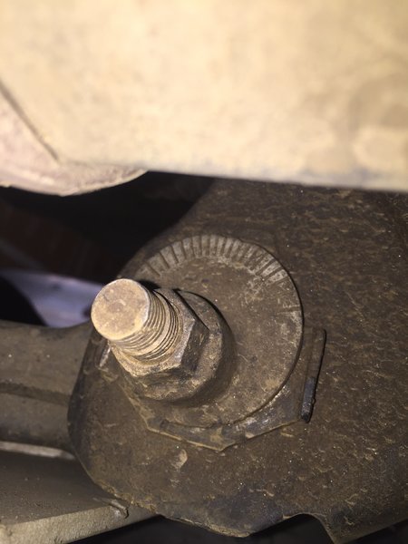

    How did you bend them wheeling? Typically that happens during an alignment.

    Slammed into a pretty big rock. Looks like it pulled the LCA backwards a little

    Gotcha. I looked at it again and see the rock it. I have a TC cam kit for sale if you want to go that far in making sure your cam adjustments stay intact.

    I'm not familiar with that. All I can find online is "cam tab gussets". Is that what you were talking about?

    Yeah. It's a kit from TC that replaces the factory cam tabs.

    It looks like a pretty tedious process to install them but they definitely look durable. Why are you getting rid of them?

    Because you can accomplish pretty much the same thing by hammering/bending the stock tabs back to square and putting a bead of weld behind them?

    Because of said tedious process. I just don't want to get into it that much.
    That gonna be good enough for me.

    That's all I was planning on doing once I can find someone to do it
