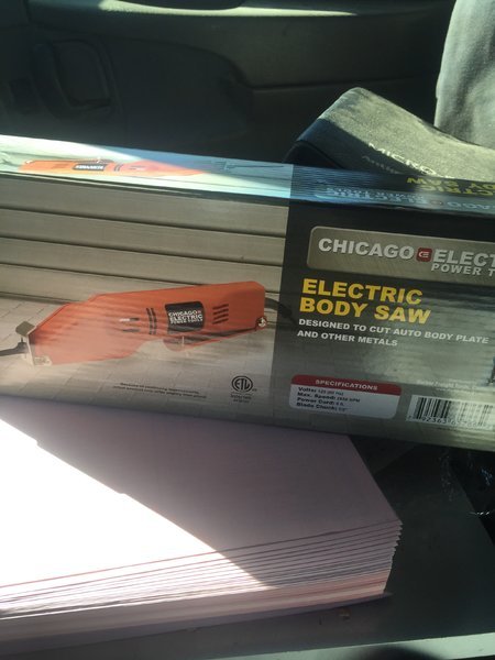

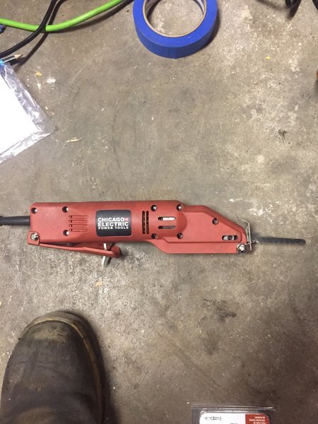

    It should speed up the fender trim a little bit!

    I plan on using it for my fender trim and then returning it :devil:

    Post up how well it handles the job please, although that place needs no more of my money lol
    :anonymous:
    They have a jig saw on sale too

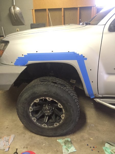

    Now I just need to think of a quick and easy way to make a body line tool. Maybe just use a piece of cardboard or something like that?
    ChadsPride likes this.
  5. Sep 9, 2016 at 11:35 AM
    #2245
    Impulse05Taco
    Impulse05Taco Well-Known Member
    Jun 29, 2012
    #81603
    166
    Colorado
    05 Tacoma V6 TRD Offroad
    I plan to use one of these, I'm just going to pull the flares then set it to 2.5" and follow the metal inner fender edge. The pencil will leave a line on the masking tape and then follow the line to make my cut. Would do the same on the flares themselves only at 2 1/4" to leave a little overlap to hide inner edge. Not sure if this is what you meant though by body line tool.

    Yeah, that would probably be good enough for what I'm doing. Some of the ones that I have been our triangle shaped and make sure that you stay EXACTLY at 2 inches, but a metal compas like that will probably be accurate enough for my needs

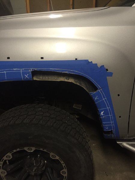

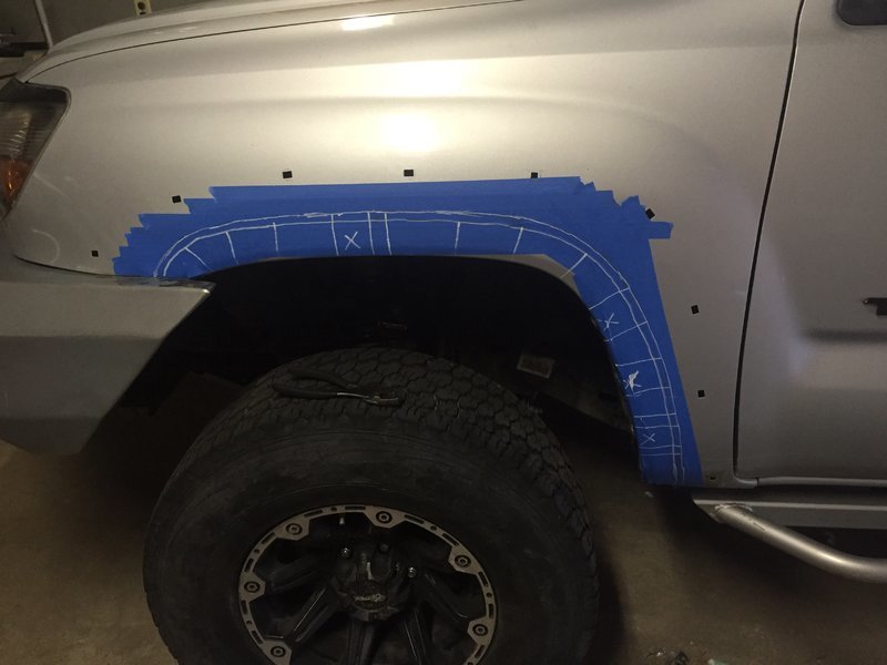

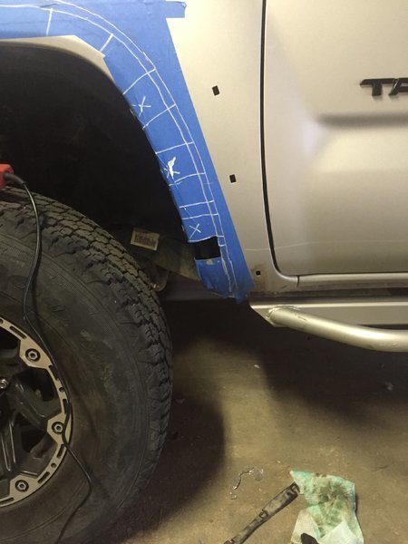

    I'm in the process of doing it right now, and it is very very stressful

    The first cut is alway the hardest... My poor truck, I'm butchering it :(

    Why are you cutting it out in chunks radially instead of cutting around the perimeter of the fender? I'd never have thought to do it that way.

    The little chunks that you see with the X on them I am not cutting off. That way I can fold them and screw them to the body to keep the fender from flapping around

    This is a piece of junk, I do not recommend it at all

    You got the wrong one!
